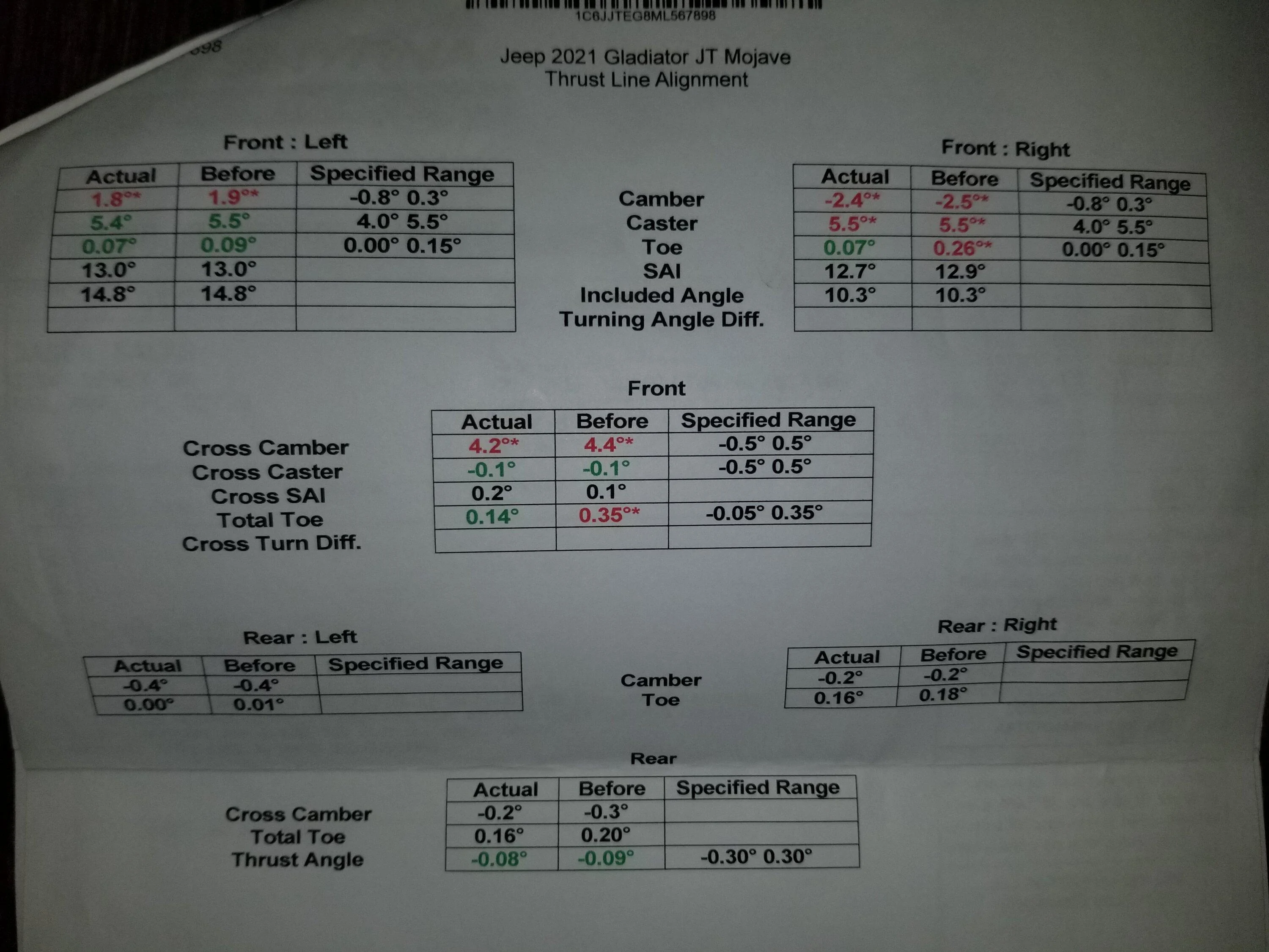

Hey bud, got home and dug up the alignment results from the dealer ... tbh not sure what I'm looking at lol ... any thoughts if these #,s look correct?
These are the changes made prior to alignment
-TF 1.5 level kit up front ..
-Daystar 3/4 in the rear .
-Mopar LCAs
-35x12.5x17
-Fox ATS steering stabilizer..

If your toe readings are right then they’re fine. But id verify them. I never got a printout and just trusted mine was good when the shop said it was. Until i re checked and adjusted my self.
you’re caster looks great.
Im no expert but im fairly certain we can’t set or alter our camber without new wheels maybe? so not sure why thats out of spec.
