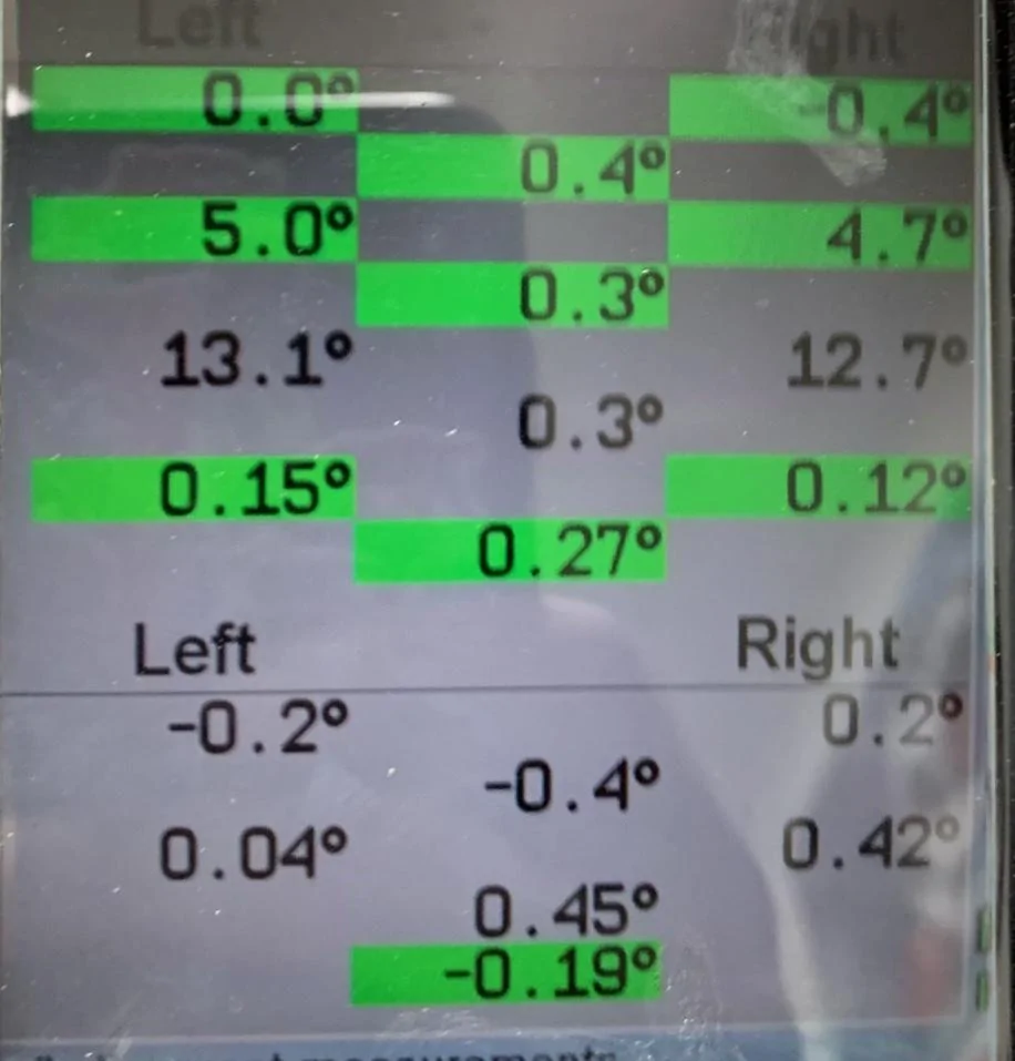

found one of his texts with the alignmen. This was from one shop post alignment. I know he took it elsewhere after and while it’s been measured it has not been realigned after Something seems off from those reading. I know the one shop I went with him it read in the 5s
Thoughts
