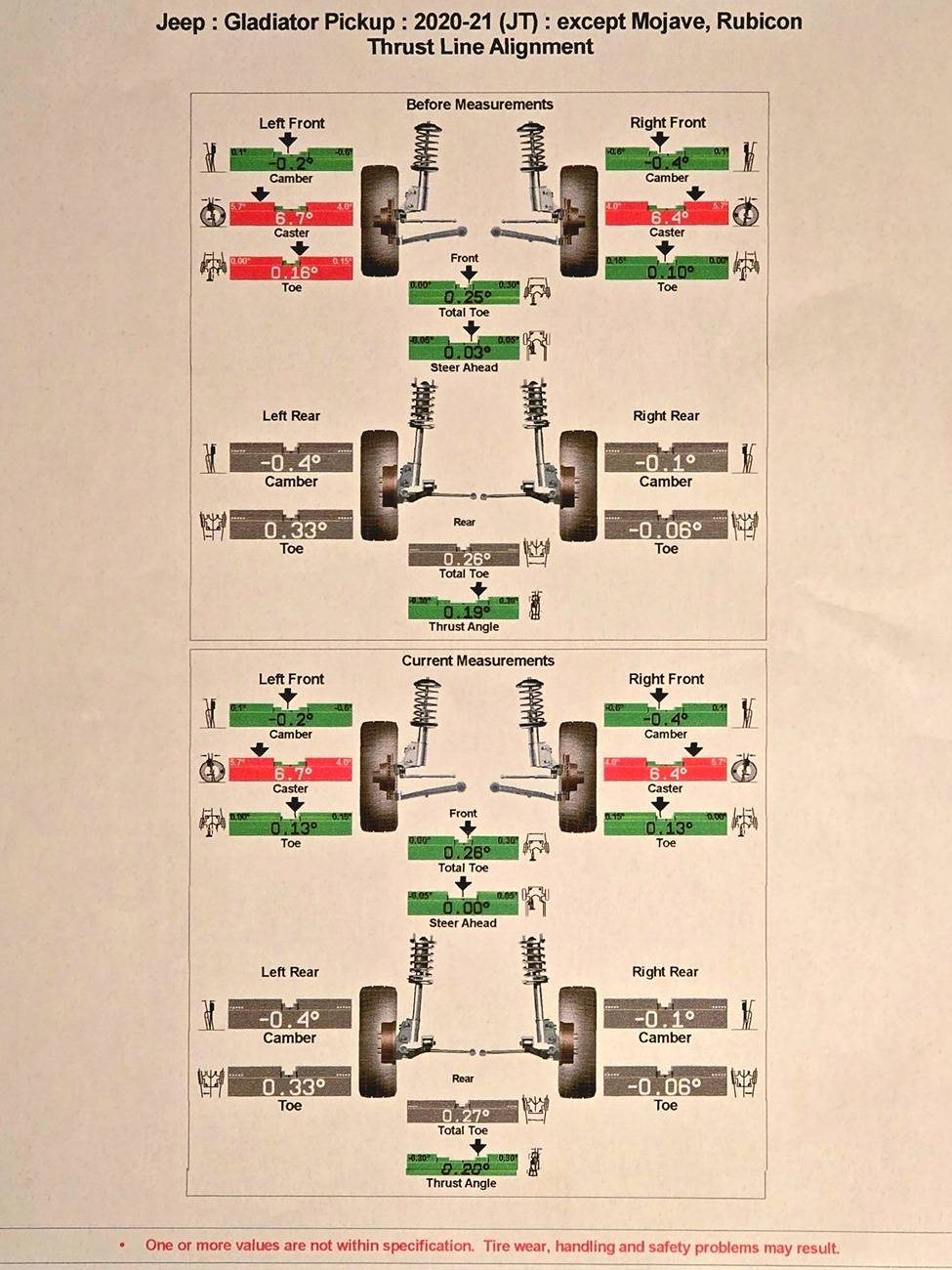

I have a '23 Sport S Eco D and upgraded the LCAs with ones from the Mopar lift kit to increase caster. Immediately, I noticed a pull to the right. I then proceeded to install 1" coil spacers, Bilstein shocks and steering dampener. I also retorqued the lower control arms again with the truck on the ground, but it still pulls to the right. This is with new tires with less than 500 miles on them.
I took the truck to a shop for alignment, and they noted that the caster is 0.3 degrees less on the passenger side, potentially causing the right pull. Ideally, they said that the right side should have 0.5 to 1.0 degrees more caster than the left to accommodate road crown. However, I think I would prefer them to be equal anyway. They suggested I could find offset ball joints online to correct this, although the truck only has 25K miles and no accident history.
Possible solutions:
1) I installed the driver-side LCA first and wonder if there's some play when tightening them down. Could I use ratchet straps to pull the driver side in slightly and then torque it down to correct this?
Or
2) It's possible the Mopar 2" lift kit LCAs may have different lengths (due to tolerances). Switching the driver-side LCA with the passenger side might correct the issue.
What do you think? Would I be wasting time with these solutions, or do you have other ideas? Please see the attached alignment sheet.

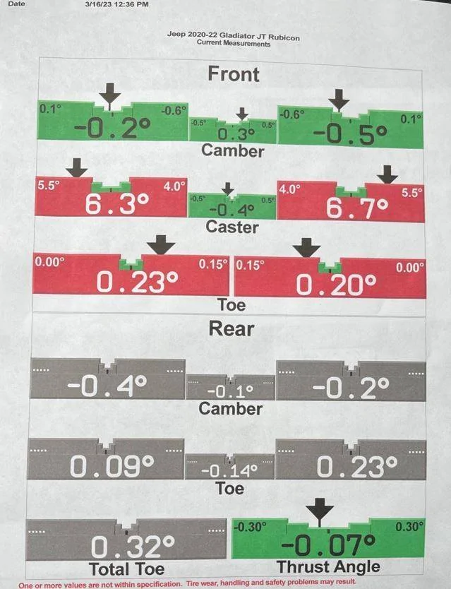

My first thought was caster. Attached is my alignment after installing the Mopar lift arms and my caster is reversed and it drove great. I was instructed to install and torque them down with the front wheels on the ground and that's how I did mine. It has been a couple of years since I installed them but I believe the part numbers were identical. Swapping them side to side may help but they should definitely be tightened down with weight on them
