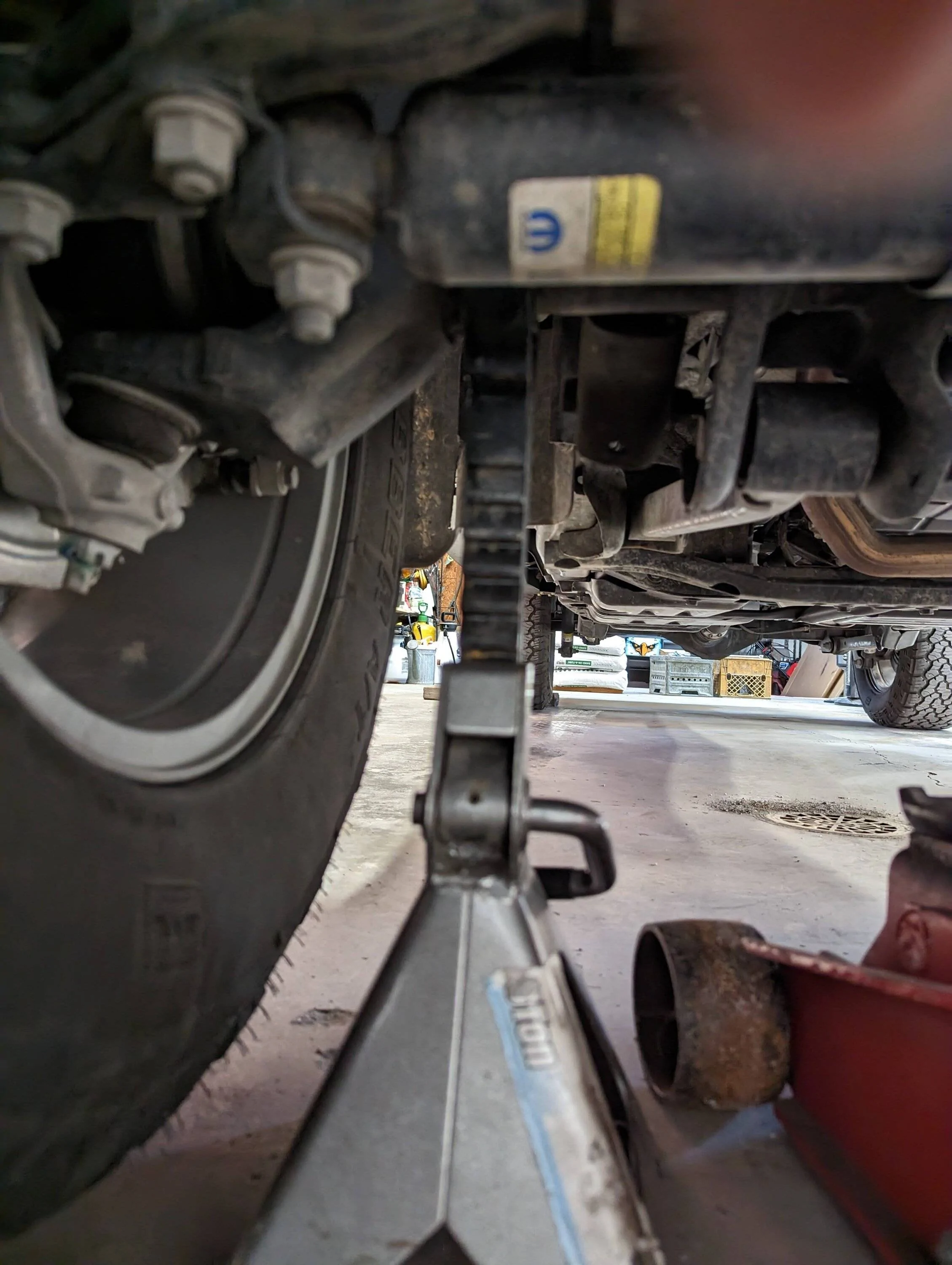

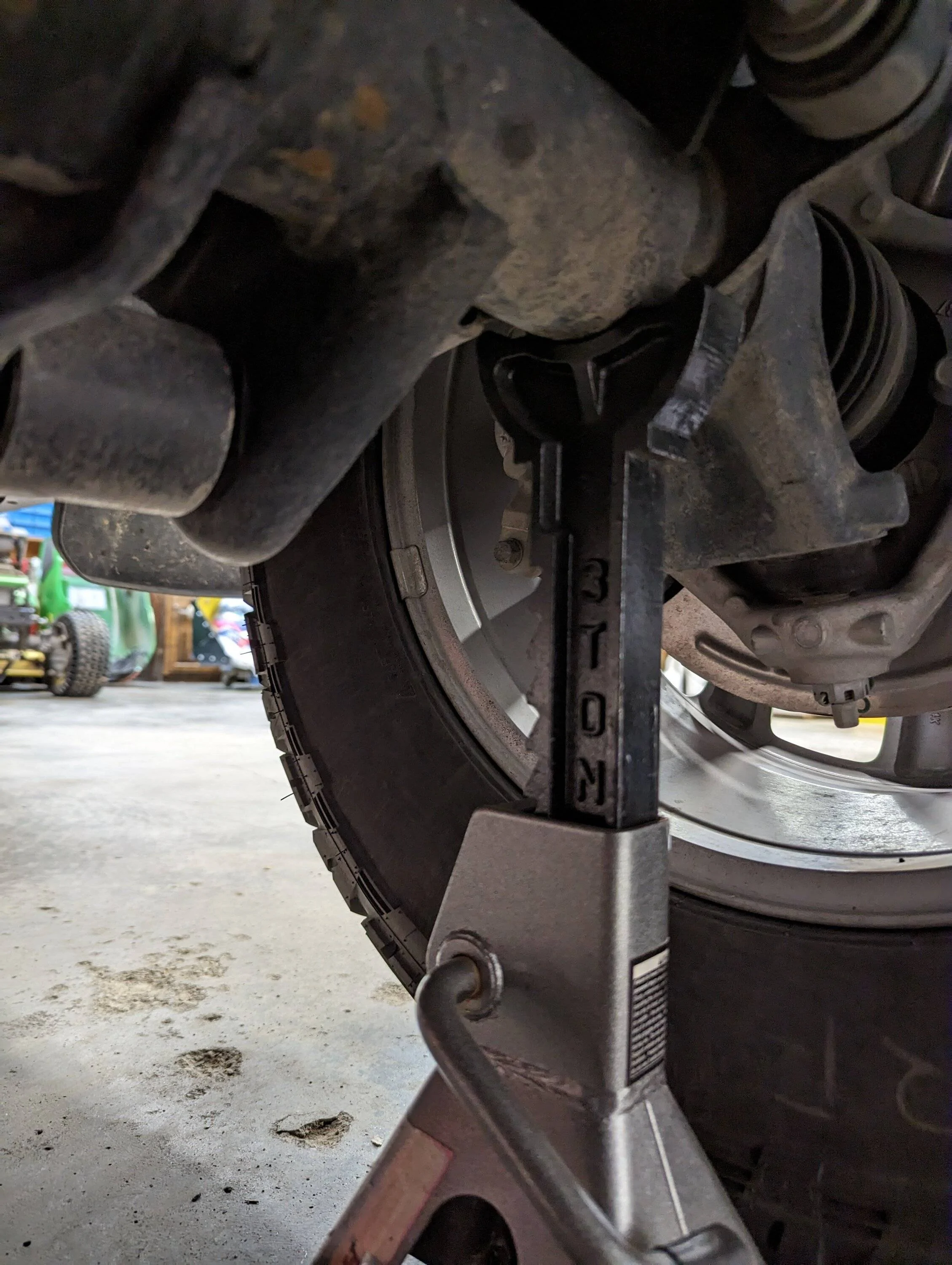

Besides, I know it's the same. Why? Because I just proved it - you can look around the forum as I am sure I've posted the numbers from after my last spring swap.
The truck settled to about 22.75" to 22.625" depending on fuel, whether or not I jounce the front by shoving down on the front bumper a few times, or whatever, but it's almost always in that range.
So, I put it on stands - just the front.
I made sure the stands were on a semi-level part of the garage floor (it slopes for drainage, but not toward the drain these days LOL)
A stand under each end of the front axle, with the exact same number of "notches" showing on each end.
I then measured from the center of each hub to the fender flare to the exact same place on the black trim that I always measure to and guess what I got........ yeah, the same numbers as above.
I let it down again - took it off the stands, jounced it again, and measured again. Within 1/8" of the original measurements. And that 1/8" can be just how the thing settles. Jounce it again and it might be almost 1/8" different.
Anyway, 22.75" with tires on the floor, 22.75" with axle on the stands (oh, I did jounce it once I got it on the stands!)
Left side - count the notches -
Right side - count the notches - (so the axle was supported evenly on each end)
So why did I do this? Because it took a whopping 5 minutes. And I could have done the rear in less time as I can jack it up more in the center and slip stands under it in less time.
So in less than 10 minutes, you can have more room to work and tighten those bolts to specs.
At 200 pounds (mostly belly, it used to be shoulders and upper arm muscles but those days are gone. I could lift an engine block onto my bench - a cast iron engine block and lower a transmission without a jack) and with arthritis, and having had my left bicep reattached to the bone a few years ago, I can no longer kill grizzly bears with my bare hands and need a bit more space to work.
Jacks well placed under the front will get you where you need to be for torquing those bolts and if you feel that it's off by .125" then raise the rear a bit. But if you don't lift the front end 6", there won't be appreciable weight shift to mess things up. It's weight shift that's the one and only reason the suspension could be compressed or RELAXED if you raise the front only. The weight shifts to the rear of the truck lightening up the front a bit. The higher you lift the front only, the more weight shifts to the rear causing the front to be lighter. Raise it just enough, and the weight shift is minimal. Like in my example above - it didn't change my measurements at all. And if you are concerned about 1/8" - keep in mind things settle, or relax, at least that much depending on the fuel you have or your own weight in the truck. So don't get crazed over .125"
Bill, were the tires still on the ground when you did this?
Yes. Weight of the truck on the tires - which were on the floor.
I should take a couple of pictures of how I did it........... It's really easy doing it standing up.
