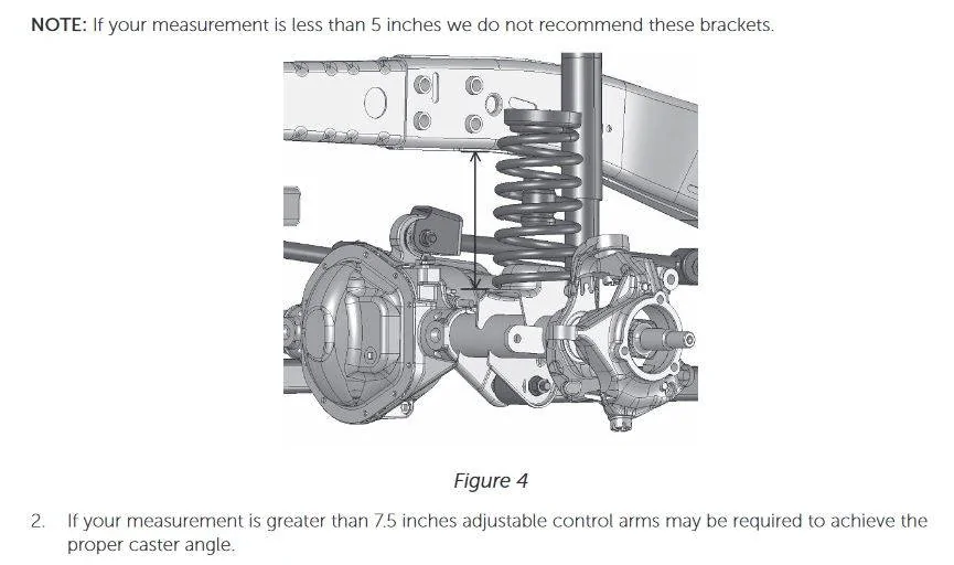

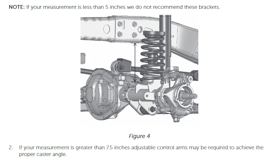

Geo brackets usually have a minimum lift height requirement for them (AEV has you measure from spring perch to frame distance. That being said, i'm at the very low end of the requirement and mine seem to also be angled down, just slightly, like yours. I've experienced no ill effects from it. Ride on!
Jeep Gladiator Front lower control arms bracket
Jeep Gladiator Front lower control arms 1699451708243
