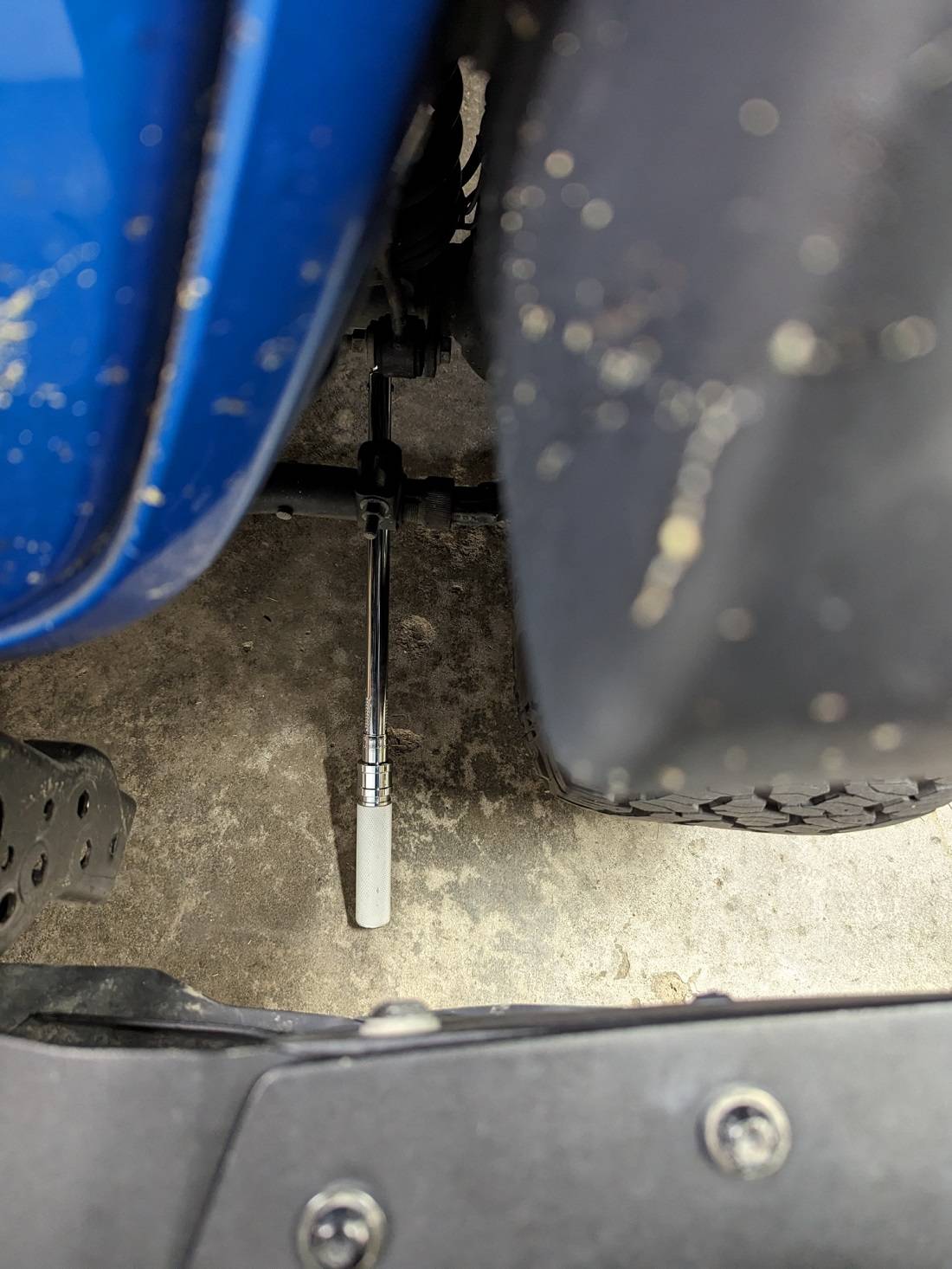

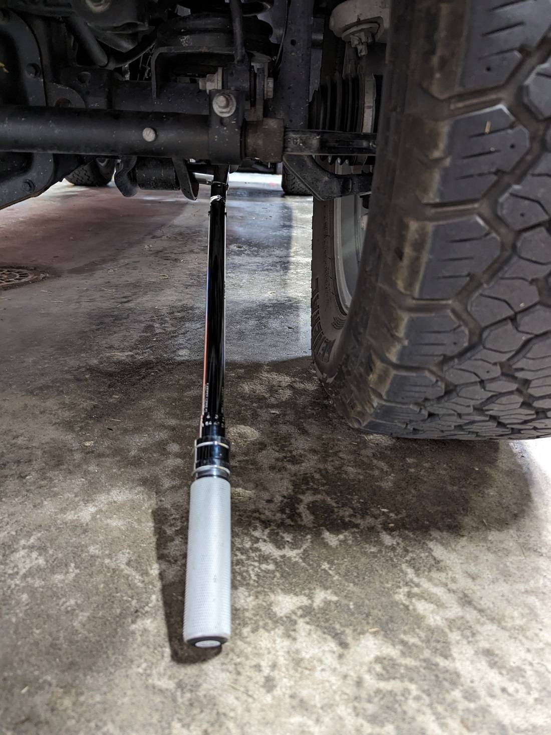

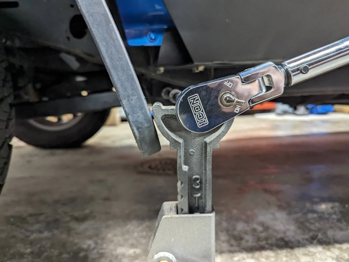

I'm not sure still why torquing the front lower control arm to frame bolt is a big deal. It's easy.
The uppers are pain in the back side, the lowers are simple.
front lower control arm rear bolt to frame - wrench on the nut on the other side so it will stop against the chassis, then this setup for the torque wrench and socket on the bolt head. Make sure it's STRAIGHT OUT both horizontally and vertically - a straight shot to the bolt, and it will be fine.
Jeep Gladiator Torque Front lower control arm PXL_20230825_025230625
Jeep Gladiator Torque Front lower control arm PXL_20230825_025239429
Jeep Gladiator Torque Front lower control arm PXL_20230825_025248831

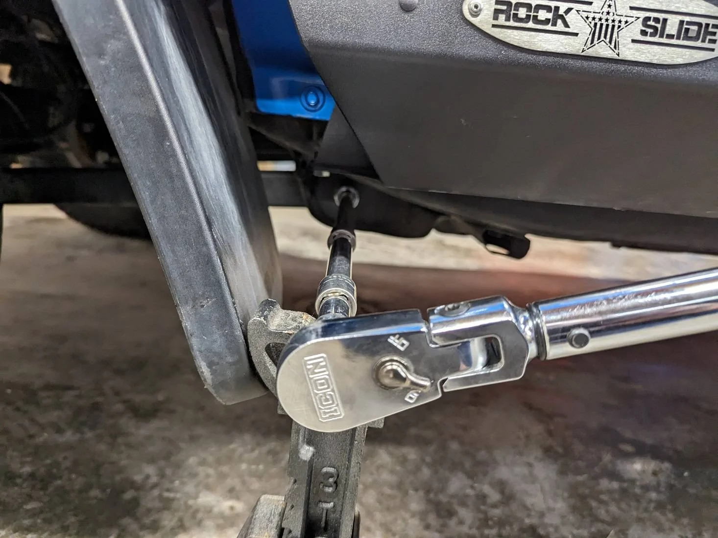

The LCA bolt to axle is a bit more of a trick, IMO. It takes time and patience -
Jeep Gladiator Torque Front lower control arm PXL_20230825_025417550

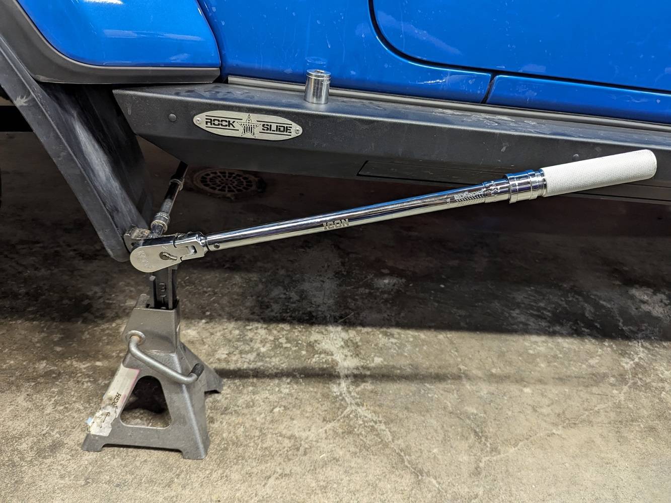

Would be easier if the bumper wasn't in the way -
Jeep Gladiator Torque Front lower control arm PXL_20230825_025428863
