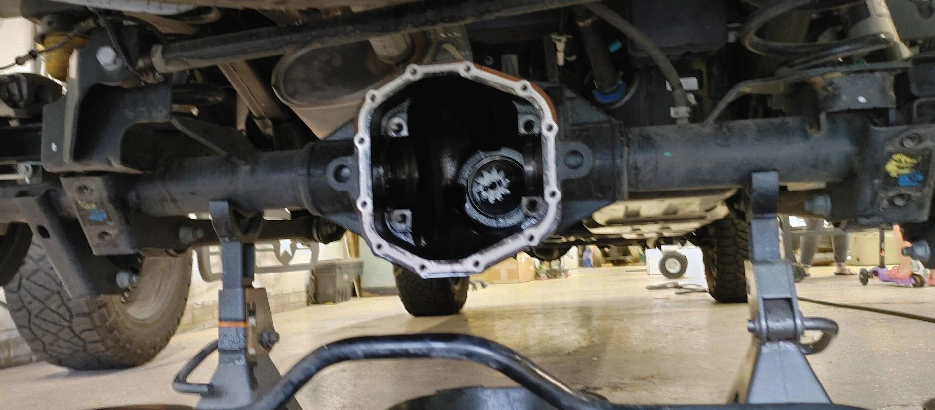

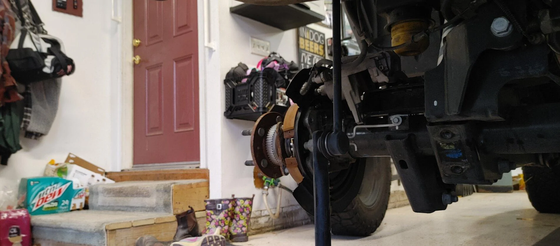

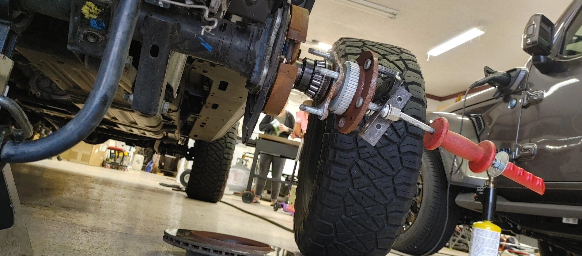

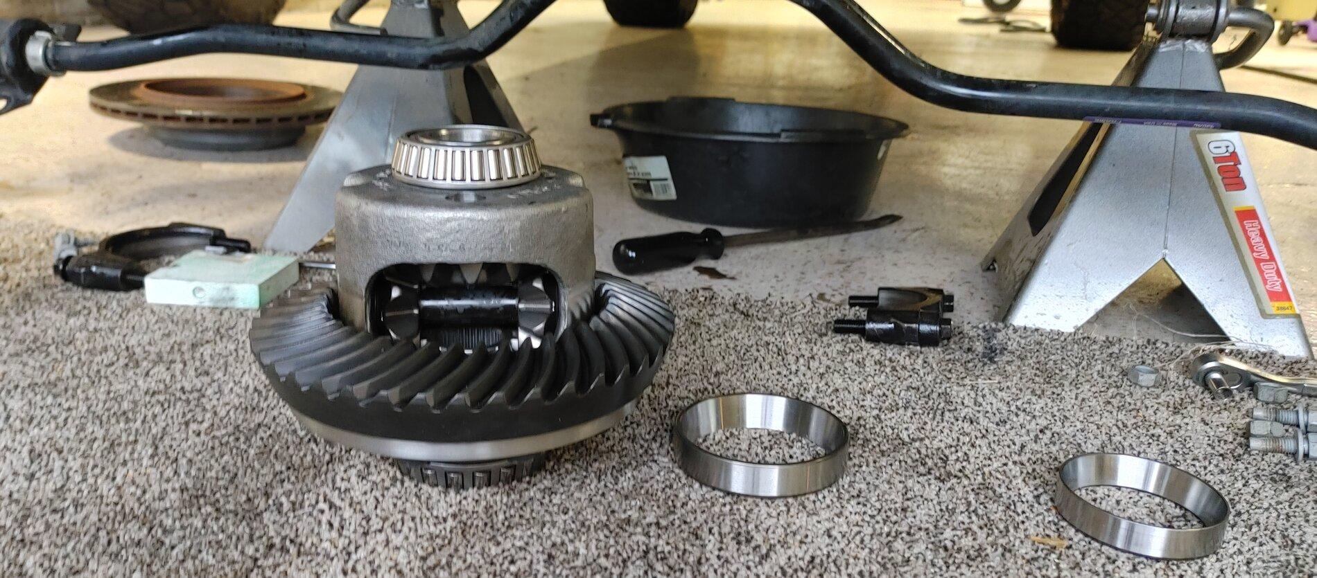

Well I put it in. Really was not all that bad with Access to a 20 ton hydraulic press. I bought a Motive master install kit. Bearings were good (koyo) the rest sucked abd no shims or bolts. Struggled to get the rear rotors off with 17k on the clock. Wire wheel, heat, penetrating oil and 3 lb sledge got them off. Had to make an impromptu axle puller as mine are all chevy. Once I got the bearings pressed all the way on I used the stock shims and had .0.04 play and great pattern. Torqued it all down and filled with BG syncromesh gear oil. Put 50 miles on it today and pretty smooth so far. Not sure how much improved over the traction control ot is but time will tell.
