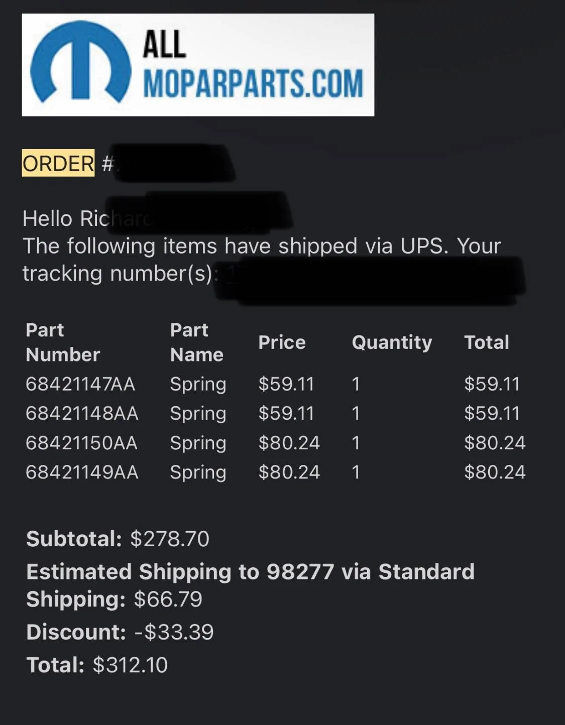

Here are some/most? Of the part numbers.
Front lowers are on Amazon for $40~ each for another cheap score.
I went with Metal cloak for the front/rear sway bar links for $50f/$60 rear. Steer smarts for the track bar up front- rear is 1/16” off center and that’s 1/16 close enough for this guy to run the stock rear track bar 👍🏼🍺
I probably couldn’t measure 1/16” let alone see it 😂

I would probably get the Mopar diesel springs and new shocks for the front and call it a day. Might as well do shocks while you’re in there. It’s pretty damn hard to wear out the rear unless you’re weighted down with glamping stuff.
