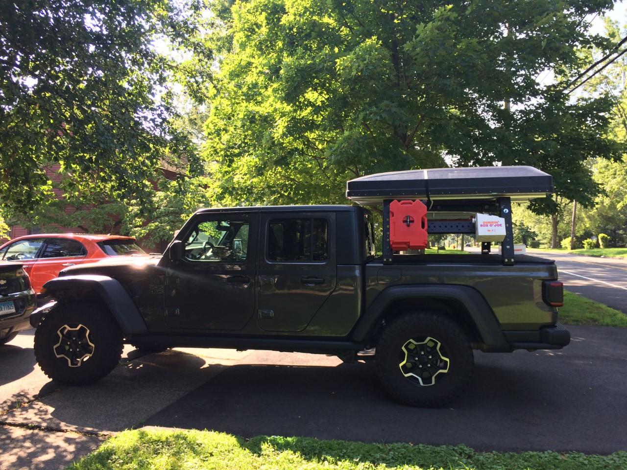

@PsyRN Update to my current set up-
160 lb. Torro RTT
40? lb annex
60 lb. MaxModular rack
30 lb. recovery boards (2 sets)
35 lb. Rotopax gas cans
1M lbs. wife's camping crap including but not limited to- propane hot water/shower, portable toilet, Coleman stove, camp kitchen table, folding picnic table with seats, folding side tables for annex, fans, ZeroBreeze a/c; my daughters cot, clothes, etc..
Cooler full of food
my spare pair of shoes
I added airbags and LOVE them!
With normal gear, I drop about 1.5"-so it looks level. On our return trip from Disney last year, we were about 3" lower than empty- a little squat. Tons of gear (see above), souvenirs, and water-lots of water after a week of rain. Came home and ordered air-bags.
Now loaded or towing I can adjust for squat and it has really cut down on the swaying. Just remember to deflate before the trail for articulation or stay inflated for clearance.
If you want a lift or are planning on serious trails with constant weight, Clayton seems to have that all dialed in. It's what they do.
If you want to be able to account for a few extra pounds now and again, air-bag it.
(I think that there is even a set in the for sale forum.) Fairly quick easy install, takes longer to run the airline than to install the bags. For the price you can try them and ditch them if you don't like them.
