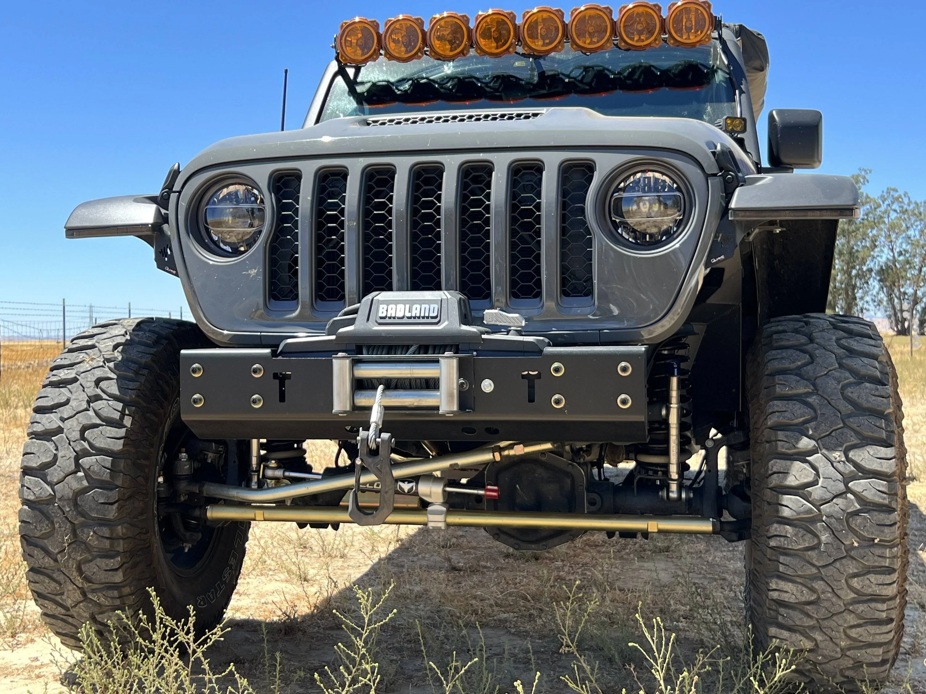

Spring and shock combo work great. I want to try a different setup on my JL/Wrangler. I went Clayton control arms and Metalcloak’s front and rear trackbars.
Jeep Gladiator Mojave Lift for Extra Weight IMG_4861
