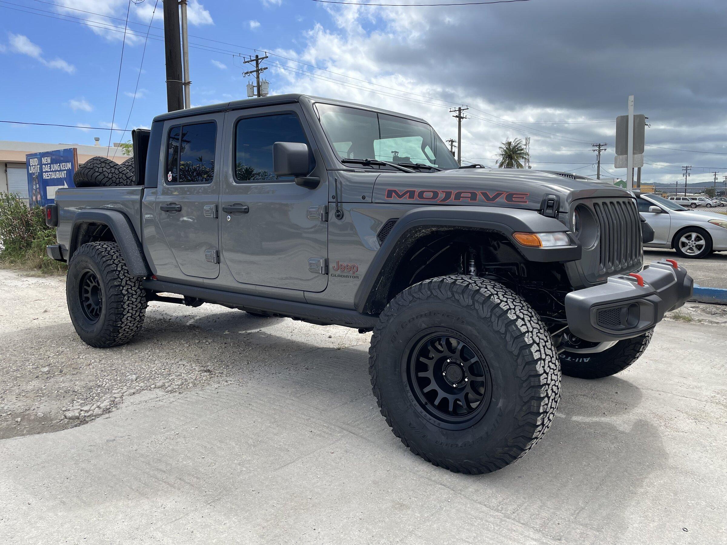

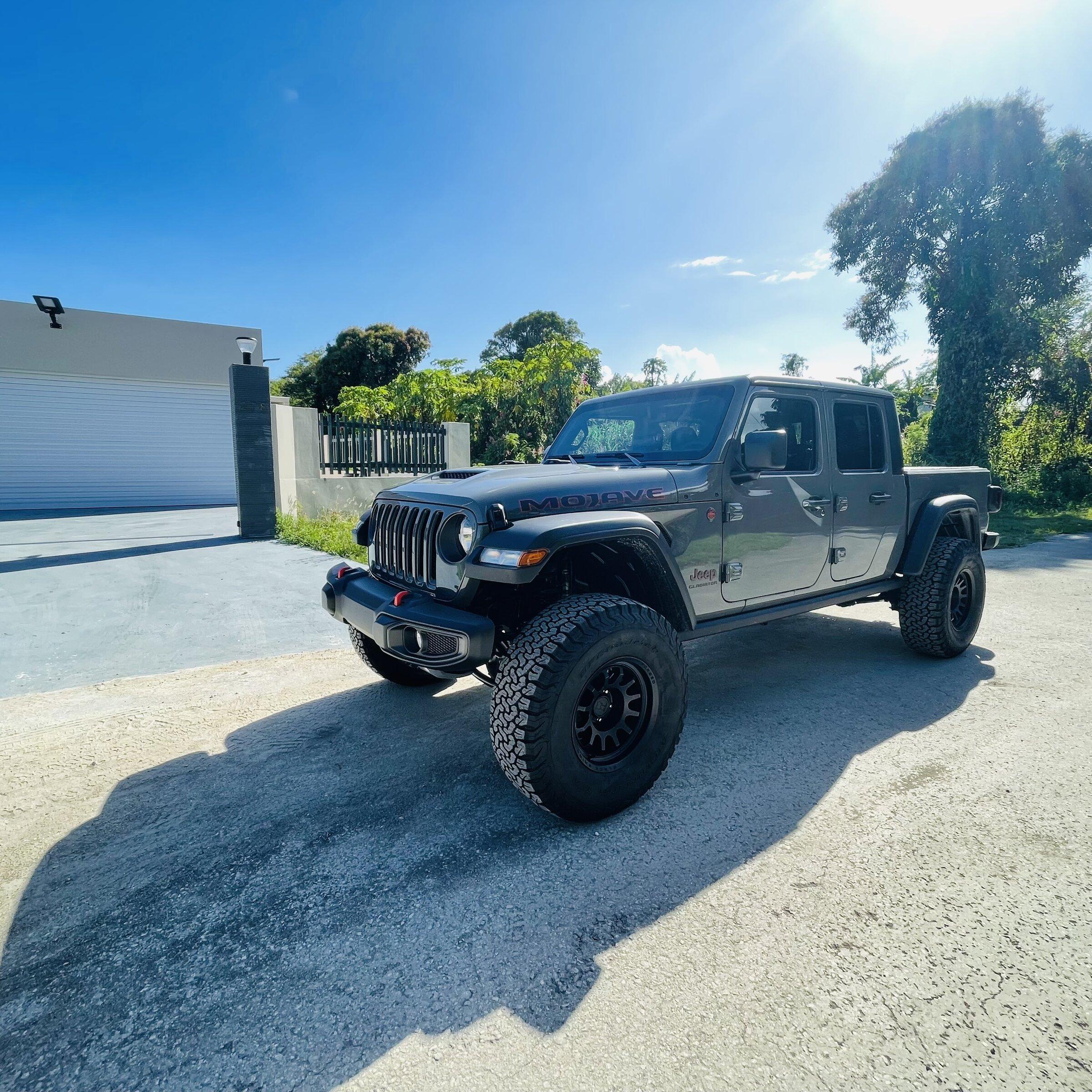

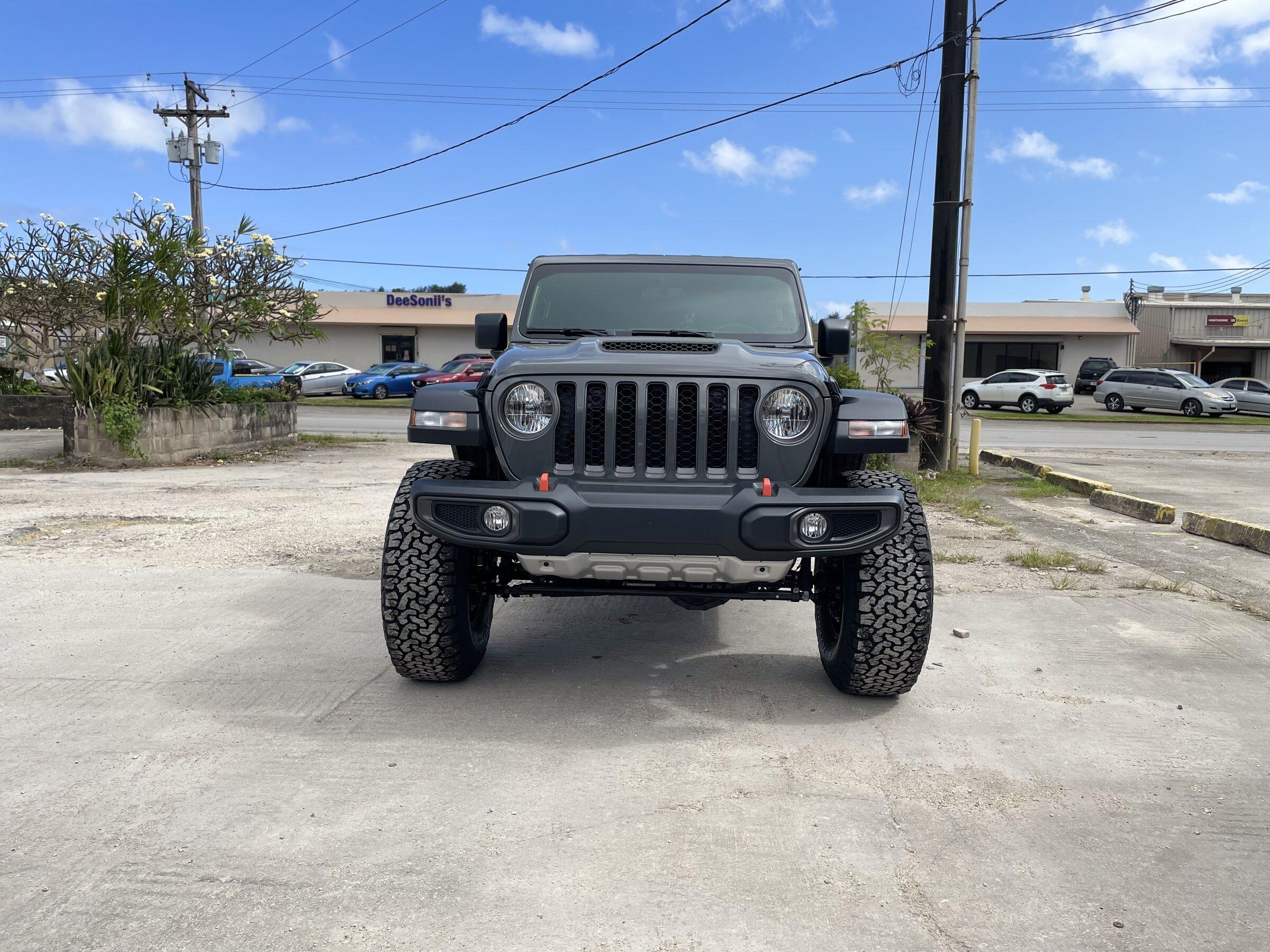

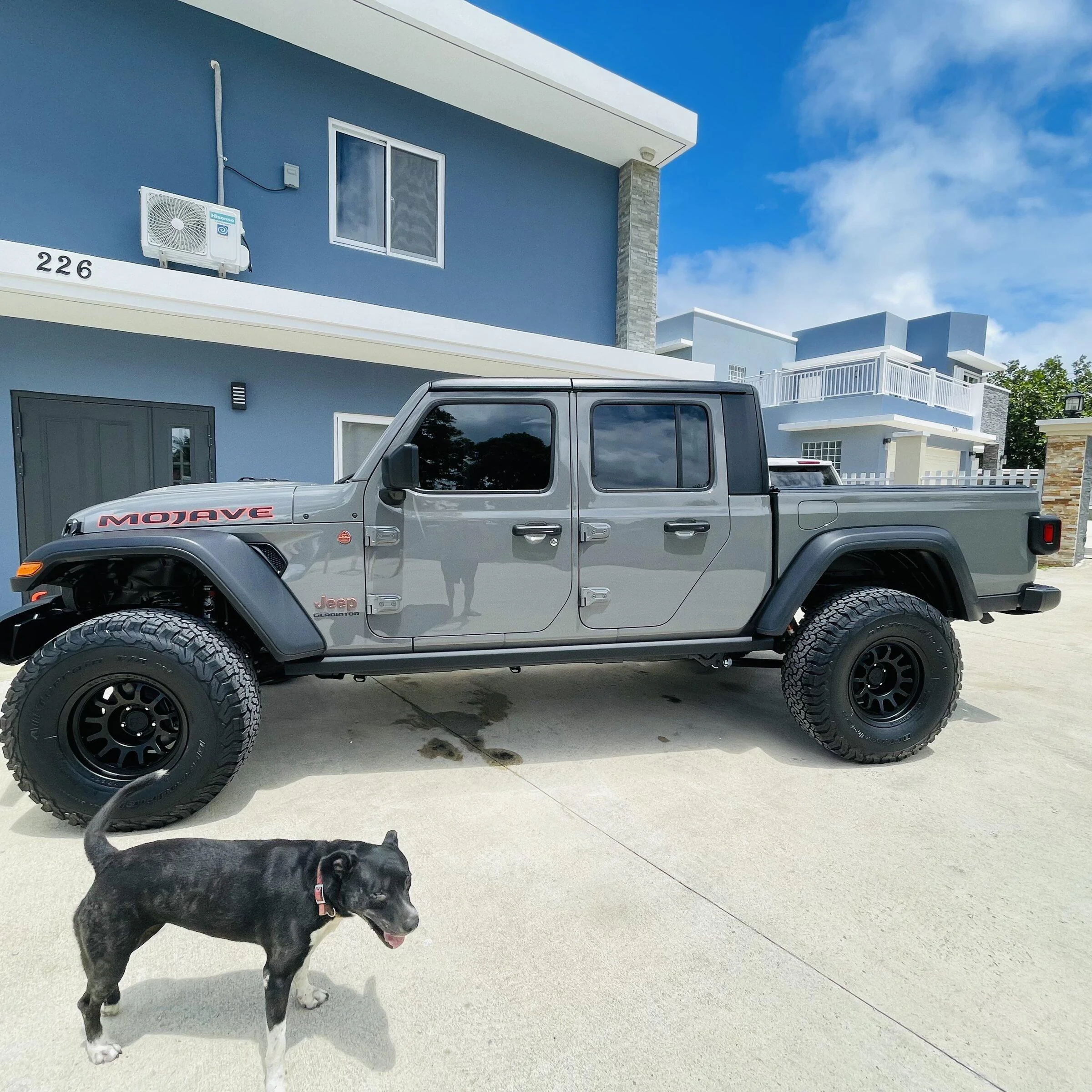

I went with Fabtech’s 2” trail lift kit and just had it installed last week. Drives great so far and I’m running 37” KO2’s with Black Rhino Rapid wheels. I, personally, don’t want to run spacers on my trucks and also did not want to get a brand new truck and dump the nice fox shocks which meant I pretty much had two choices, Fabtech or Readylift and 4” lift was too much for my liking.
