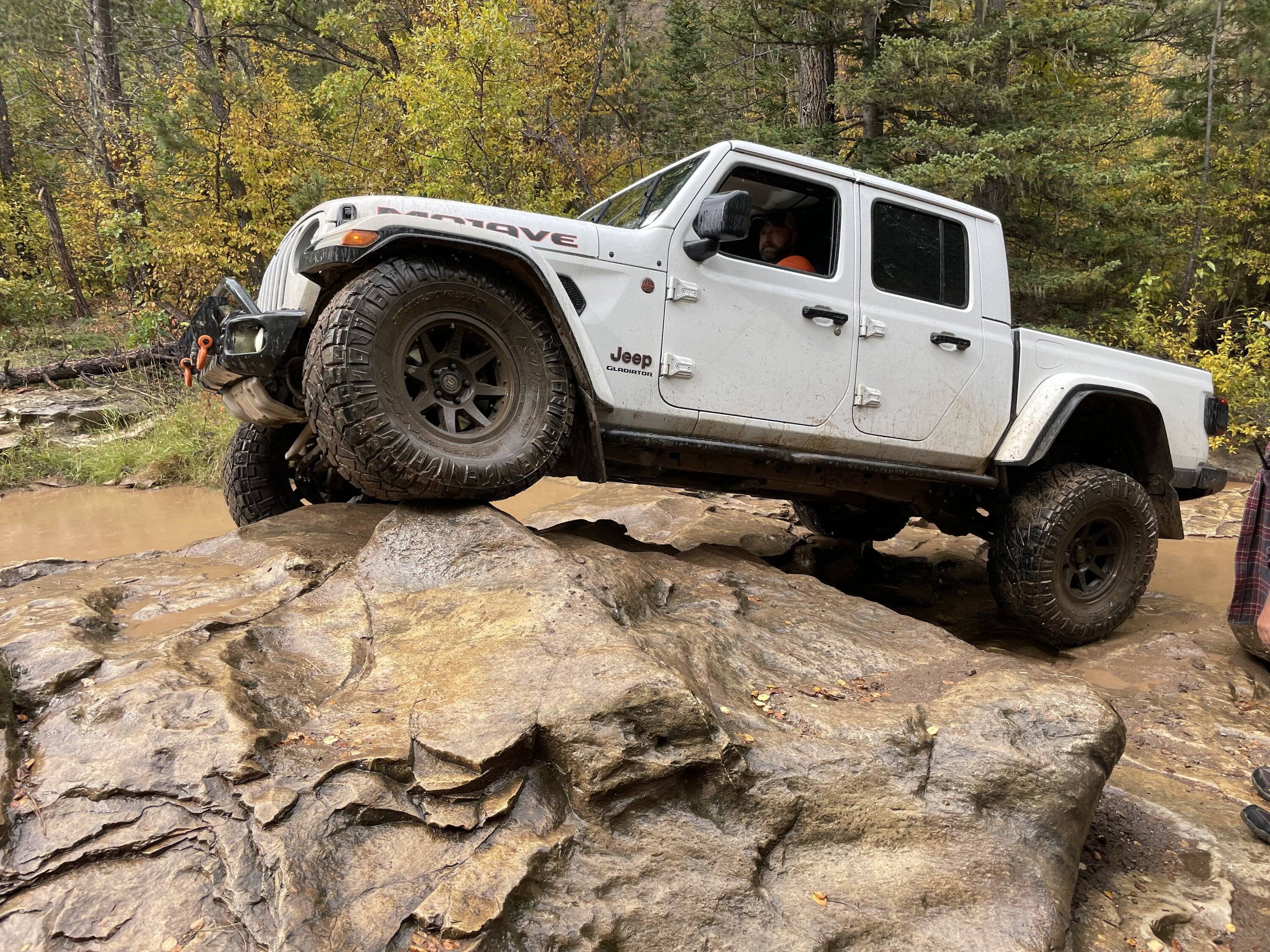

I drove through a riverbed with a ton of rocks and boulders last September in the Black Hills. My truck has the 2” AEV lift with their geo brackets and is riding on 37’s. Suprisingly, the geo brackets gave me zero issues the entire time. There was only one spot that they made contact and that was coming off a large boulder for a poser shot:). My driver side bracket made contact with the rock as I was coming down off the rock, scraped a little, but with zero damage. Overall, I love the on road manners and the AEV Mojave lift was perfect off-road.

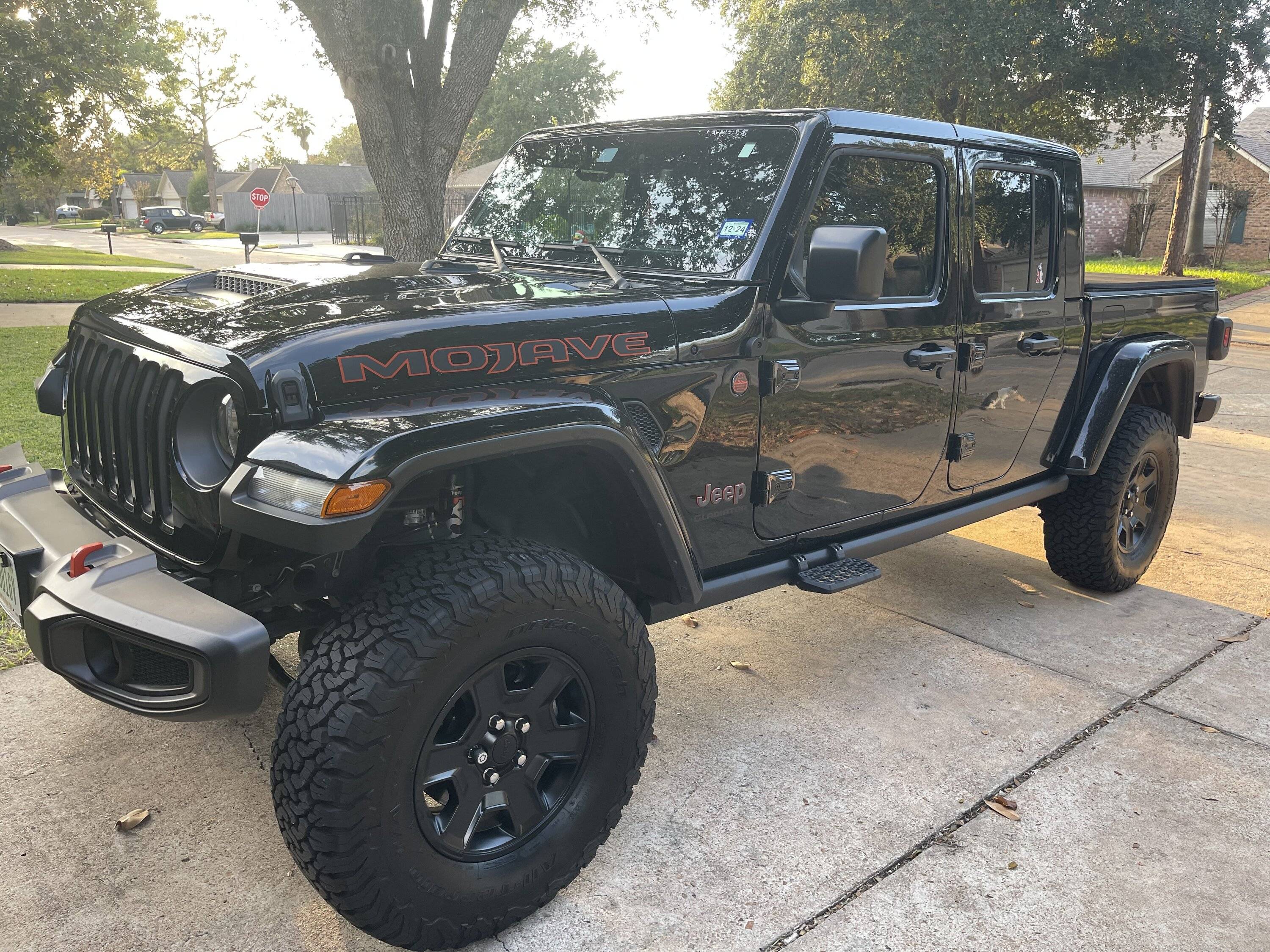

AEV 2 inch and Geo Brackets installed today. Love it, rides even better than factory.
Looks awesome! What size tires are those? Did you need spacers to run the wheels?

Why would you need spacers to run factory wheels?
If you have a taller tire and the oem backspacing, you could rubbing at full flex or steering lock. That’s why I was curious what size they were. The JL/JT platform makes huge tires look standard.
Are those still the oem 33s?
