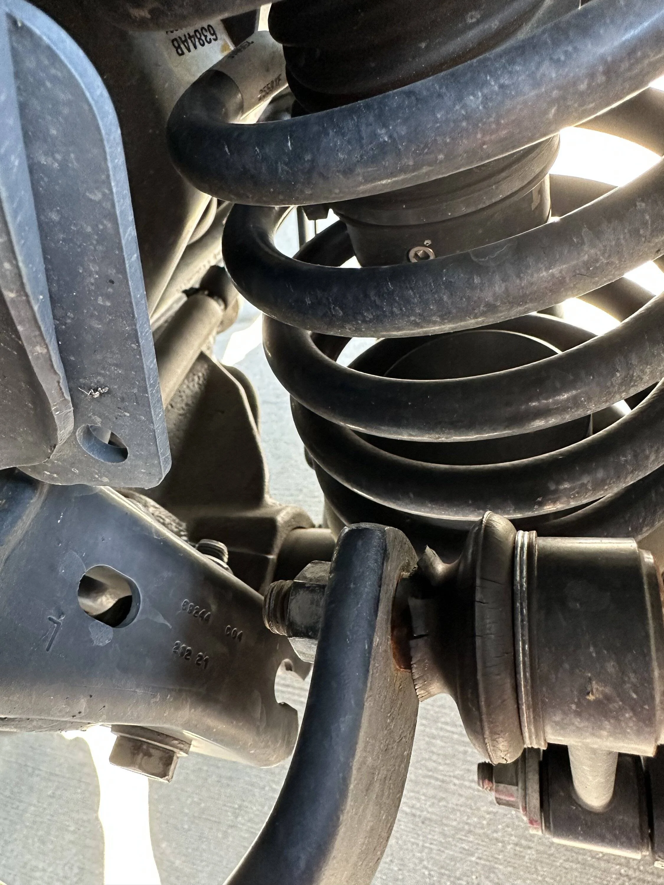

I have had my AEV lift installed for a year now. It has been a great system but the boots on all the the sway bar links are completely shot. All of them are brittle with large cracks everywhere.
Anyone else having the same issue? I’m planning to call AEV to see about replacements and if not, will buy some from somewhere else.
Cheers
Cheers
Yes, I have the same issue after less than 6 mo ?
Cheers
Curious to see how AEV handles this. I’d like to pull the trigger but getting cold feet for AEV. May go Clayton.

I haven’t noticed it on mine but I’ll look more closely this week as I have to replace the drag link.
Assume we could replace the links with something else if they’re shot and AEV won’t send replacements?
Yea I haven't looked into it enough but will start researching options.
Cheers
Following just curious of the outcome on this. I hadn't thought about the end links, but had been thinking recently about putting in just longer, progressive rate springs and removing the AEV spacers.
Cheers
Same here!!! I just noticed this a few months ago when I put on my 37s and was playing with my alignment. Boots are pretty done and was upsetting considering I’m at about a year and a half now since installed. Thinking I should go with something with quick disconnects. If anyone gets with AEV please post. I will if I find time to.

Never mind, add me to the list on the torn boots. Damn.
Jeep Gladiator AEV 2" spacer lift for Mojave Gladiator IMG_2722

I had mine on for about a month before I swapped the fronts to Apex Autolynx. The boots on the links looked like a tire that had been sitting out in the desert for a decade. For the price of the kit I had expected better,
