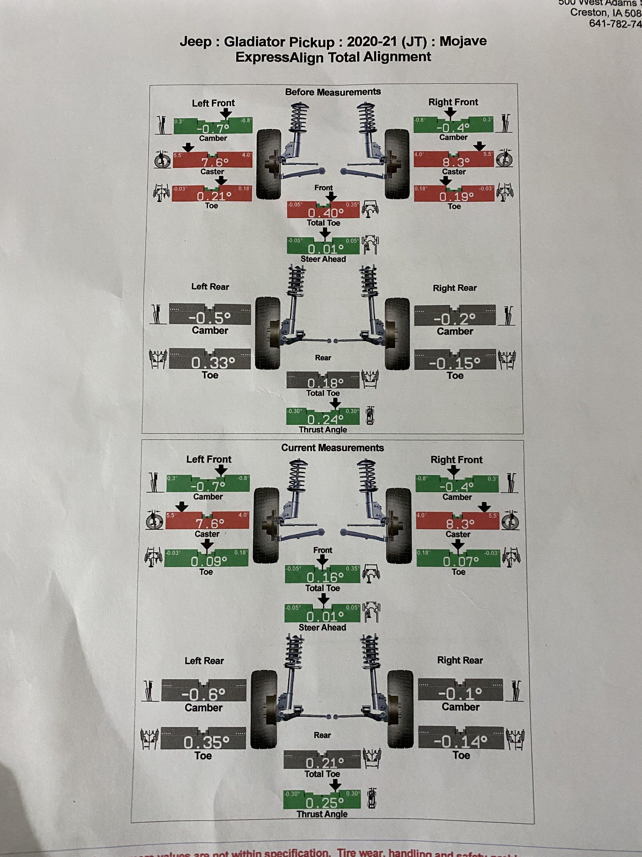

I just finished this lift and the Rancho geo brackets with arm in center hole as I have read on here. The steering feels a bit loose with a slight bit of wander. Anyone have any ideas? AEV steering stabilizer or use a different hole? Been running 37's all summer and did not notice anything before.

I’d check the alignment first before buying anything additional.

I think things have settled in nicely, it seems to be driving good. I thought I would include the alignment numbers. I questioned whether they thought the caster was too high, I could always switch to a different hole. They said they would probably leave it alone. Any thoughts are appreciated.
Your caster is probably a little high. Try driving in 4WD down the road and you’ll likely get a vibration around 45MPH due to the pinion angle unless you’ve changed drive lines. I miscalculated my caster and got a vibration in the drive line and I was about 8 degrees. I have my caster at just over 6 degrees on both my gladiators and my wrangler and it seems to handle well. Just my experience and your may work perfectly with more caster.

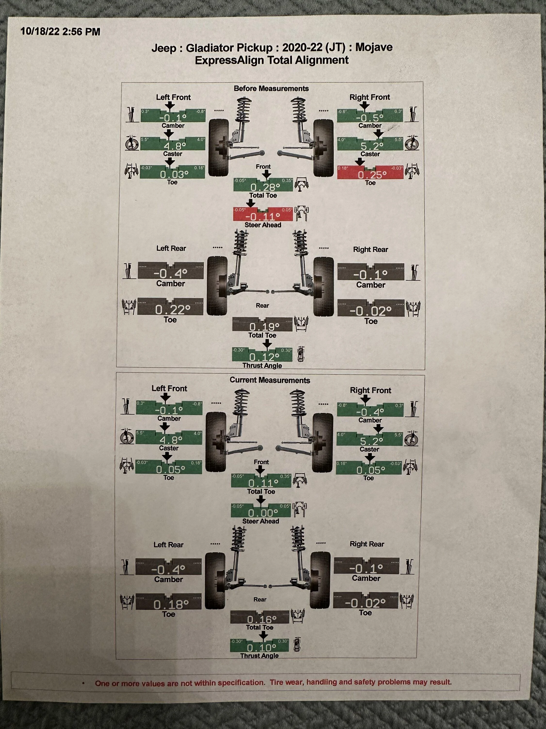

@Viper501, did the middle setting give the 6 deg caster? I'm shooting for 6 deg and can't tell from the thread whether that's the middle or last setting.

Did the middle position and got what the printout shows. 4.8 and 5.2. It drives fine that way.

I too have it on the middle and it drives pretty awesome. Can’t imagine it being better.
