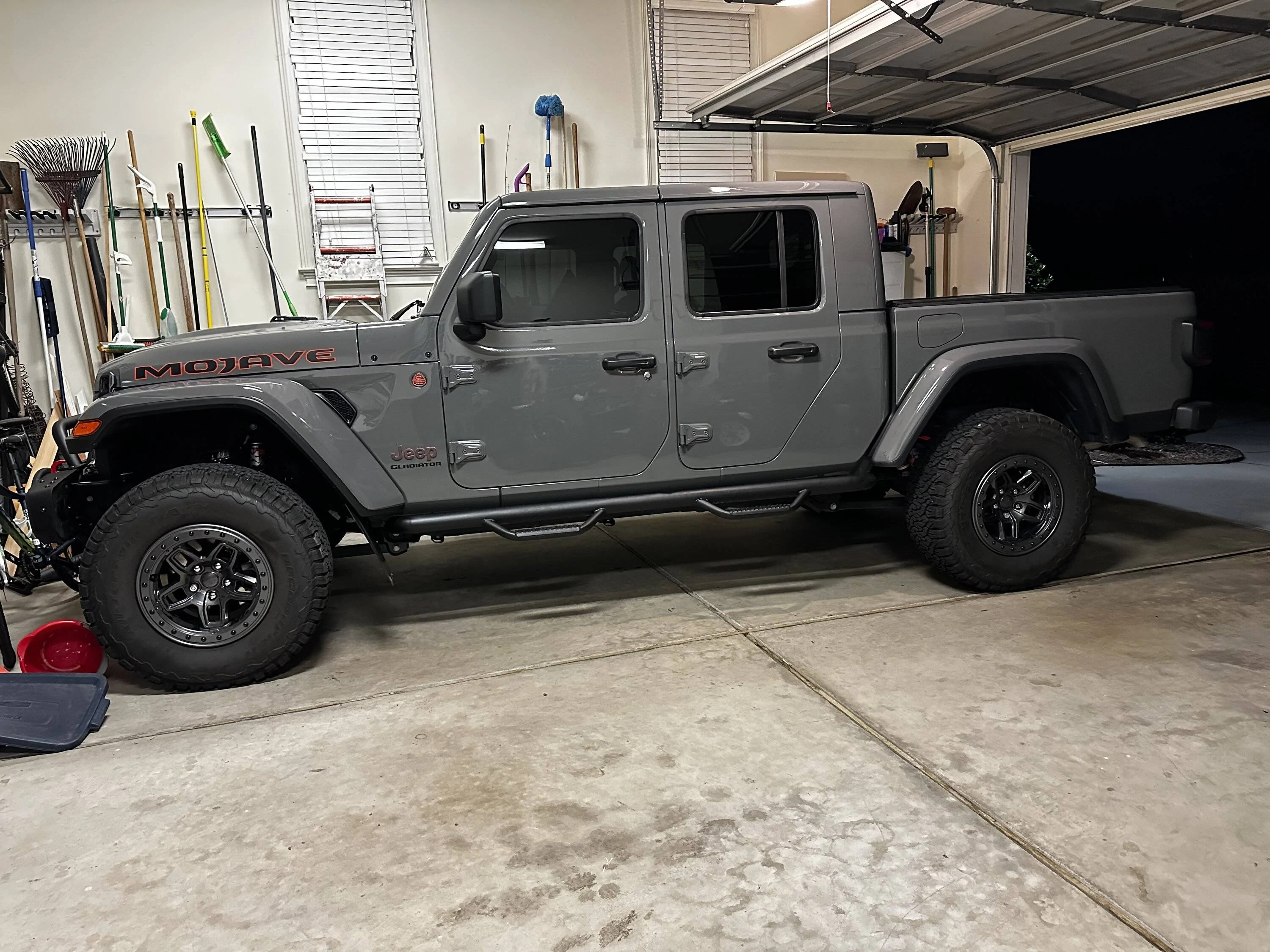

Have any pics of your ride? Running 35 KO’s also and wondering what it will look like after the lift. Hopefully adding my front bumper and winch this coming week while I’m off. Then the lift comes next. Probably have a shop do it for me due to work schedule and lack of time.
Jeep Gladiator AEV 2" spacer lift for Mojave Gladiator MoLake
Jeep Gladiator AEV 2" spacer lift for Mojave Gladiator PXL_20221019_215202423

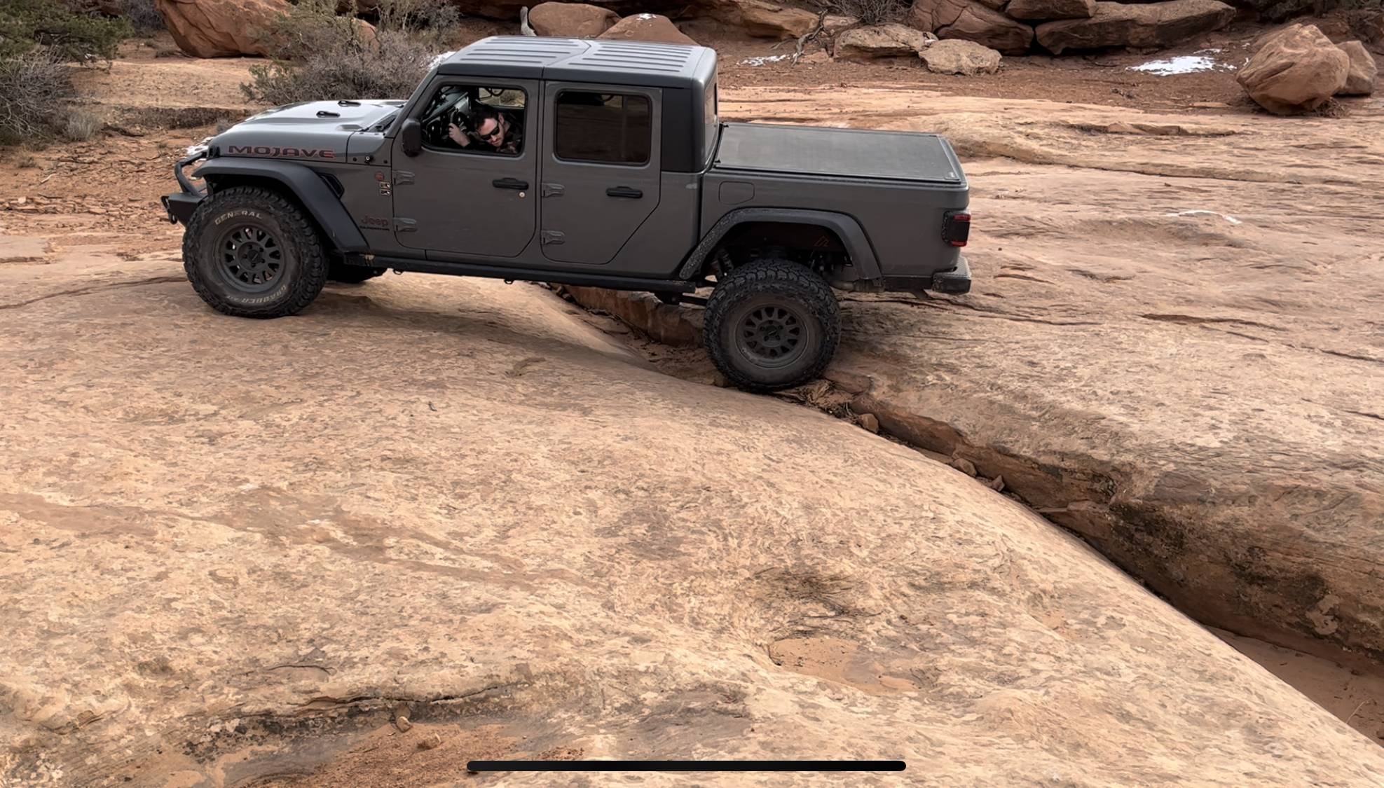

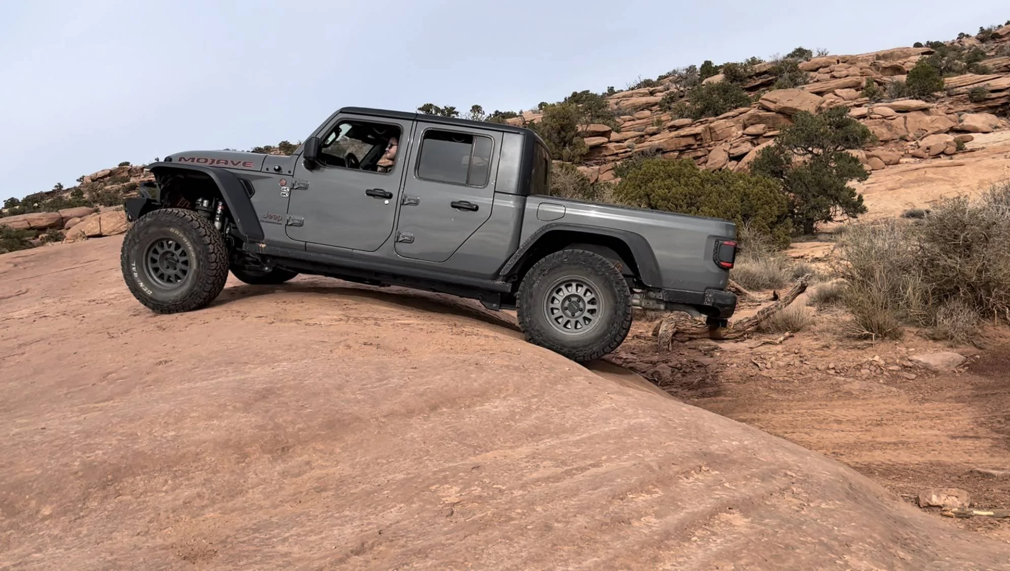

AEV Mojave lift doing work in Moab.
Jeep Gladiator AEV 2" spacer lift for Mojave Gladiator 3A68F7B9-5F63-4A70-81BF-0C6E0FE855A4
Jeep Gladiator AEV 2" spacer lift for Mojave Gladiator A44A088D-95AE-41FA-B81C-0937735F8400
