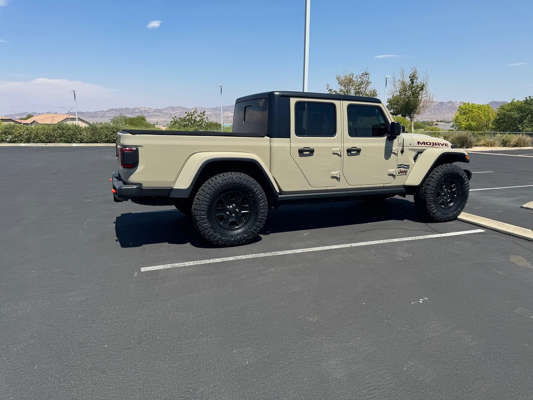

Old thread here but I'm wondering if wheel spacers are needed with 37's and stock rims? Im ready to install AEV 2 inch Mojave spacer kit, AEV geo brackets with 37X12.5X17 Nitto ridge graplers on stock rims. Photo attached is 37's stock rims on stock Mojave, just wondering if I'm gonna need wheel spacers and if so what size is recommended? Thank you
I have the 2inch AEV lift with 37s and stock wheels and did not need wheel spacers, no fitment issues. Having said that, I did add spacers just for a little wider stance

What size wheel spacer are you running?

With stock aluminum wheels you can do 1 inch spacers.There are pockets on the back side of the stock wheels to make room for the studs.Ive done this on other JKs and JLs.Check your wheels first incase Jeep changed something.
