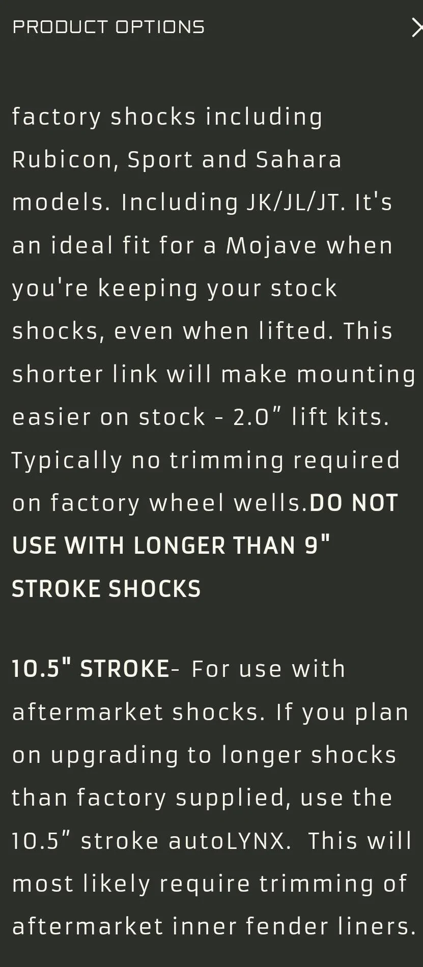

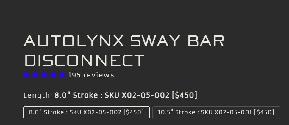

Want to do this soon - sounds like since I already have Apex, no issue? Will the "short" Apex be enough for this lift? I have the 8" :
I'd hope so, per Apex...
Jeep Gladiator AEV 2" spacer lift for Mojave Gladiator Screenshot_20231207_224945_Chrom
I know many lifts are reported to actually be greater than the manufacturer's stated lift in inches. Is the AEV truly a 2" lift to stay within that limit?
@Vengeful One are you in the Mojave with AEV 2" lift, and still have stock shocks? If so, do you have the 8" or 10.5" Apex Autolynx?
Yes that used to be mine. I had the 8”.

what's funny about the 8" is they're too long at the shortest adjustment for a stock Mojave! 5.5" stock. The 8s go down to about 6.5...I have mine at the minimum.

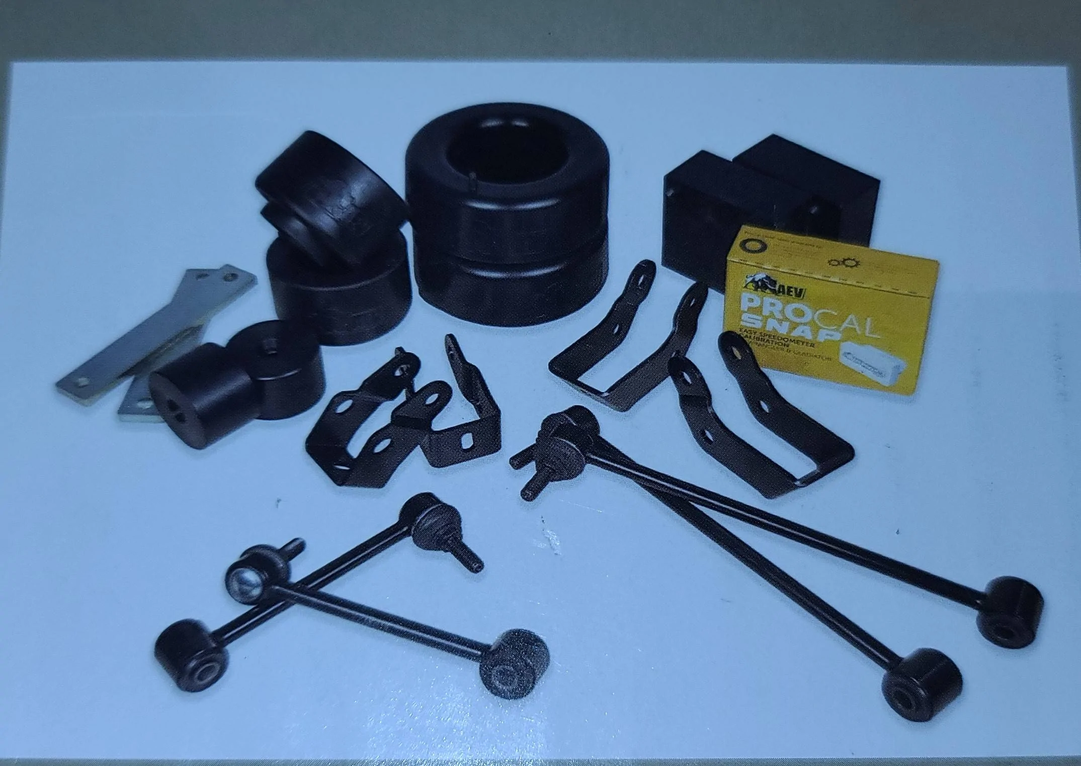

Does anyone have a pic of the hardware packs that come with the AEV 2" lift and the AEV geo brackets?
I might have an opportunity to buy used and would like to make sure nothing is missing. I could probably find in youtube videos, but a good pic/detailed-list of what comes in the box may be more accurate/easier.
Haven't installed mine yet. At this point not installing the Geo brackets, but am adding the longer mopar control arms
Jeep Gladiator AEV 2" spacer lift for Mojave Gladiator 20231210_190059

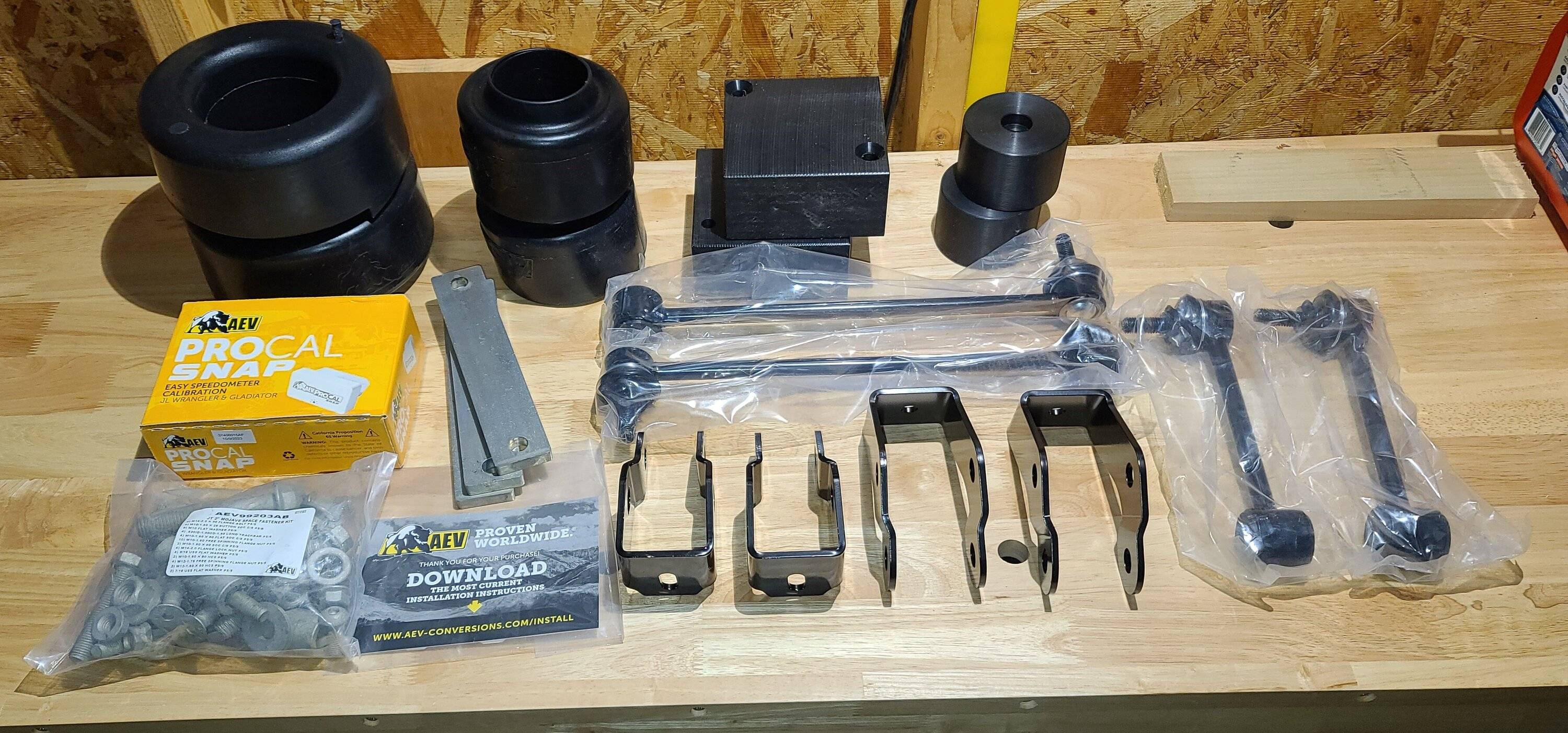

Please don't open it up for me, but when you go to install if you could take a pic of all the hardware, I'd appreciate it. Totally understand if you forget or just don't want to lose track of it all sprawled out.
Here ya go, everything in the box. It doesn't look like a very intimidating project just sitting on the workbench, lol.
Jeep Gladiator AEV 2" spacer lift for Mojave Gladiator 20231210_202652

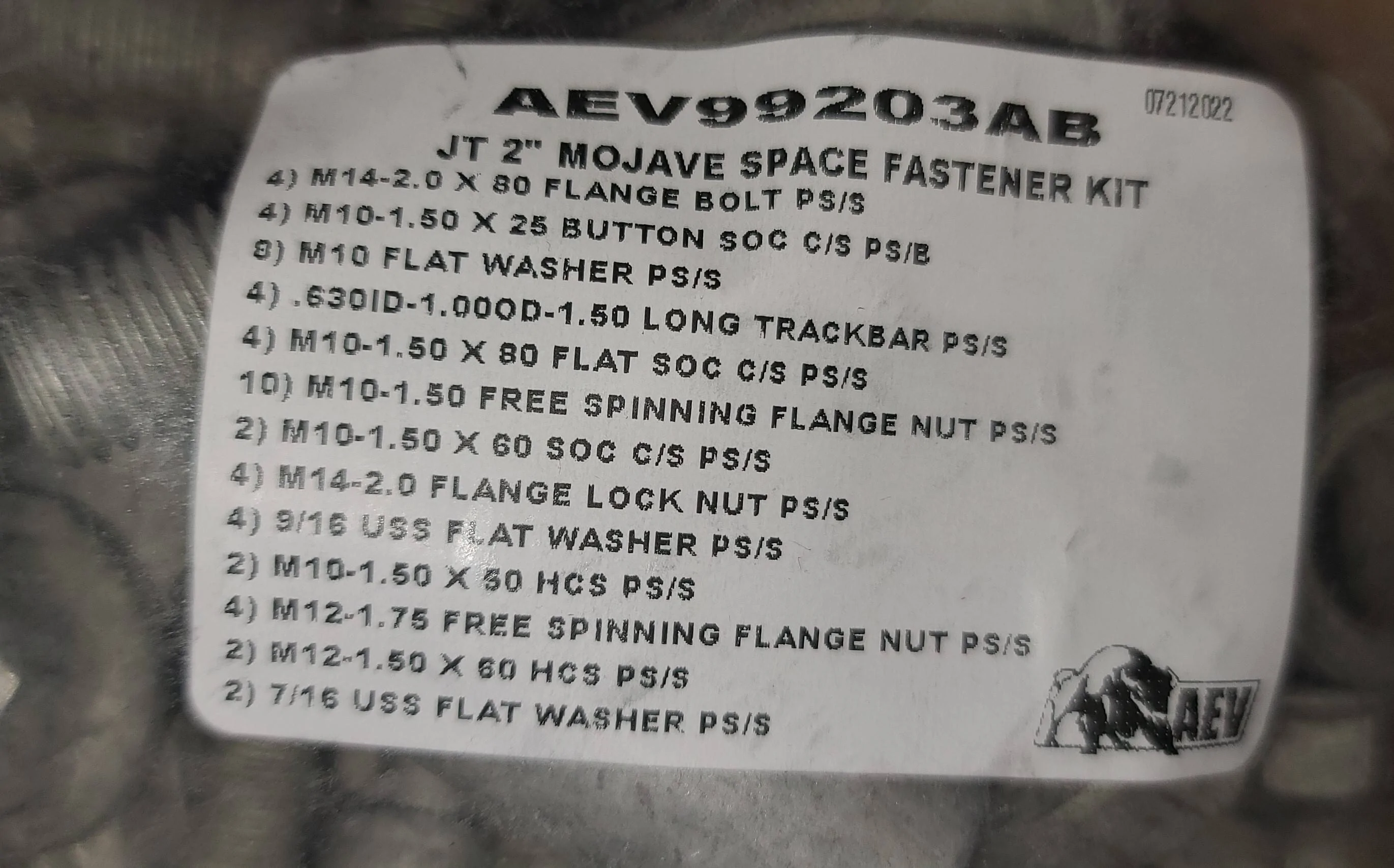

Thanks again! But so sorry, by hardware kit I meant the fasteners in the bag. Site called it a hardware pack, sorry for not specifying more clearly. Easier to be sure by seeing it to compare, since I'd be buying an open/used/disassembled lift. The list on the first pic is sure helpful though.
Again though, I don't want you losing track of everything by sprawling it out early. You've been more than helpful.
