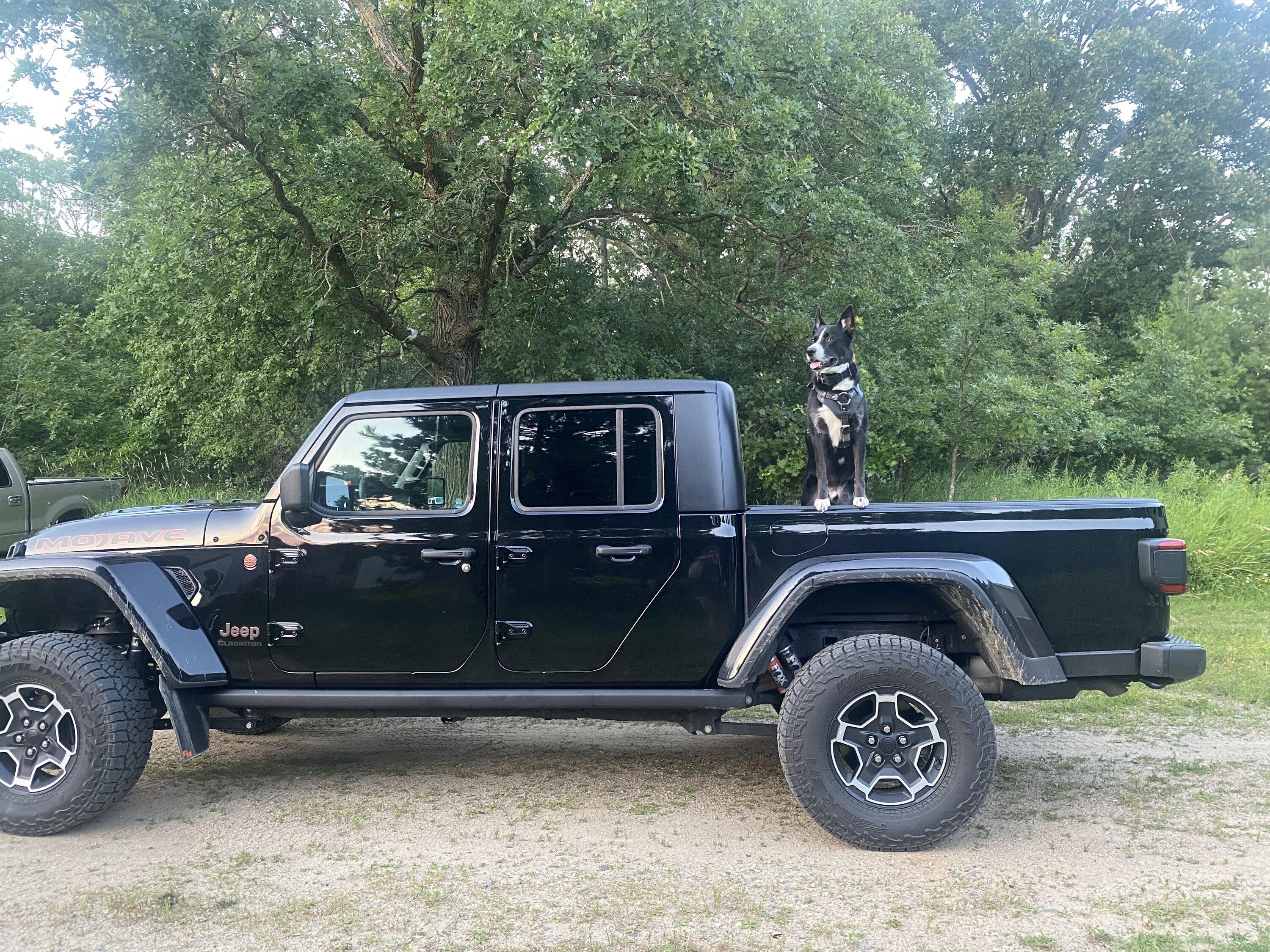

I have the Mopar LCA and the AEV kit sitting on the shelf until i figure out what tires i want to get. Anyone run theirs on the stock tires for a bit? how did that end up looking
I have the stock wheels and tires on mine for a bit until i get new ones.

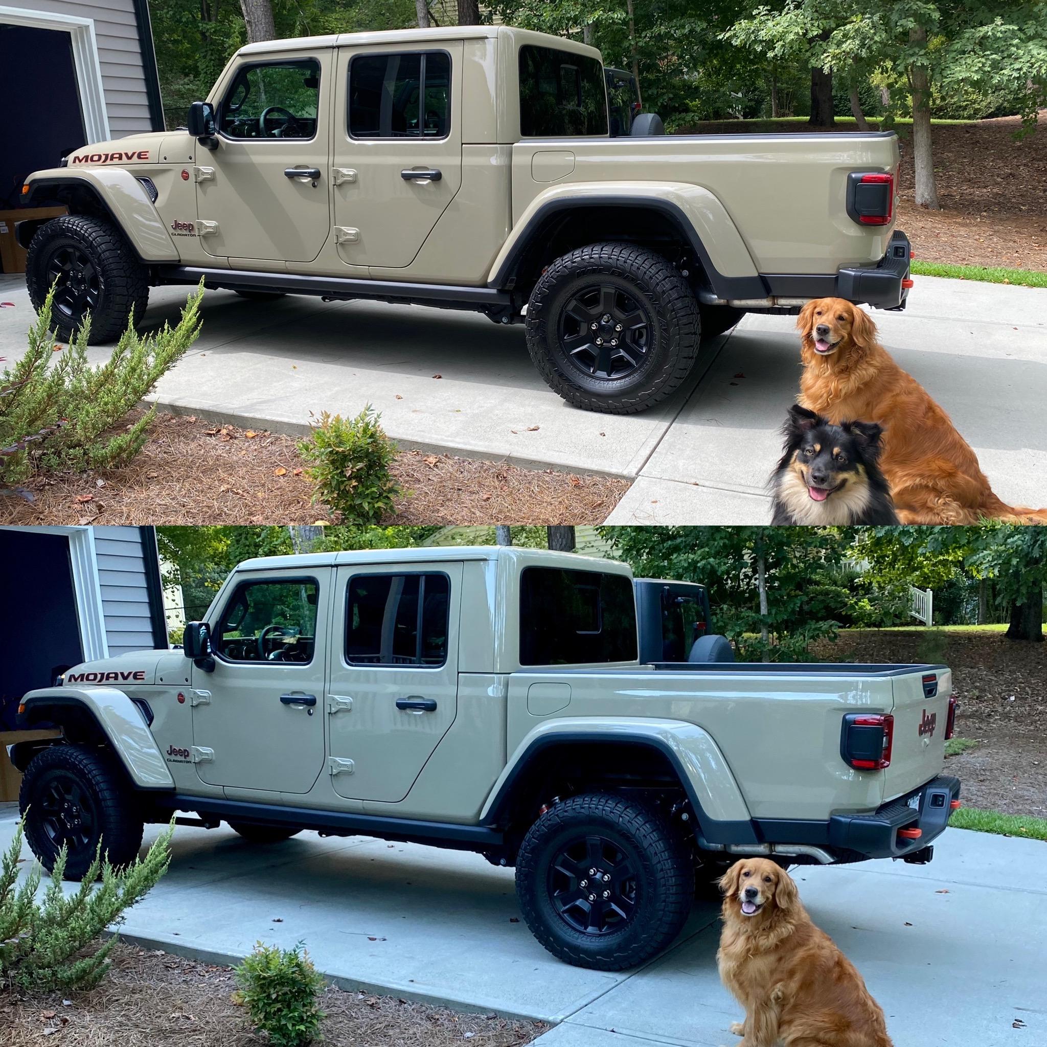

Installed this lift last weekend along with Rancho geo brackets - front LCAs on the middle bolt slot from other members suggestions. No alignment data so I don’t know how the caster sits but she rides great and maybe less wandering on the highway. Anything is better than my 2 door JK on 35s though. Axles are slightly shifted but not really noticeable to the naked eye. Definitely recommended having sharp drill bits… Had to run by the store during the install to get fresh bits because drilling through the shock mounts was not fun. Also, 190 ft lbs on your back for like 14 bolts is terrible. I was sore for like 4 days. Not looking forward to rechecking them. Overall, the install was pretty straight forward and was easier than lifts I’ve done in the past. Part of that could be because the truck only has 500 miles on her and everything was fresh on the underside i.e. no rust, new bolts. She drives great and would definitely do it again.
The 33s don’t look too bad with the lift and would definitely like 35s but having a MT and barely being able to use 6th as is, I‘m holding off or now. Made this decision on my JK (4.10s) a few years back and it stunk until I got used downshifting at every hill. My fiancé agrees after I told her how much a re-gear, wheels, and tires would cost lol. I’ve attached a before and after image of the truck. Tried to get the same angle as best I could and included the dogs for reference purposes.
ps. Still trying to figure out how to bolt down the front passenger bump stop pad. Ordered some offset box end wrenches to see if that will allow me to hold the nut so we’ll see. It’s being held with 3M tape for the time being.

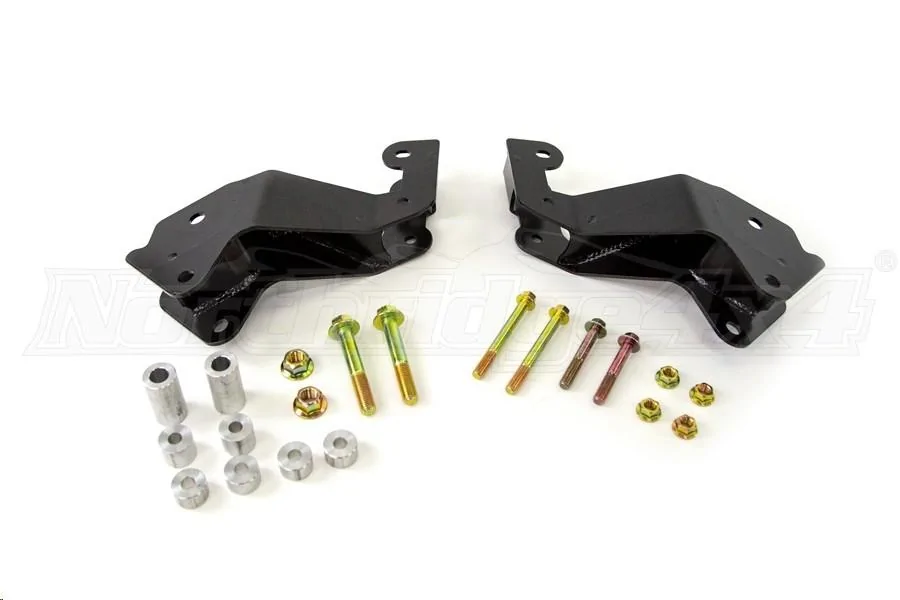

Another one to look at is the TeraFlex Geometry brackets:
https://www.northridge4x4.com/part/...-control-arm-sport-bracket-kit-2-5-4-5in-lift
We have them in stock and TeraFlex is currently 15% off.

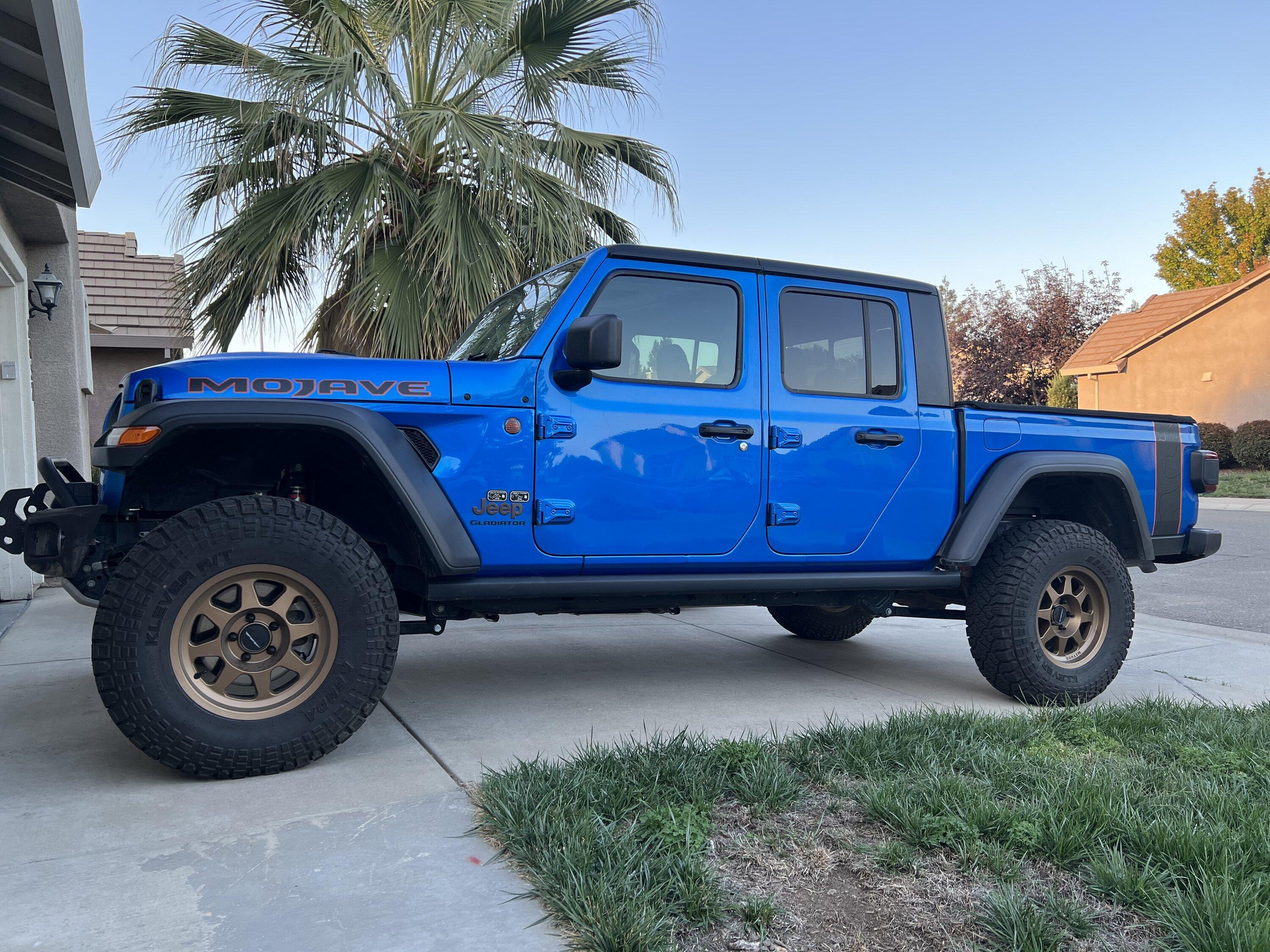

Got mine all buttoned up this morning. AEV lift with the Rancho geometry brackets.
I’m very happy with it, it rides just like stock. My axles did shift a bit so I’ll be ordering a couple adjustable track bars in the next day or two.
I did see some good dents underneath there from my trip to Moab. Factory skid plates doing their job. The Asfir ones had no dents at all. Very happy with them.
