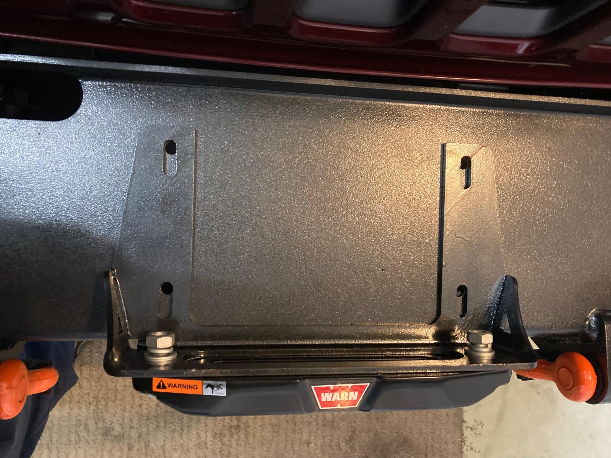

Did you have to make any mods?
Nope. Motobilt did a reasonably good job with this design.
Would I have done some things differently, yes. For 1 example, the inner support gussets for the winch should have been welded ~1/4" further away from where they are to allow much easier access to the winch mounting hardware.
Also, if mounting a winch - you may decide to go with the Motobilt fairlead mount.
I needed to slightly grind/modify the Motobilt fairlead mount gussets due to the size of the Warn winch. This pic doesn't reflect it, but they would have interfered with the winch.

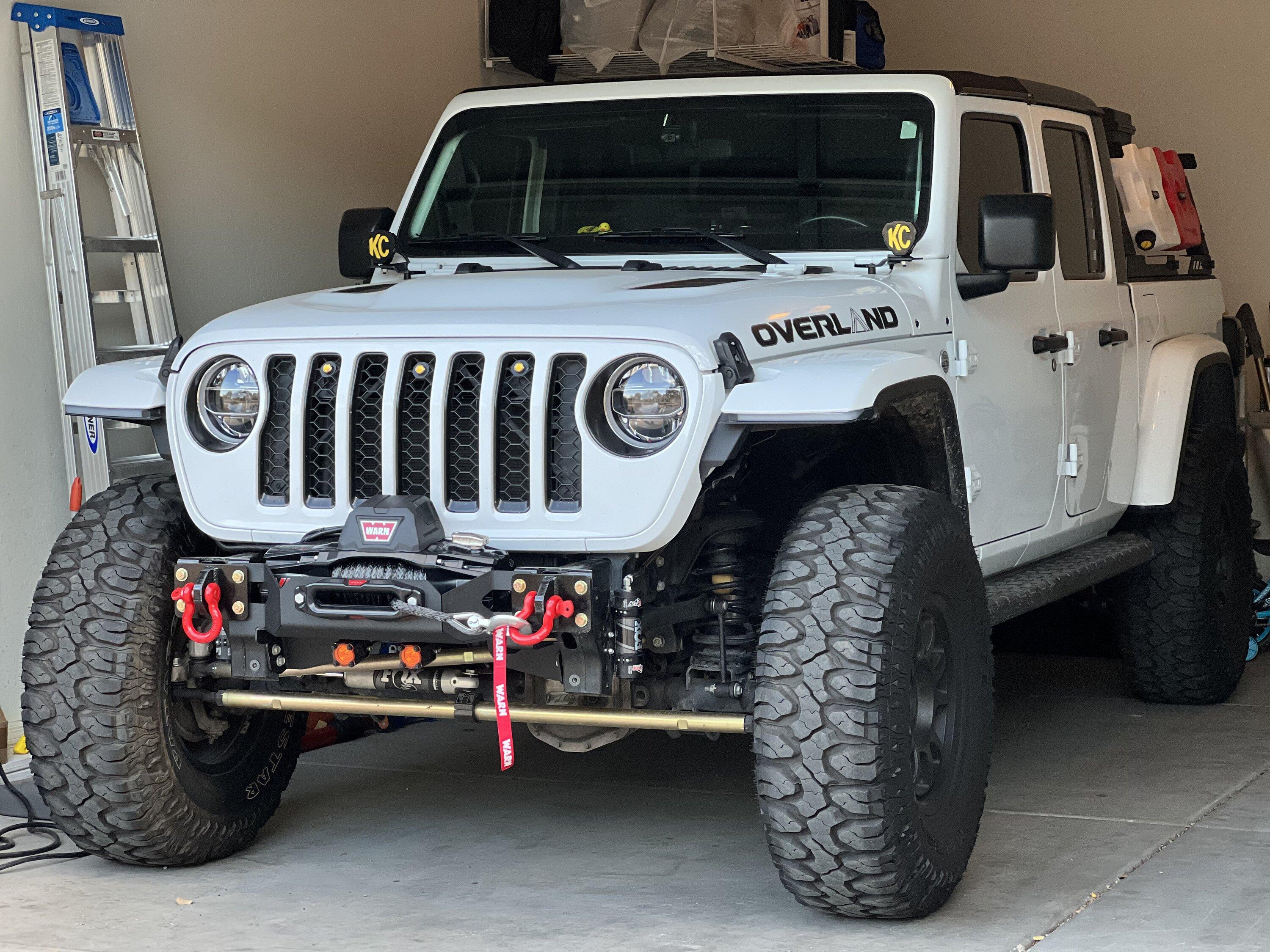

Everyone still happy with their AEV spacer lift? I know I am and it rides so good with the slightly longer Mopar LCA’s. I’m itching to go a little higher but I’ve had no drivability issues. Decisions, decisions….
Nice rig, fenders look clean, did you do the chop or are they the ones they sell? Also, what lights are below the winch? Thanks ??
tonywin
Tony
Oct 4, 2021
359
569
Phoenix
2020 Gladiator
Thanks! I did the chop myself, it’s the Rugged Ridge kit. The amber lights are the KC Flex single LEDs with amber covers.
