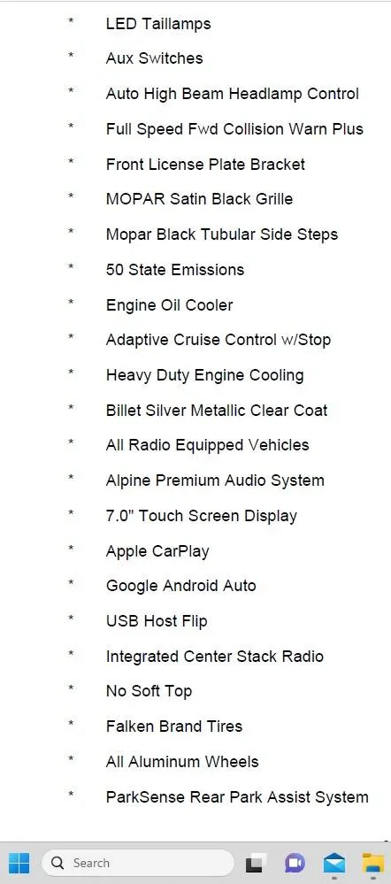

Yes, there's no amp with the base system they are just powered off the head unit in my research. The alpine system has a 12 channel amp 1 channel each for the 8 speakers and 4 channels for the subwoofer. All are 2 ohm in my research including each of the 4 voice coils on the sub.
I paid for an Alpine Premium system and there is a sub in the back and a 7" display. My build sheet shows Alpine Premium with 7" display and I personally measured all the 3.5" speakers at 4 ohms.
I've never seen an alpine system that didn't have the 8.4" head unit, so I have no idea what's installed in yours.
Here is part of my build sheet and it shows 7" and Alpine Premium
Weird as this wasn't an option in the JLU, and that's where all of my research has been (2019 and 2022 JLURs before I picked up my 2023 mojave). The speakers with the 8.4" typically measured 2.7 ohms static. Makes me wonder if they don't upgrade the speakers when they upgrade the 7" and simply add the amp and sub? If it's the same amp I'd imagine it would be underwhelming driving 4 ohm speakers?

In '21 the amp with subwoofer could be ordered along with the 7" display.
And my JT Mojave was ordered in March, 2021.
The basic systems I've seen on this form show a different 3.5" speaker between the basic and Alpine Premium system I have, not counting head size. If the head and tuner/amp are separate why would they change speakers when changing head size? I believe the Alpine components are the tuner/amp and speakers and somebody else makes the head.
