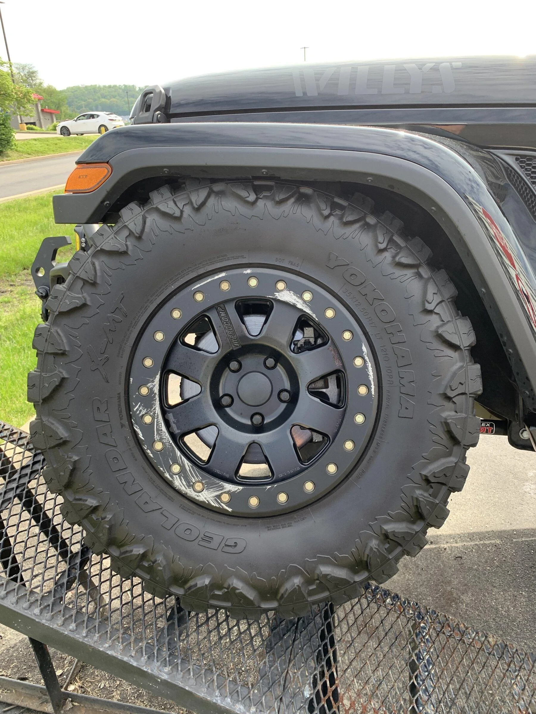

A LOT. This is a 3.5” spring with 3 hockey pucks and 35s. The 13.5 width of that 38 isn’t going to help your cause either. It’s a different story if you never disco.
Jeep Gladiator Amount of bump stop for 38" tires. 3009013B-D4A9-4935-868B-6ACDC8B5881C
