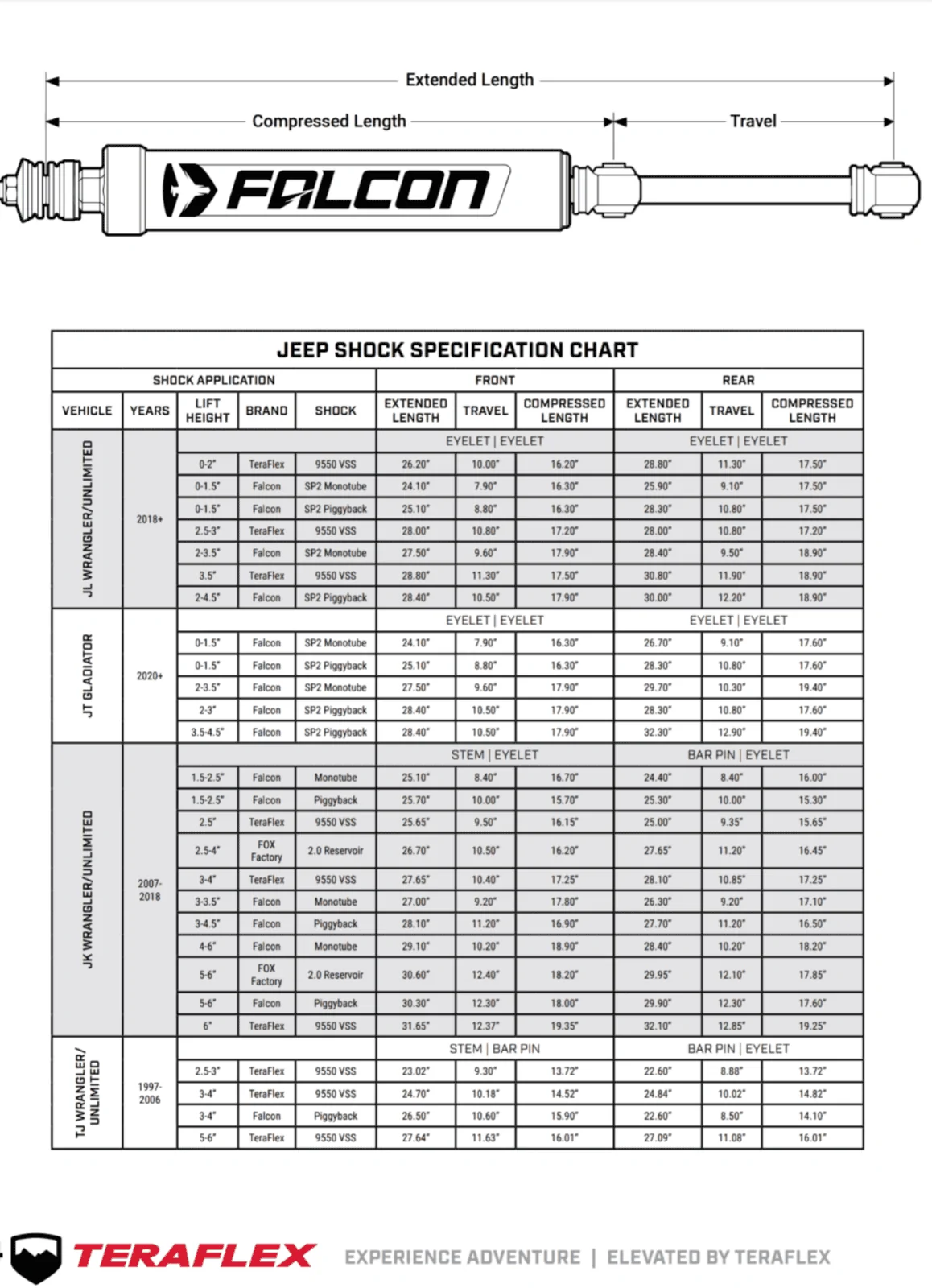

Here is the Falcon Shock length info.
Note: You will notice a big difference in the rear shock length for a JT between the 2 to 3 inch and the 3.5 to 4.5 inch lift. It is like a 4 inch difference -- but, no difference in the front. This makes a huge difference in rear articulation, but, some manufacturers springs may unseat at that length. I have the 3.5 inch clayton lift and I am running the 3.5 to 4.5 inch Falcon lengths, and I really like the lengths so far.
This is really helpful, thank you. The Falcons are top of my list for a replacement set, and now I have some data to work with for those. Want to use the length of my skyjackers as a baseline since those shocks have functioned well so far. Need to measure the fronts eye-to-eye and get those values so I can pick a set from another manufacturer that is similar.
