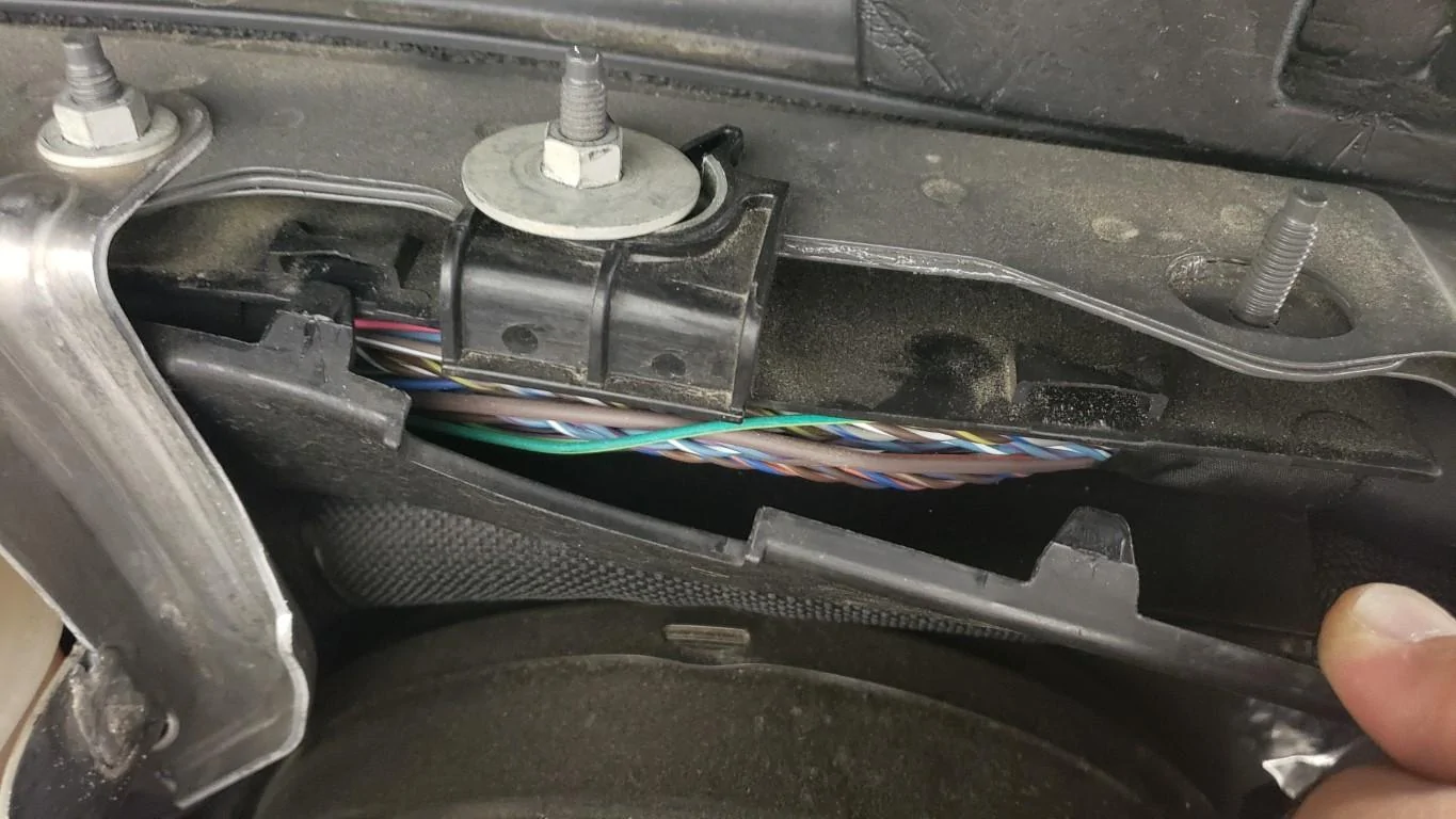

I am working on running amp wire as well and wondering if someone can confirm before I cause issues.
I am coming off the battery to cross over to the easily removed plug near the brake booster. I found that there is a wire loom conduit at the top of the firewall that runs all the way left and right. Inside are some twisted wires.
So the question is will having a 4 gauge 12 volt amp power wire in this area cause issues with some of these wire functions? Any interference
Jeep Gladiator Amp install - fuse and ground question Jee
likely to occur? I do not know much about Can-bus and assume that is going on in this loom area.
Thanks

I don't believe your power wiring in that channel will interfere with anything and I don't think any wires in that channel will interfere with your sound equipment. I would be cautious running antenna cables carrying receive signals or high power transmit signals bundled with the other wires. I've run some low power 14ga 12v wiring in that channel with no problems.
