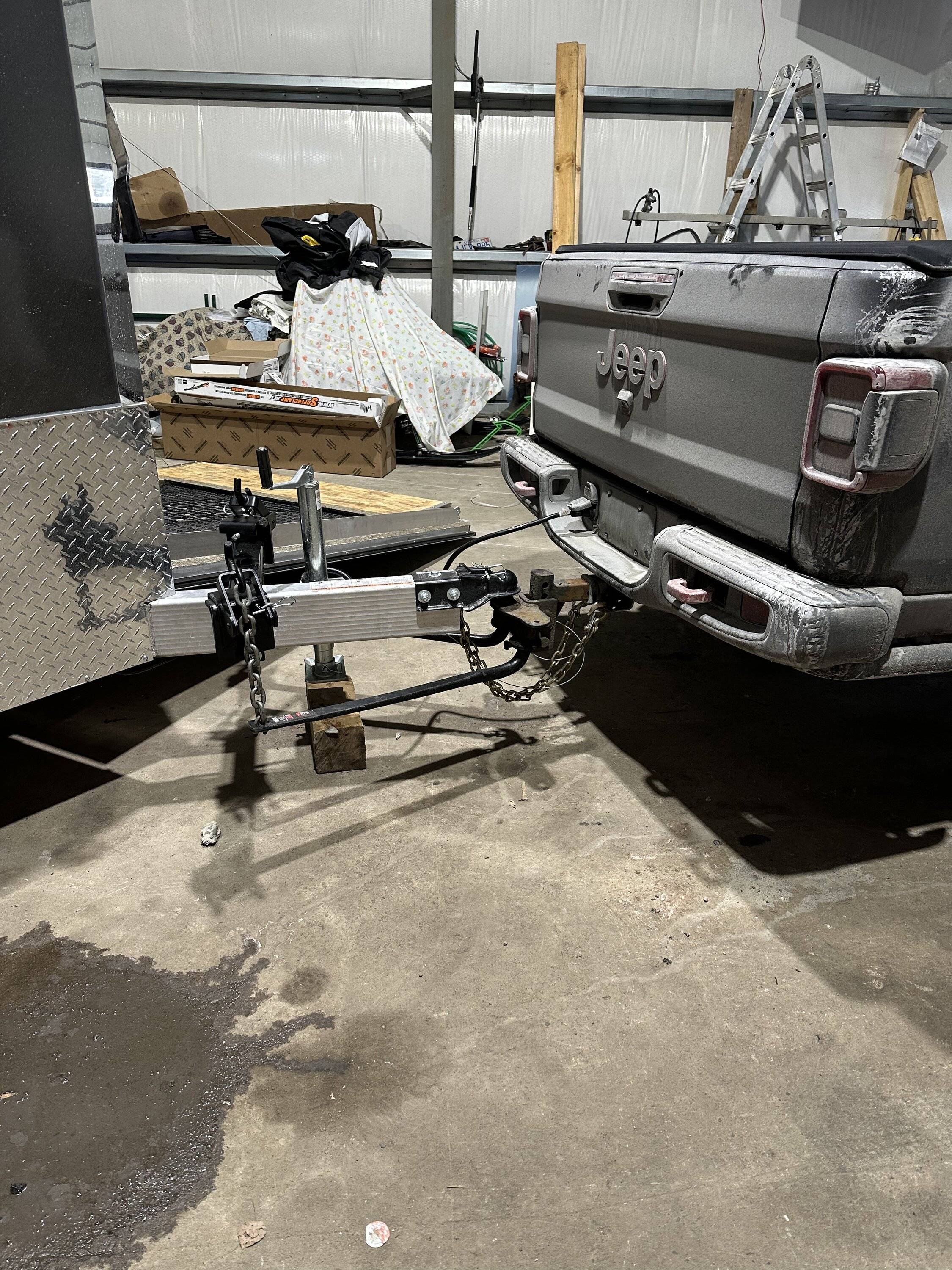

Yes, we use the BlueOX SwayPro and it does an amazing job keeping things level and preventing sway while still being incredibly flexible and plush.
A lot of weight distribution designs on the market do an excellent job at leveling the vehicle but are incredibly stiff and give an unpleasant/harsh ride — BlueOx seems to be different in our experience.
Our setup is utilizing the 1000lb spring bars.

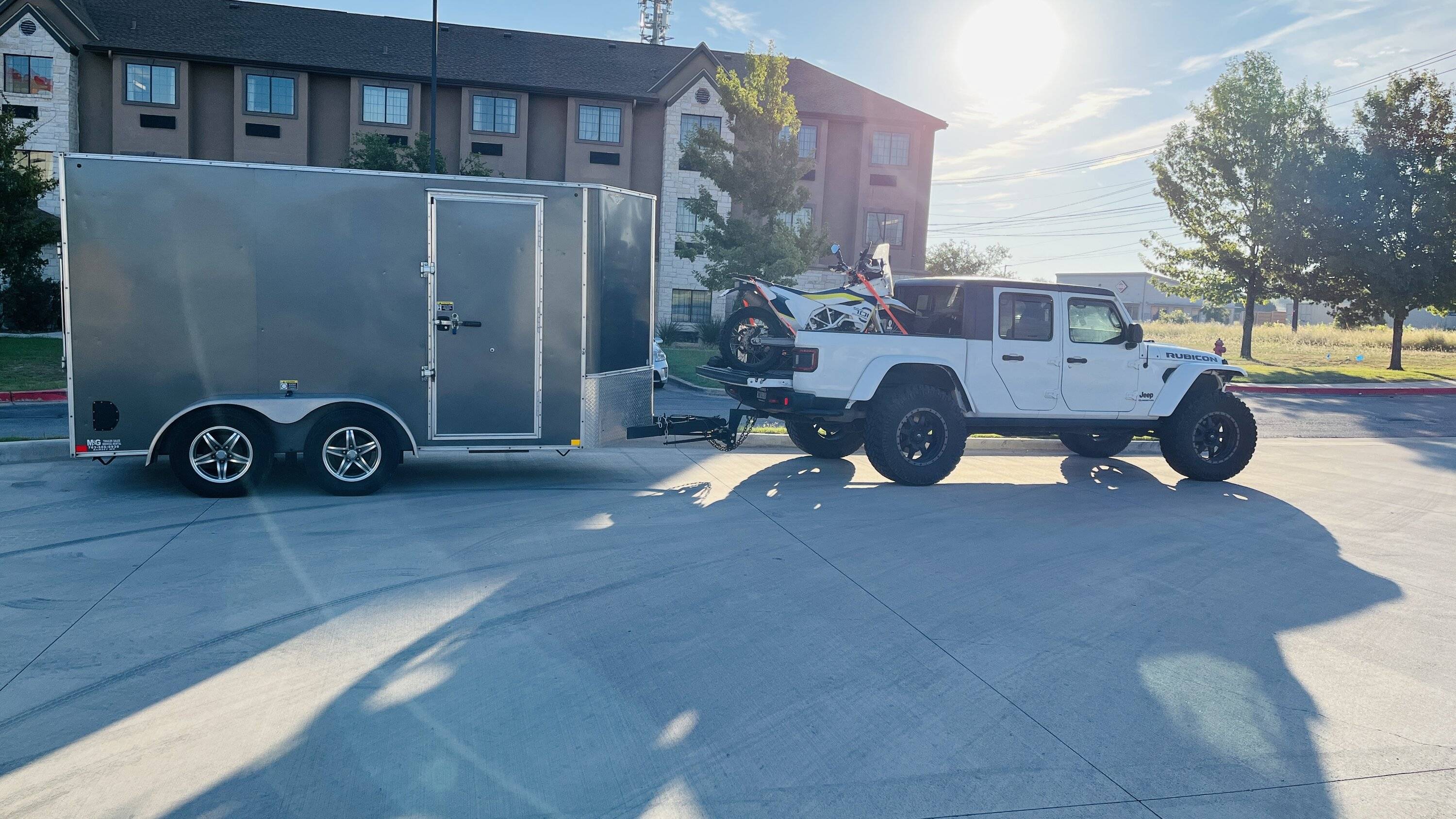

I tow a 23 ft aluminum trailer I use a weight distribution hitch on it , curt, 500 lbs bars and also have Firestone bags in the rear coils to take the bounce out, I only tow sleds in it 3 of them, total weight including trailer is around 5300 lbs but it is a high trailer Needed the hight for my sxs in the summer
