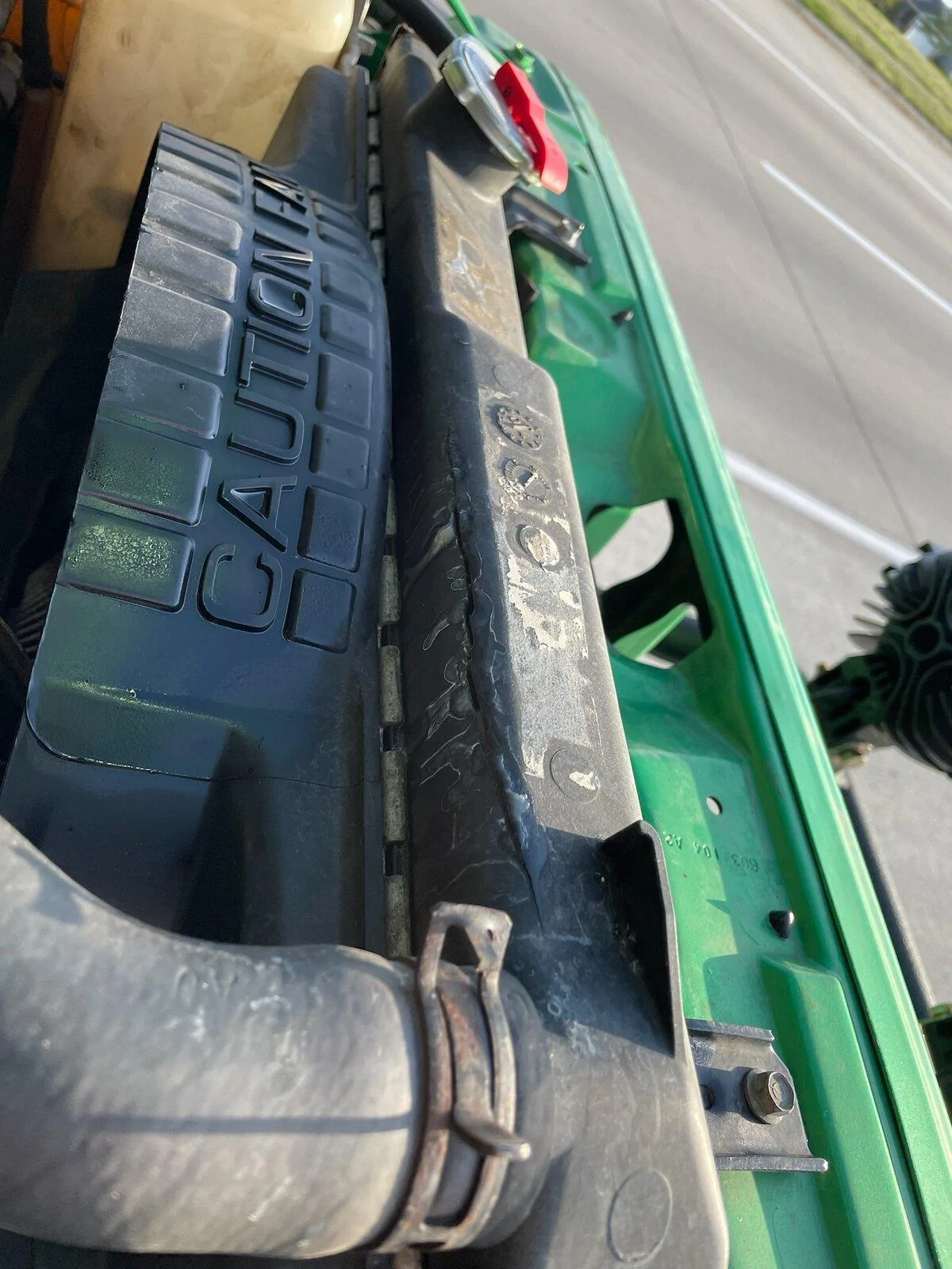

Summary -
First - thanks to all of those who have helped, offered help, provided suggestions and information.
I had to filter some as - well, you don't know my brother. Love him like crazy, but........ he seems to try really hard to not put a wrench in his hand these days. I suspect there's some reason behind that as he used to be pretty good with cars and is a long time Jeep guy.
So I had to make it simple for him and provide him what I did knowing my brother.
I provided options, I suggested he use his road-side assistance of his insurance and have it TOWED for repairs, not drive it with a gash that big across the top of the radiator tank.
I told him where he could find or source one - told him the Jeep dealer out his way two not far from him) may be able to get him one - but at a higher price.
I was careful with that because his business recently went through a hostile take-over and he lost a lot and covid almost killed what was left of that business - he's used to Champaign and tropical vacations. But, even with his income really down, he still doesn't like cheap or risky and wants things done nice.
I think he's good to go now.

Isn't that price difference goofy? There's almost nothing to the auto version other than a simple basic cooling coil in the bottom tank.
I gave my brother the info - I said do a new radiator, don't mess with it - new hoses, new cap, new stat and said he could contact Advance, etc. or a Jeep dealer, his choice, his money.
So I think he's got enough information to make a choice now. I told him GET IT TOWED (on a truck) don't drive it!

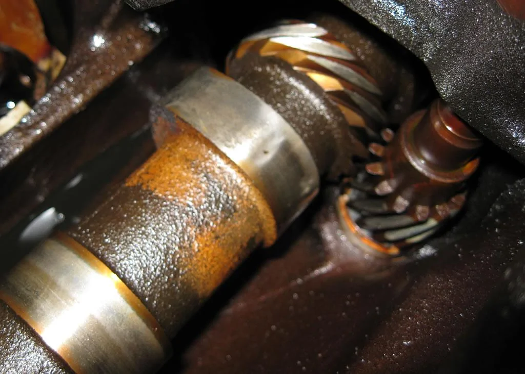

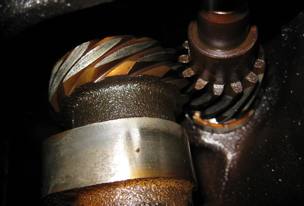

The 4.0 in my SX4 had 100,000 miles on it when I got it. What was left of the oil came out thick and VERY black - I mean black. I did a complete rebuild and it's been fine. Luckily the crank polished up at .010 under and I found .010 bearings for a 258 and filed new notches in the 4.0 rods to line up with the 258 bearing tabs.
I've wound it up a few times, but not for long periods.
This is what happens when you don't change oil, or use poor oil, etc. - I put a comp cams xtreme 4x4 cam in it anyway and had a NOS 4.0 distributor sitting on the shelf.......

My advice change it all out. I have an 03 TJR that developed a leaking radiator around 100,000 miles. I too am on the TJ forum and took the advice of some very knowledgeable people from there. Replaced my radiator, fan clutch, water pump, thermostat, gasket, radiator cap and fluid. All with Mopar equipment. As previously stated the Mopar parts lasted 18 years, 100,000 miles and you can’t trust other aftermarket parts like you can OEM. I’m no mechanic by any means but the 4.0 is easy to figure out when it comes to the cooling system. Before changing this all out I had heat soak a few times and would see tempts reach 220-225. Since the change ( roughly 15,000 miles ago) my temp stays below 220 all summer day long and no more heat soak. 4.0 runs like a champ still. Keep all the fluids fresh and the 4.0 should last a long long time.

I told my brother to not mess with a radiator shop, get a new radiator, replace both hoses and the thermostat. Coolant is a given since all of his blew out and he ended up putting water in to limp it back home. I told him GET IT TRUCKED to a shop.
I had time and space in my shop (I'm going on a year out with work for people now) I'd have done it, I'd have trailered it to my place and done just that - rad, hoses, stat, etc.
The thermostat on this is among the easiest there is of any engine - it's right up front, 2 bolts, simple to get to. Even easier than the V8s I work on. Upper rad hose and heater hose. That's it.
