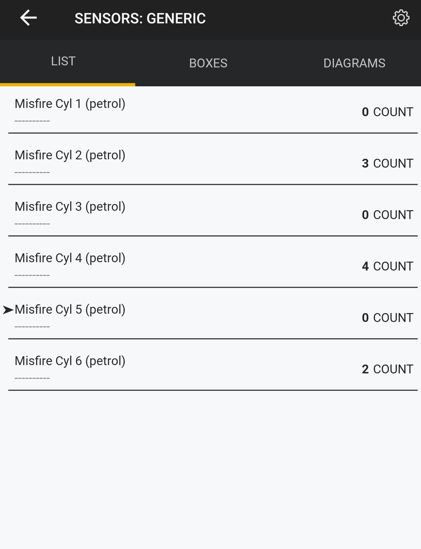

my 3.6 JT has vibration after cold start .and Jscan catch misfires from #2,4,6 cylinders. no vibration when engine is hot.
anyone have same problem here?

Because i thought small amounts of misfire count is normal. this pic is right after cold start. it's almost under 10 misfires so ..

How cold is your ambient temp when starting?
I assume it just started doing this?

Also, there have been a couple of computer updates on these.
The first was Z37 and then there was another one after that.
Have you had those performed?
