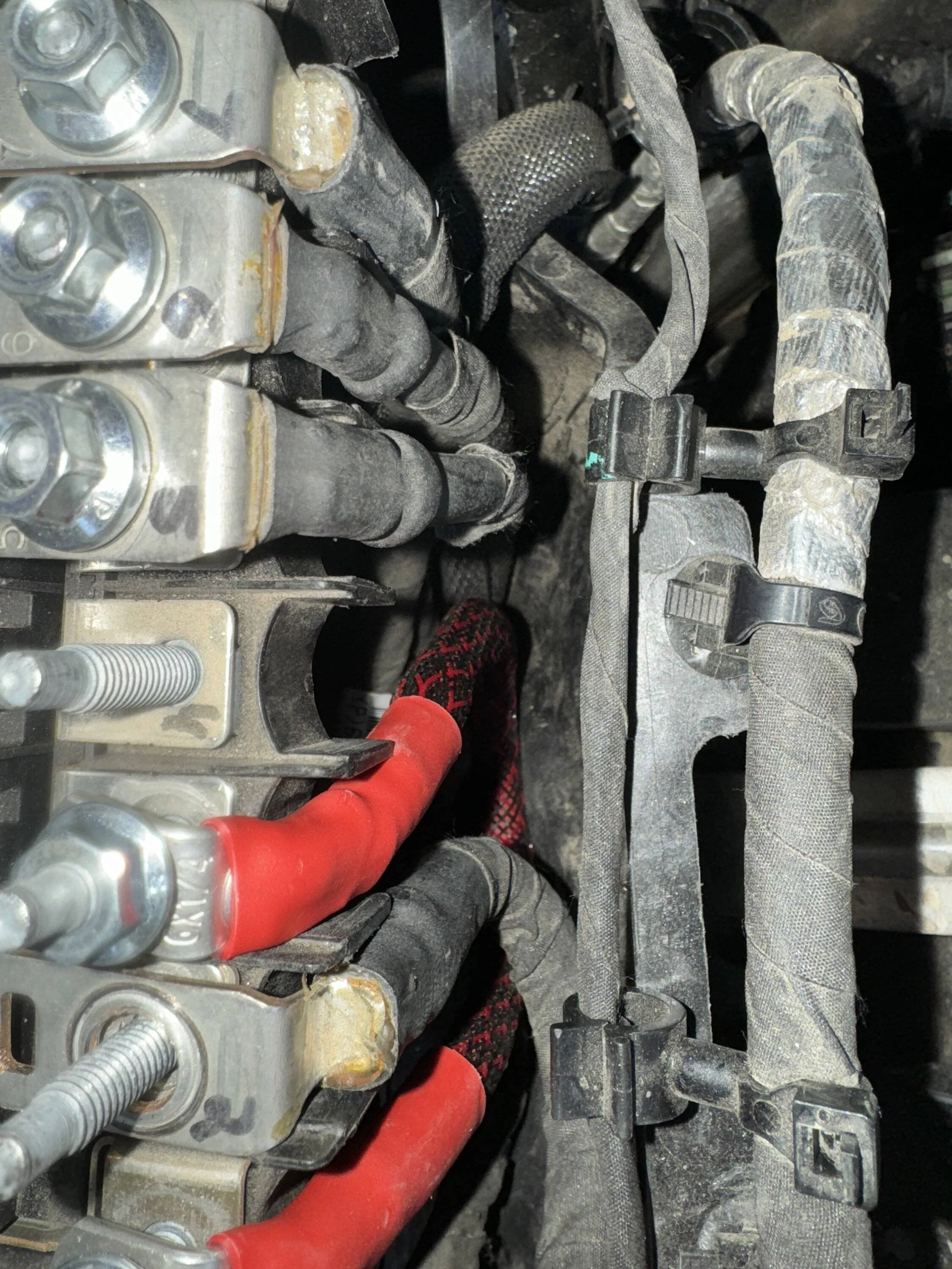

Anyone have Pics of the N1 to N3 Jumper when deleting th Aux battery?

The aux. battery powers electronics when the Electronic Stop/Start system is active. I disconnected my ESS as it was very annoying. It is my understanding that In order for the systems that are powered by the aux. battery to keep being powered by the main battery after the Aux is removed, you need a jumper wire on the fuse block so that the terminal that "was" powered by the aux. battery will now be powered by the main battery.
Thank you!
