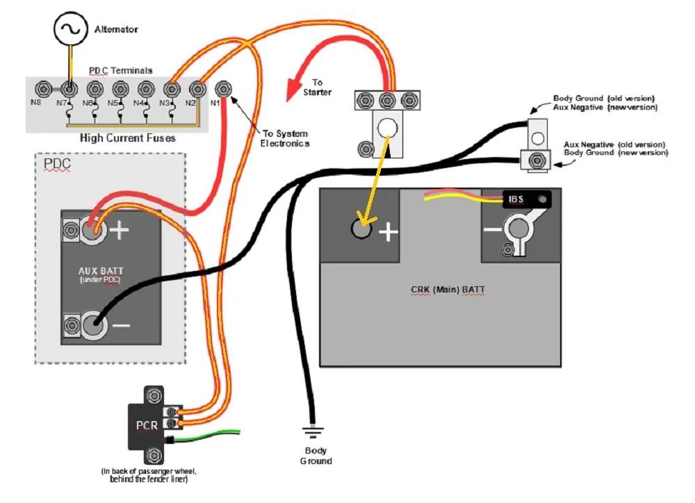

For the lurkers - this is very incorrect.
Our Jeep batteries are in parallel.
Your remote batteries are in series.
Our Jeep batteries are always connected together except during a brief moment when starting or during an ESS event..
Your remote batteries are not connected electrically as you have not pressed a button so there is no complete circuit.
In parallel, if the battery on the right has a "short" or debris has sloughed off and settled completing a circuit from + to - then it will drain the battery on the left.
If EITHER one shorts or the resistance drops dramatically, usually through age, mis-use, deep cycling, etc. then it becomes a load directly across the terminals of the other battery.
These are in parallel - (our batteries are in parallel when sitting and the engine is running)
It's NOT common, but can happen. And it can happen EITHER WAY. main can fail draining the aux, or the aux can short and drain the main. If this is caught and the bad battery replaced, it won't necessarily ruin the other battery, just drain it. It's still possible it's ok. Draining a battery one time doesn't ruin it - but it does drop capacity and shorten life. This is why some Jeep owners have replaced ONE of the batteries and moved on. It all depends on the depth of drain, speed of the drain. It's like leaving the headlights on on an older vehicle - it DRAINS the battery but doesn't necessarily ruin it. Draining a battery one time will not necessarily ruin the battery - it does it no good, of course.
Jeep Gladiator DIY How-to: Take the Aux Battery Offline 1690728757217
in series that's not possible as there's no complete circuit across the terminals of either of the batteries through the other battery -
Jeep Gladiator DIY How-to: Take the Aux Battery Offline 1690728980746
Follow the yellow/orange path and note that the positives are connected together through the PCR and high current fuse.
The negatives are tied together directly -
Jeep Gladiator DIY How-to: Take the Aux Battery Offline alt-battery-charge-paths
