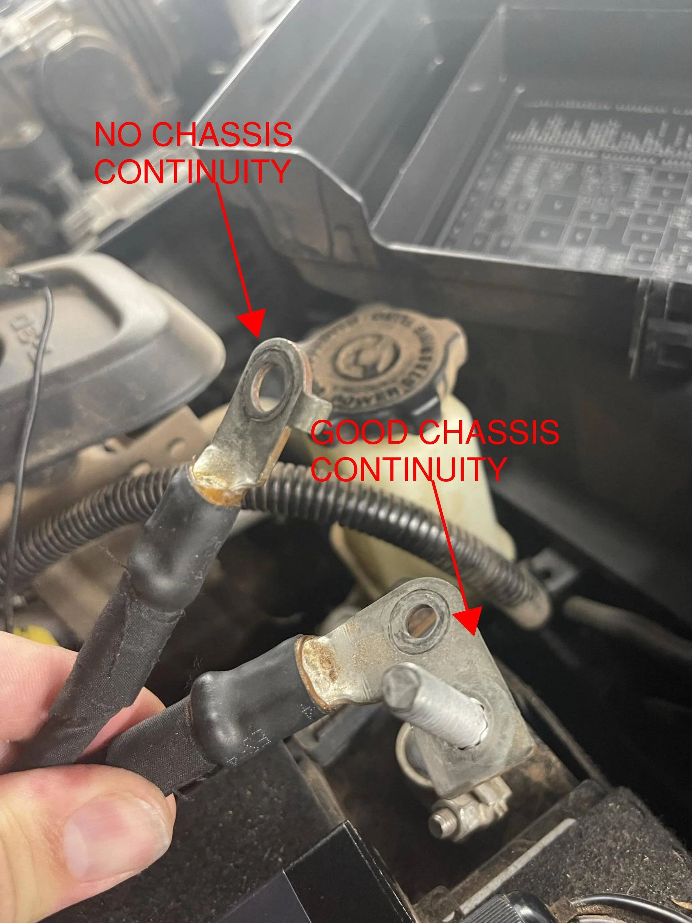

So I followed these directions exactly. However, no power to the truck now - as if there was no ground reconnected at all. So i did a continuity test and found that the main ground has no chassis continuity at all. The other does. So when I connect it back to factory stock, all is good. When I disconnect the main ground and leave only the aux ground, all is good. When I connect only the aux ground, I get nothing. Any ideas?

So… the issue still exists. Yes, that cable has continuity to the chassis. But when it is connected to the battery without the aux battery cable cable, continuity is interrupted and nothing has power. It’s very odd. When I connect only the aux neg everything has power and the truck starts. When I connect the main ground and an additional cable from the ground post to the chassis, I get power to everything but not enough to start the truck.

The ground cables were switched in 2021. For 2020 models, you want to do the opposite of what his video shows. The one with the post is the one to keep connected.

Yup - 2020 has the small ended cable on top of the other going to the aux. 2021 and later have the bottom cable, the one with the big end with the stud going to the aux battery.
So what you disconnect and tape over depends on the year - 2020, or 2021 and later.

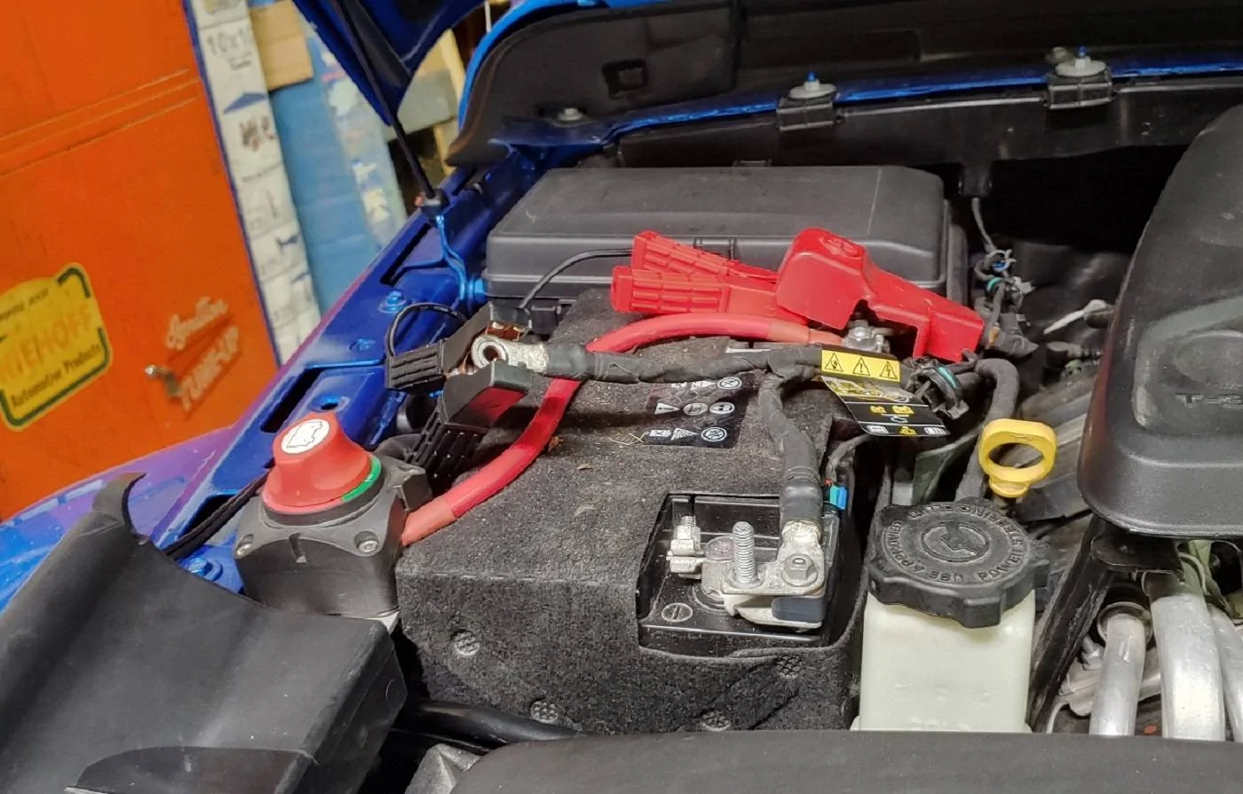

This picture is a 2020 and I'm charging ONLY the aux battery. The main battery to ground cable is still on the IBS.
For 2021 and later, the cables are switched - the one I have the clamp on is the chassis ground and the one still on the IBS would be the aux bat ground cable on a 2021 and later.

Just a quick update. Yep, the reverse works. Thank you for the heads up!

From the detailed descriptions on the YouTube video -
"Jeep inexplicably changed the ground cable configurations in 2021 around mid year, so depending on which side of that change your vehicle was built, it could be the larger cable or it could be the smaller one. If you remove one and there's no power, simply swap them. "

Worth noting - Jeep inexplicably changed the ground cable configurations in 2021 around mid year, so depending on which side of that change your vehicle was built, it could be the larger cable or it could be the smaller one. If you remove one and there's no power, simply swap them.
