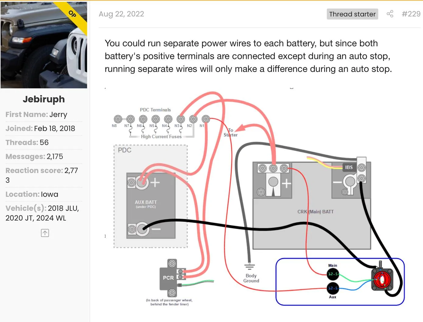

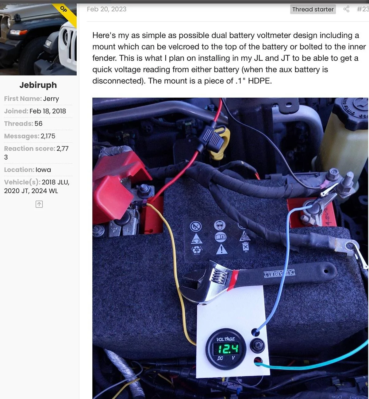

Here's a link to my simple dual battery monitor using 1 volt meter and a dpdt switch. https://www.jlwranglerforums.com/forum/threads/ess-dual-battery-management.60034/post-2266434
Open the hood and get both battery voltages (aux battery has to be disconnected).
Looking at your aux battery monitor solutions, I’m wondering if you can use the spdt switch between the crank battery and N1 and keep the ground common for both, so you do not have to separate the grounds to get the volt reading for each battery…
my other question is - can the PCR be activated remotely to allow the separation of the batteries - im assuming this would allow the gauge cluster to display the aux voltage as it does during a start/stop event, but also to allow a separate gauge to give the crank battery voltage at the same time…
