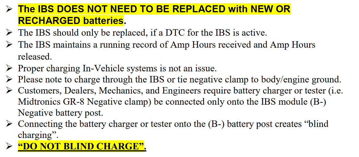

BTW, for any of you other clueless wonders like me who don’t know what IBS stands for. I had to Google it: https://www.jlwranglerforums.com/forum/threads/3-6l-ess-ibs-information.22585/
Only install the IBS on a fully charged battery.
Always fully charge a new battery BEFORE installing.
Reset the IBS (leave it disconnected for at least 10 - 15 minutes) before reinstalling on a freshly charged new battery.
When charging in-vehicle batteries, charge through the IBS, not directly to the negative post.
The last part of those bullet points has me a little confused.
It says ". . . requires charger or tester to IBS (B-) post"
Next one says "connecting to (B-) creates "blind charging"
and last says "do not blind charge"

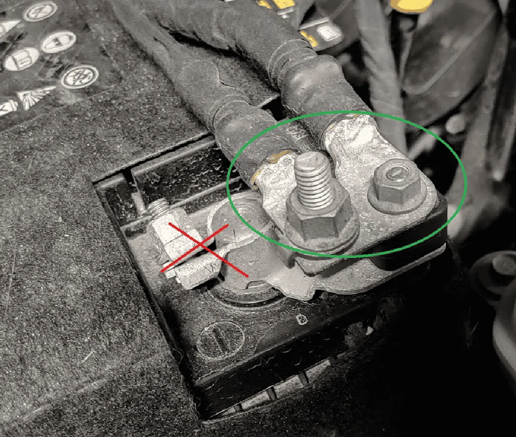

To simplify things, the diagram below is from that earlier IBS link.
In that view would I clamp the negative from the tender to the Main negative to get it to run through the IBS correctly?
Connect a charger or tender to the stud (as in the green circle)
Not to the area with the red X (not to the negative battery terminal or the IBS clamp on the battery terminal)
excellent!!
Big difference between the two.
Thank you
