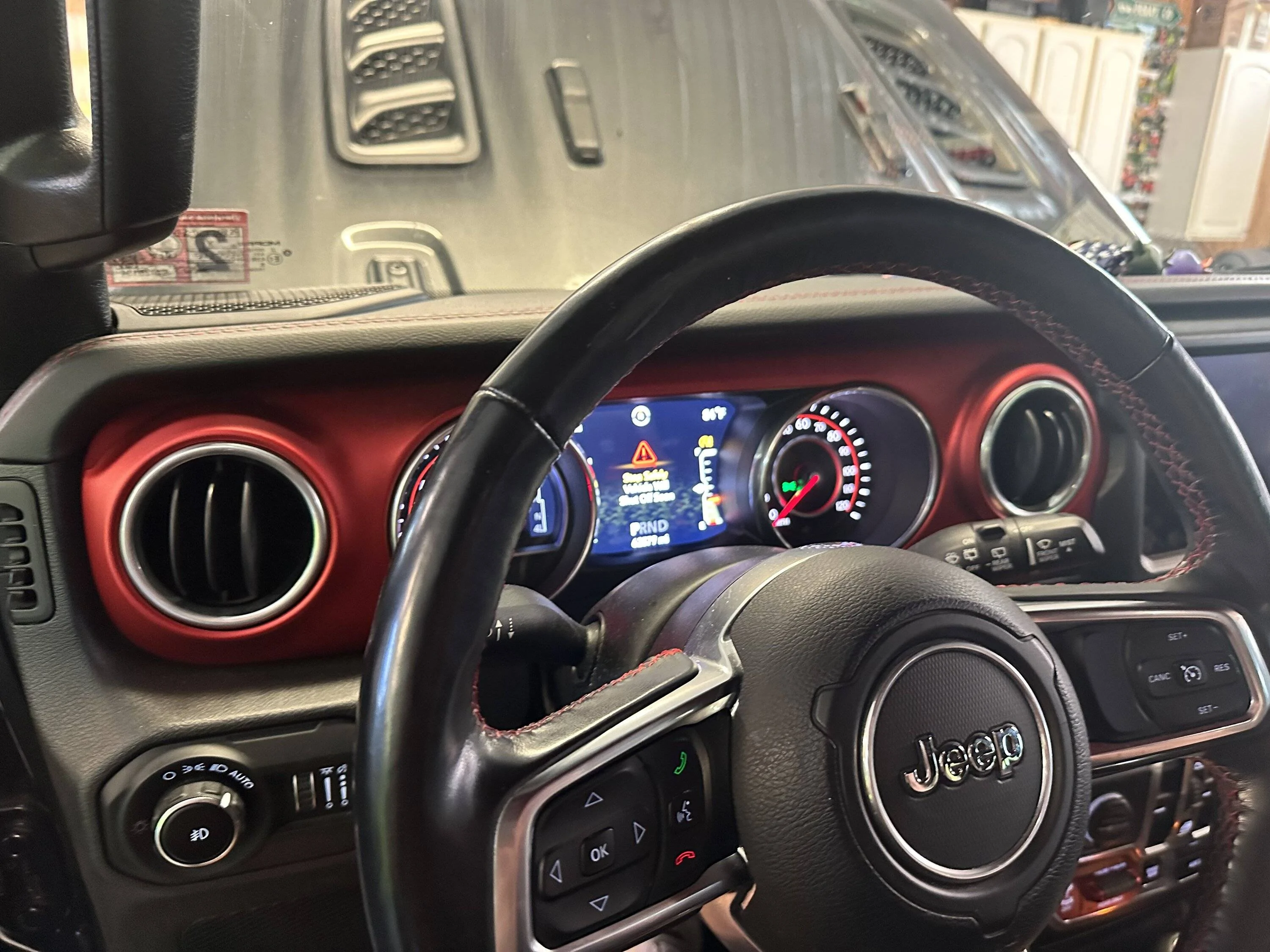

I have the original batteries in my 2020 JTR that I bought in May 2019. I started to get the S/S unavailable message a few weeks ago and it never went away so I decided to do this mod. I did it this past Sunday and everything was working fine until this morning. Today when I started the Jeep I got the auxiliary switches unavailable, this was the first time I got this message. I also got the S/S unavailable battery charging message. So now my question is why did I get both of these messages after doing the mod, when I only got the S/S unavailable message before. I know I'm probably on borrowed time with the age of the batteries, so I'm going to bite the bullet and replace both. Next question is which batteries to buy? Any opinions on the Duracell batteries available at Sam's Club?
What's your voltage? Your main is probably close to dead too.

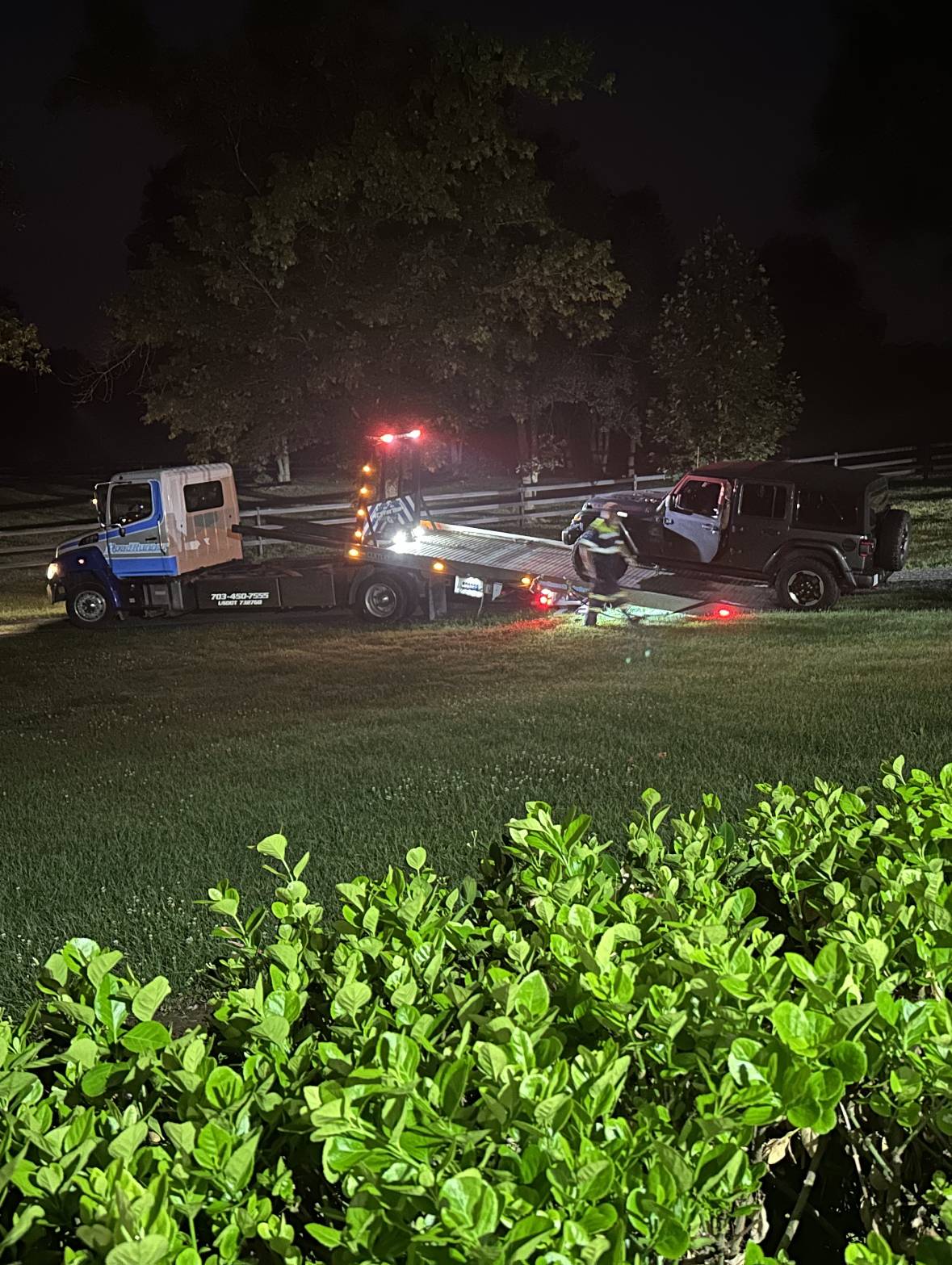

I am surprised there is not class action or investigation going from NHTSA for this small aux battery setup. You are left stranded when the aux battery goes. Sometimes the Jeep will shut itself off and this dangerous in middle of highway or blind turn.
Have yet to see this. Can you point me to where this system shut off a vehicle in-motion? Sounds more likely that, if it did happen, it was something else that occurred and it was just blamed on the ESS system because the convenient group think is to make that the enemy.
On top of that you can’t conventionally jumpstart this vehicle. If none of the workarounds get Jeep started, you have to wait for tow truck.
Sure you can. I've done it myself. What makes you think you can't? Let me guess, it happened once to someone and, right or wrong, that person blamed ESS?

Have yet to see this. Can you point me to where this system shut off a vehicle in-motion? Sounds more likely that, if it did happen, it was something else that occurred and it was just blamed on the ESS system because the group think is to make that the enemy.
These ESS/battery threads are easily worse than the oil threads now, with the amount of misinformation and poor understanding circulating in them.
google/YouTube have many examples of dead on side of road. A dead aux battery will also kill your main battery. You also can blow your Z case fuse Array if you incorrectly try to jump vehicle.

I can show pictures of a Jeep being jump started. That's about as useful as a picture of one on a tow truck.
This is asinine. Remove your aux if you want. Nobody cares. Demand that NHTSA opens an investigation. They won't. Find echo chambers that parrot the same bad information over and over. Won't change the true problem: it's the crap factory batteries, not the ESS system, that are the problem.
