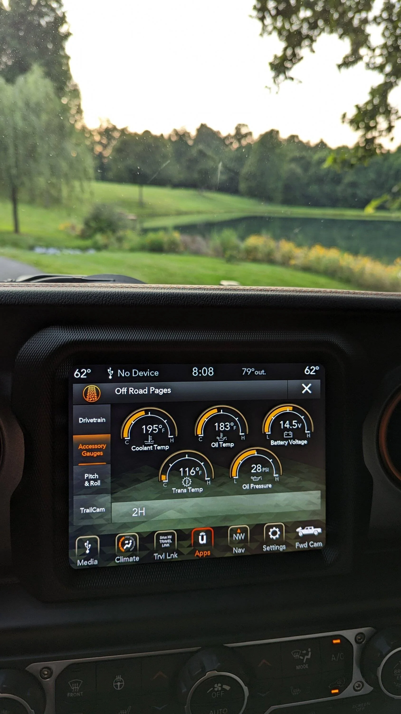

Here's what I meant by subscriptions and themes after 24 hours.
Yesterday I didn't have Off Road Pages or Travel Link. Probably some others too, but I use those the most.
Today everything's back.
