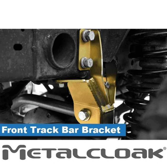

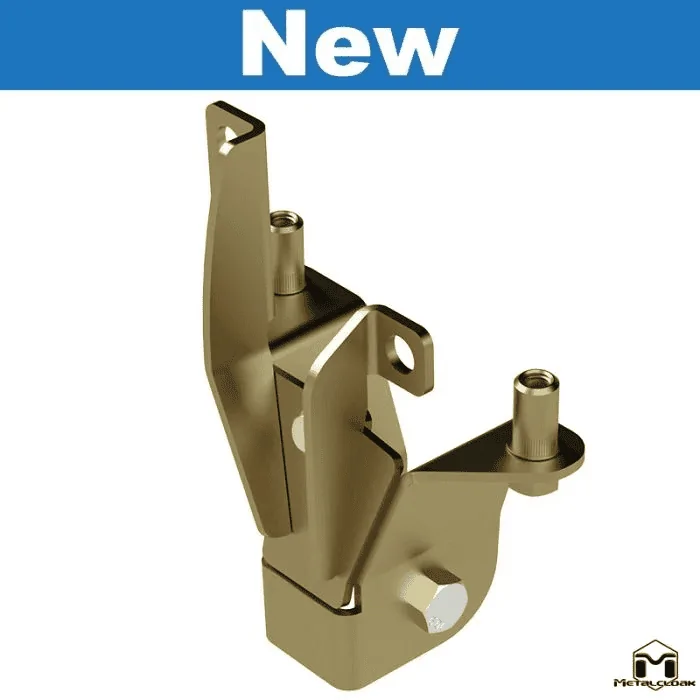

I'm looking to beef up the track bar mount on my truck and saw that Metalcloak is offering a bracket now that looks very strong. Anyone try it out yet?
I have one sitting on my desk.. I'll get it installed sometime soon. The JLWranglerForums has a pretty healthy thread on it already. Positive reviews.
