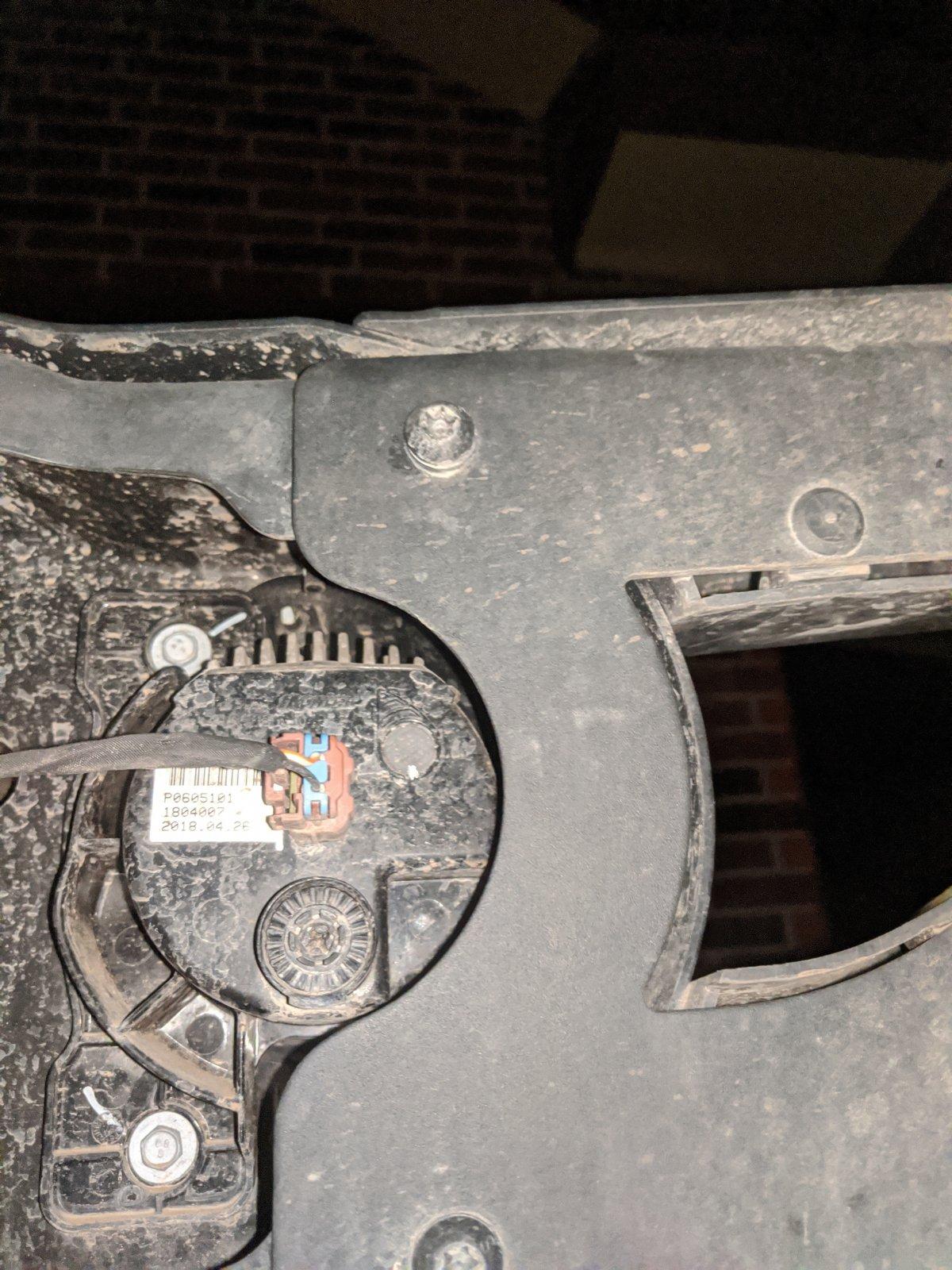

So I found out that the steel bumper I purchased on craigslist is a 75th anniversary bumper. Primarily the reason I've been having issues. Someone pointed me to these brackets over on quadratec's website https://www.quadratec.com/p/oracle-...jl-gladiator-jt-factory-steel-bumper-5857-504
I went ahead and ordered them. When I got them I noticed that the bolt holes didn't line up properly with the LED fog lights. I returned the brackets and got a refund. I started checking out RubiTrux's website and came up upon these brackets https://www.rubitrux.com/maximus-3-jw-speaker-wrangler-jl-gladiator-jt-fog-light-brackets-pair.html
I ordered them, got them in last week and installed the fog lights to the bracket. Awesome right! wrong! I went to go install them on the jeep and realized the bracket is too big :angry: . I almost gave up and just ordered a pair of LED fog lights from RubiTrux's website --> https://www.rubitrux.com/2017-10a-hard-rock-mopar-led-fog-lights-68304048aa-68304049aa.html
So I ended up cutting up the bracket...

I still need to cut the tabs on the other side of the fog light in order for it to properly fit. I'm hoping I can get this done tomorrow. I'll post an update here.

**UPDATE**
Finally got my fog lights mounted properly by hacking the bracket from RubiTrux.
