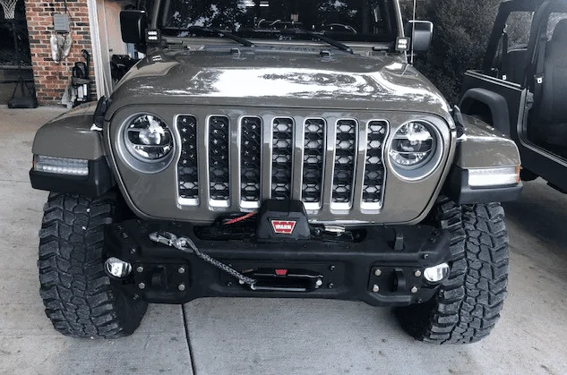

Correct. and not just for JTs. All JL/JTs. For example mine did not come with a steel bumper. However I bought one off a rubicon 392 owner so it had gold tow hooks which I swapped out for my original black ones.
But had it came from the standard rubicon steel bumper it would have had the red tow hooks. The bumper itself is the same,
Only difference is the color tow hooks

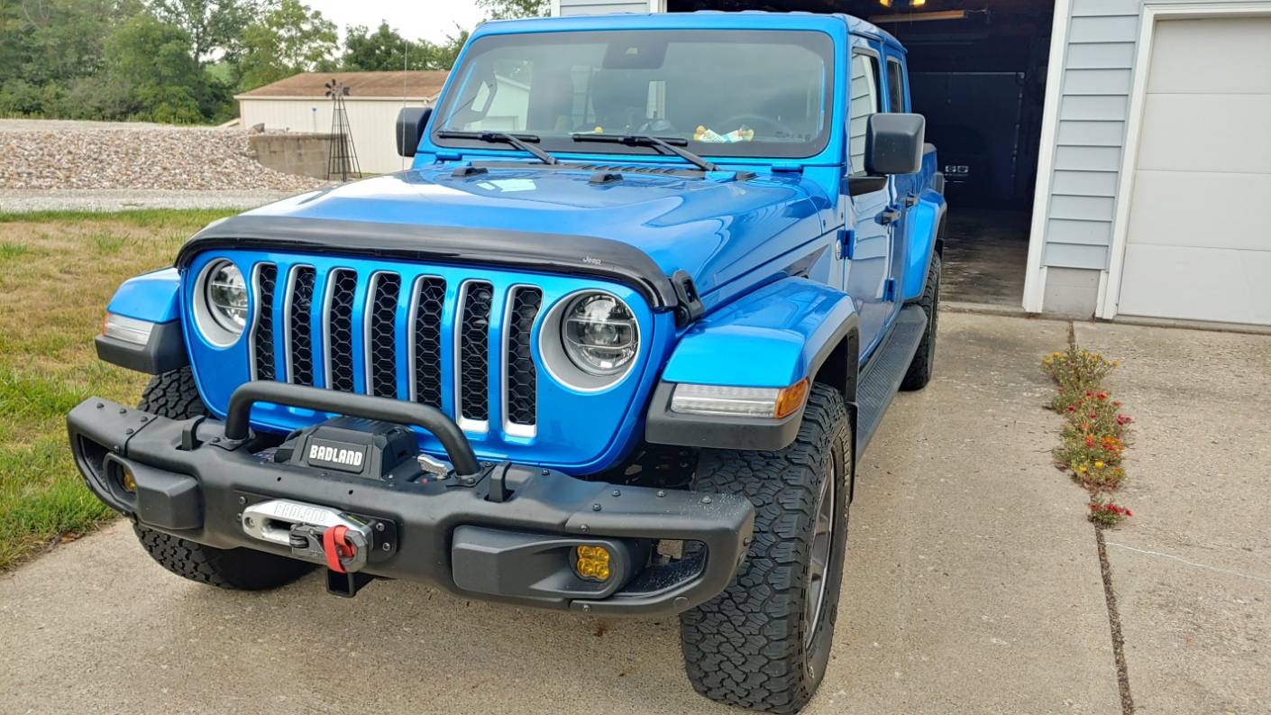

Here is a Rubicon style steel bumper on my Overland ->

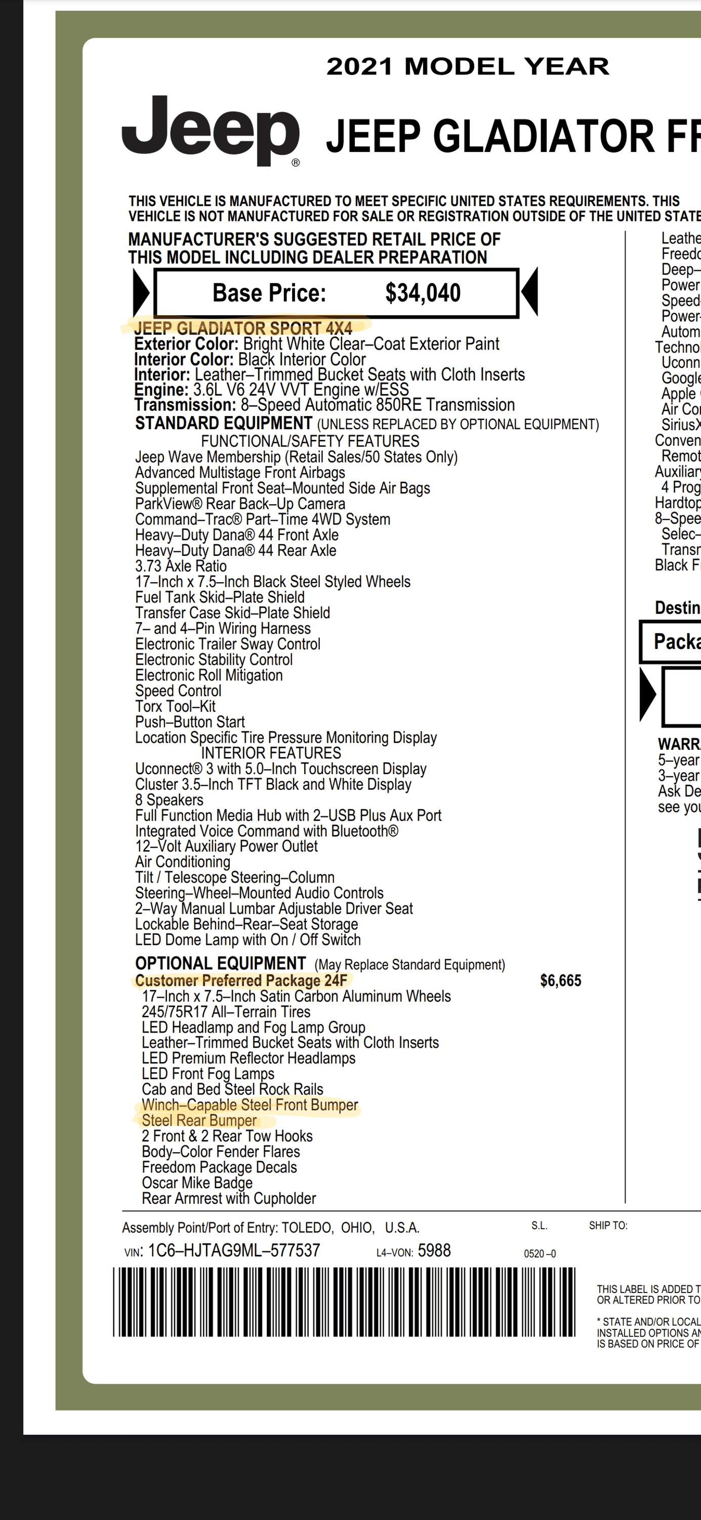

The Gladiator Freedom edition says hi... ?
Freedom edition. No one I know would say "I have a sport", they'd say "I have a FE"
It's like someone with the HA saying "I have an Overland". Yeah, it's based on Overland, but it's the High Altitude.
Look around for anyone with the HA and see what they call it.
Order a Sport and you get plastic bumper with the fender fillers.
Standard equipment is plastic.
40,496
54,011
I thought at one time you could get steel bumpers on certain non rubicon gladiators. Maybe Texas Edition?
Yeah, but you mentioned only Sport.
Order a Sport and get the plastic bumper.
Order a Freedom Edition, for example, and they build a Freedom Edition - based on the Sport, but it's no longer standard and the bumper is part of the FE, not part of the Sport.
Like said - the Rubicon-style steel bumper will fit any JT. For that matter, depending on adapting fog lights, wiring harnesses, fillers, whatever, any JT bumper will fit any other JT because the front horn arrangement is all the same. Same bolt pattern and the frame protrudes beyond the grill basically the same amount on each.
In short - you can put any Gladiator or JL/JLU bumper on any Gladiator.
