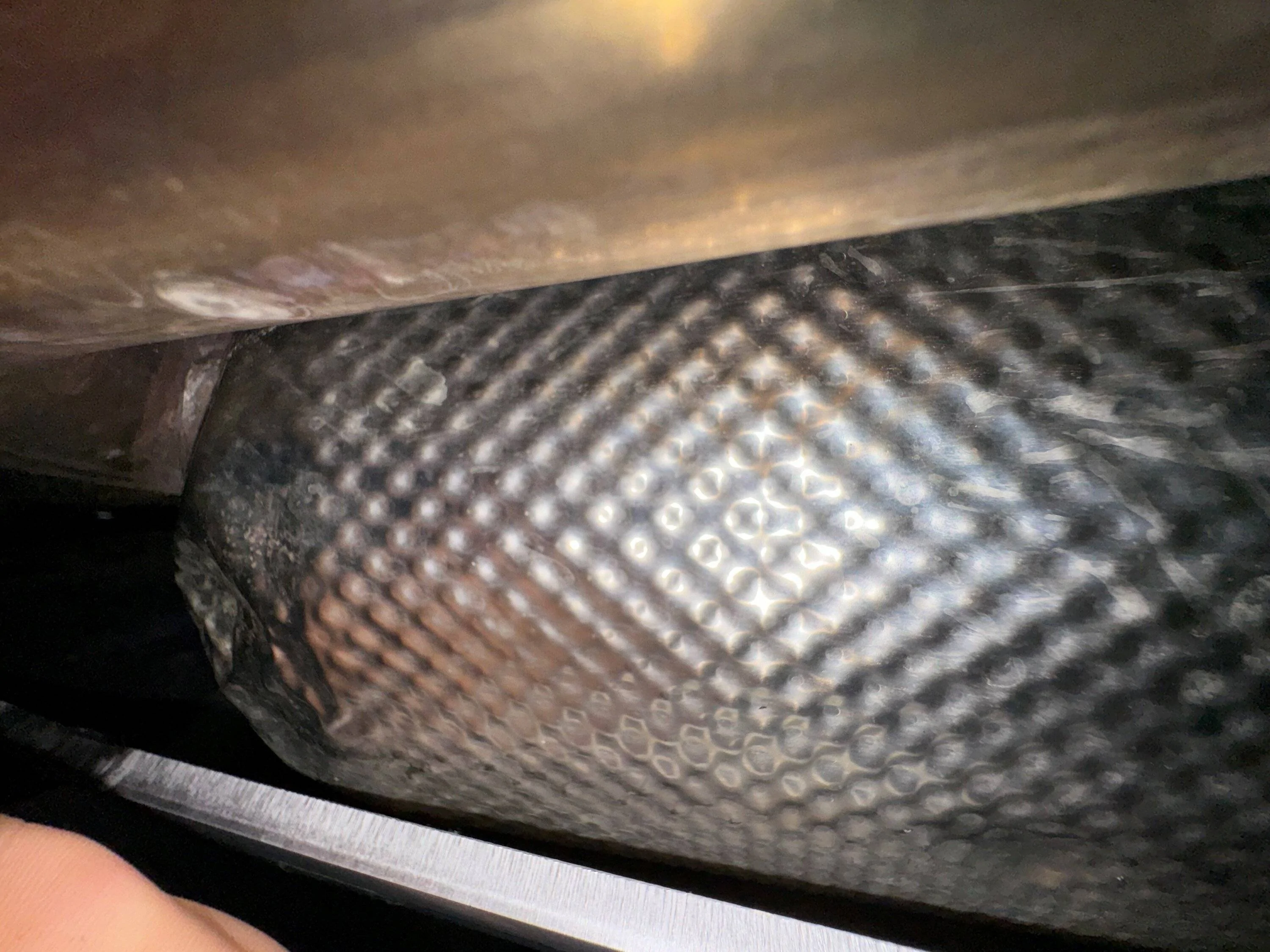

Question @Artec? Just installed the JT4135 on my 2021 JT Rubicon 3.0L Dsl. The clearance is really tight on the engine skid and the catalytic converter. Picture attached looking down at the clearance. Have not had a chance to see if it making contact under torque load of engine. Did your mock ups have the same amount of clearance?
The clearance is really close there on our diesel Jt as well it doesnt contact but its close.
