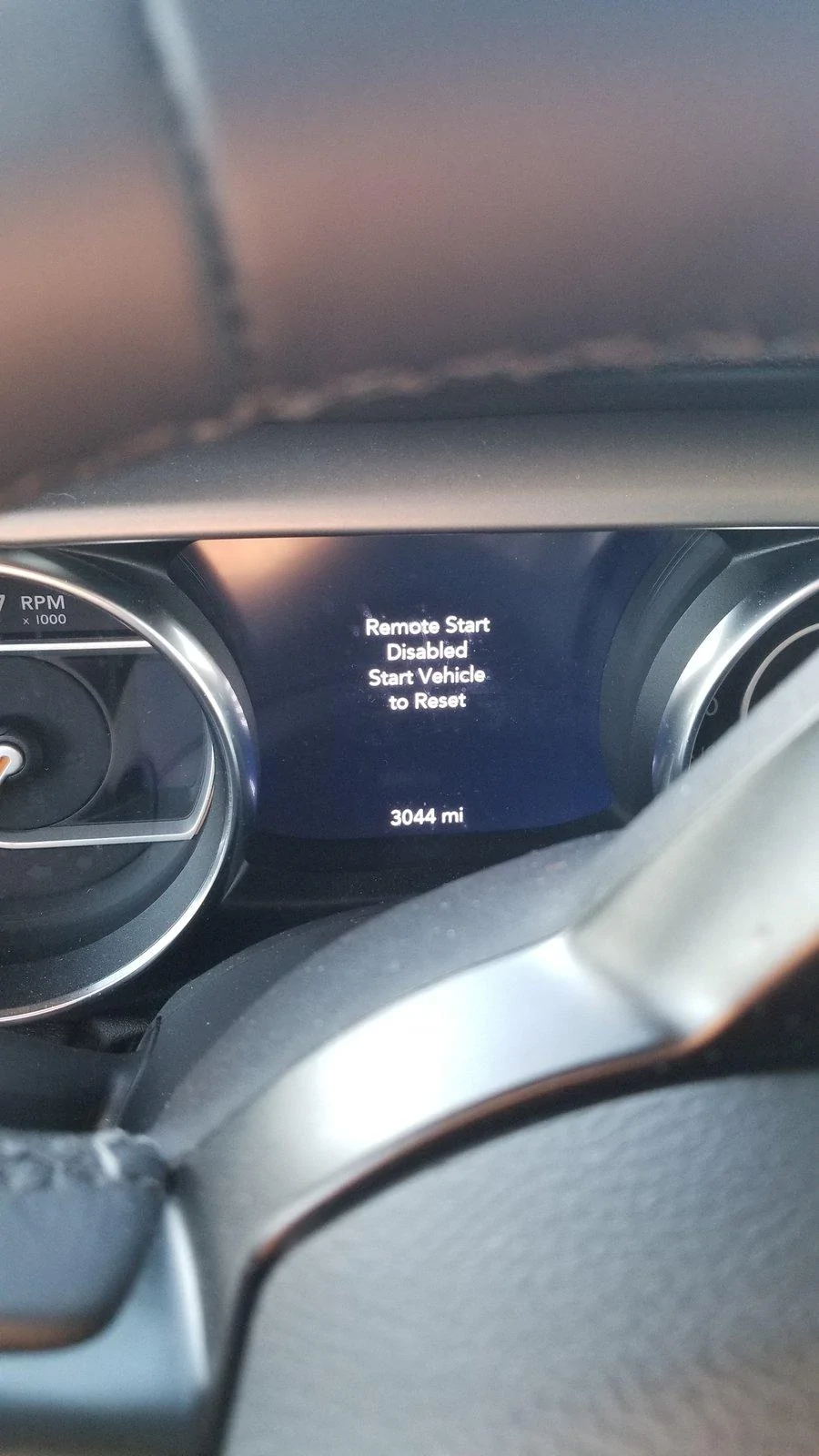

Is it normal after you use auto start to warm up you truck after 2 x for it to not work a third without starting truck? I get this message if I try to run it 3 times .

Are you saying that you are running it long enough for it to shut off the engine, you auto start again and run through another cycle, then on the third time it does this?

Yes, from owner’s manual:
The engine can be started two consecutive times (two 15 minute cycles) with the key fob. However, the ignition must be placed in the ON/RUN position before you can repeat the start sequence for a third cycle.
Ya third time in a row doesn't work.
Ok sounds normal to me then. Thanks thought maybe my tazer messed something.
