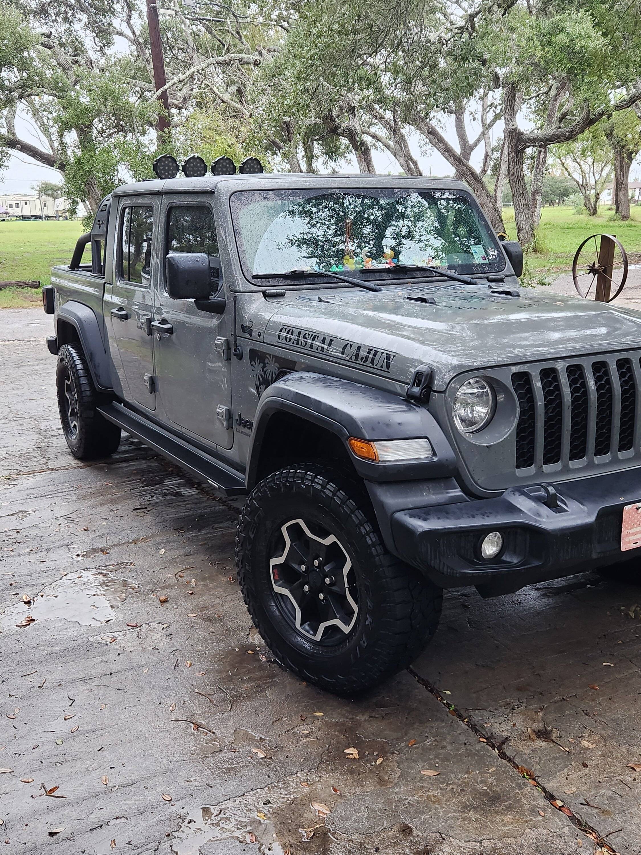

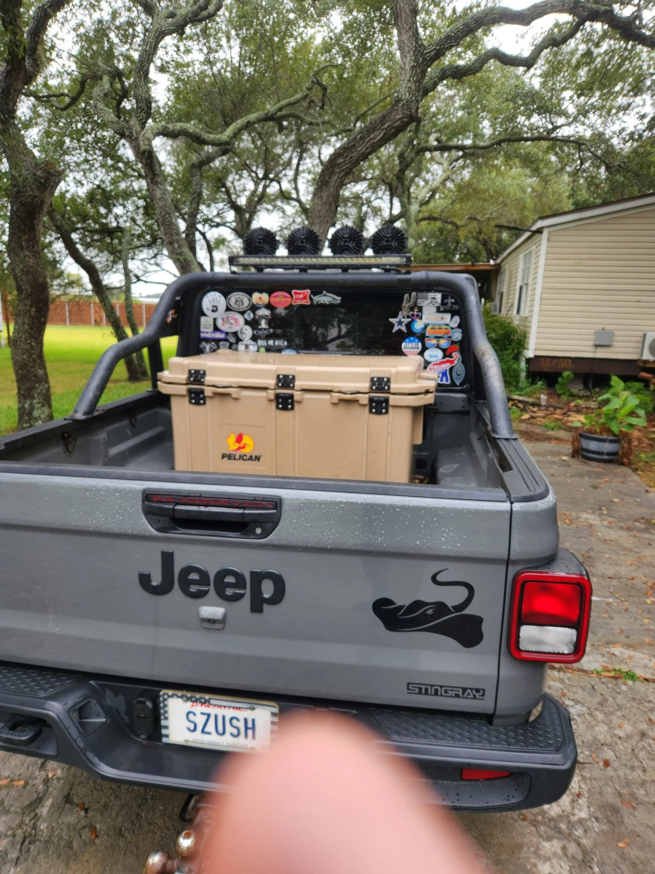

1 put 4 round LED fwd and a 24" LED light bar facing back. Both wired separately to factory Aux switches #1 & #2. Still have 2 open for later with no problems after 3 years . I run all my lights at the same time, on trails

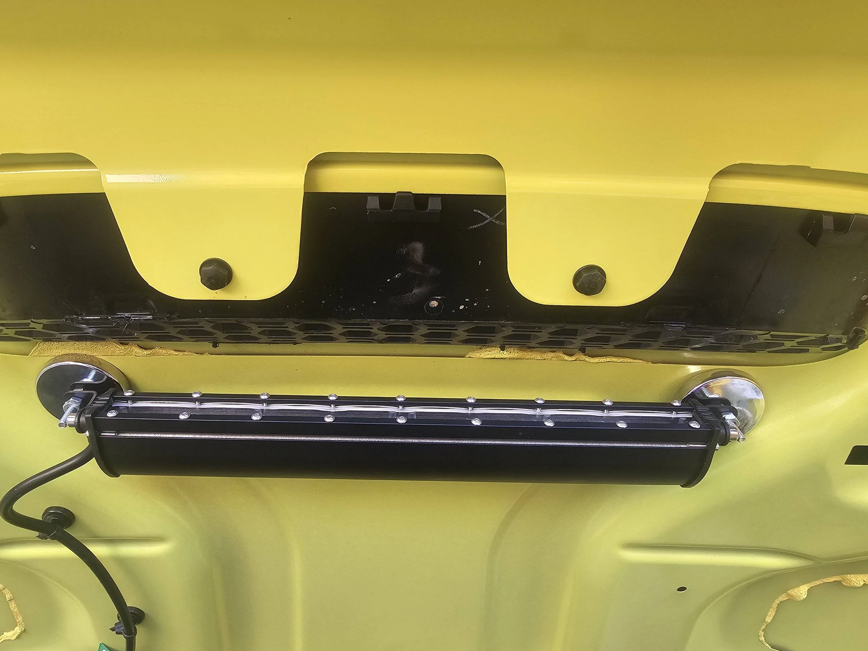

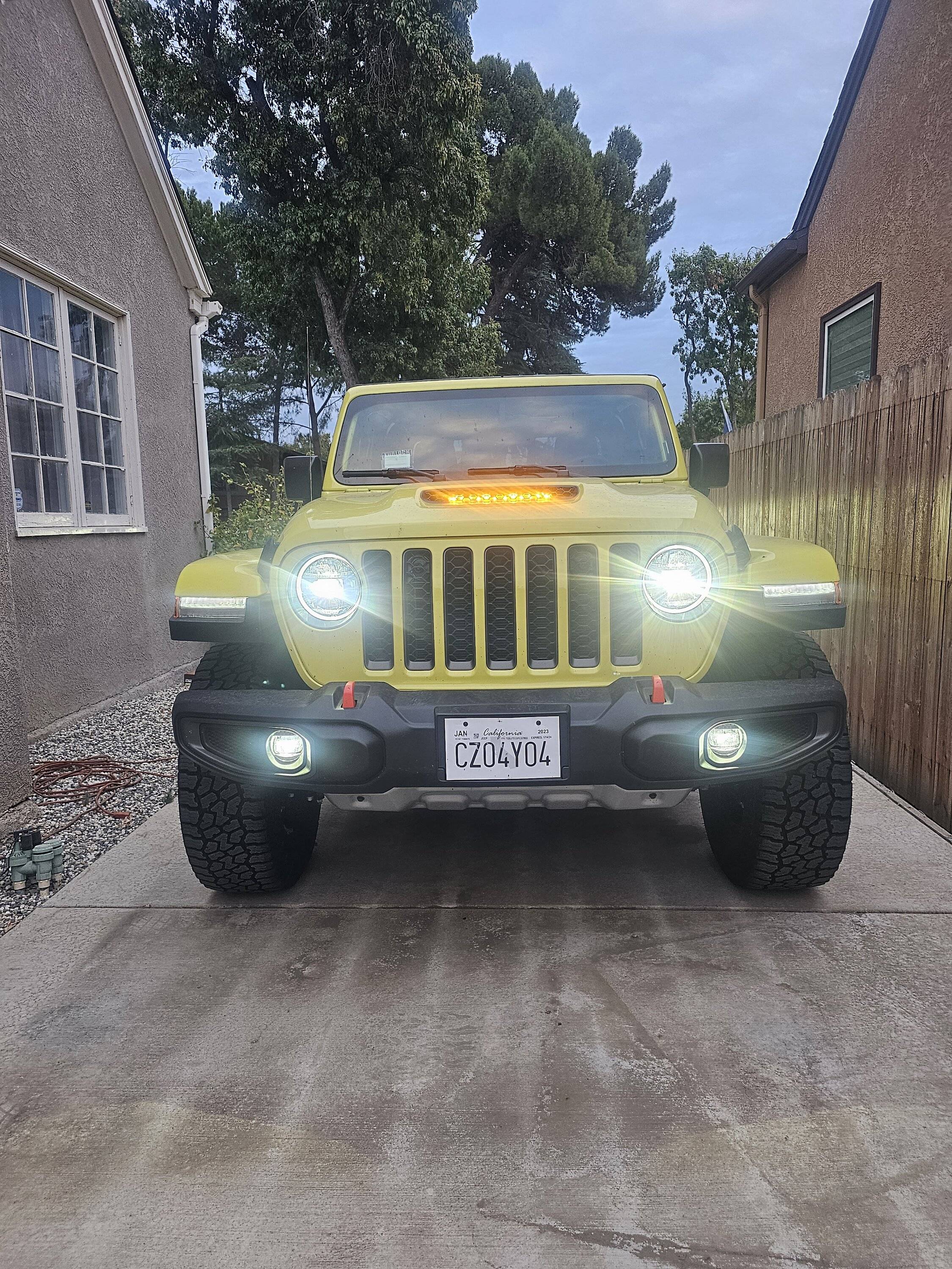

The aux switches are fused from the factory. Safe to wire direct to accessories. I'm only using aux 4 so far but I've only had the JT mojave for 3 weeks. Put a light bar in the hood scoop on day 8.

Very nice. I like the light bar in the scoop as it makes the scoop functional lol. Got a link for that? I've been thinking about adding some type of lighting to the front (light bar, raptor lights which are kinda played out or something else) but have not had time to do a lot of research yet as I have only had my Mojave for 2 weeks. First time jeep owner so I have lots of research and shopping in my near future.

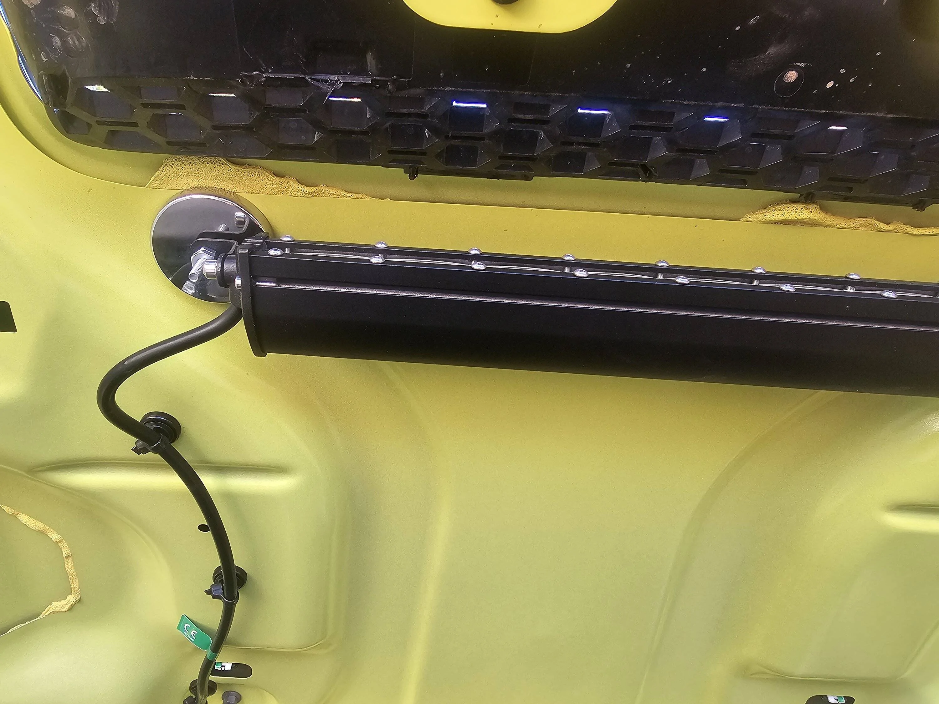

WOW what great engineering with the magnets. Never seen that before on any vehicle. Thinking outside the box. I like it. Thanks
I wanted something sturdy enough to hold it in place and actually drive it around and verify I liked the placement before permanently mounting it. 50lb magnets and they even came with the screws and nuts for mounting. I drove it for a week before locking it in with epoxy and it never moved. Heat will weaken magnets over time so it isn't a permanent solution in my opinion.
Did you get the magnets from Amazon as well? I may have to consider doing this myself.
