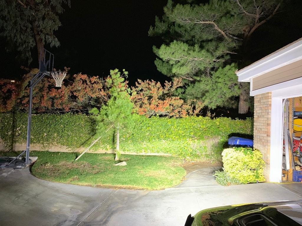

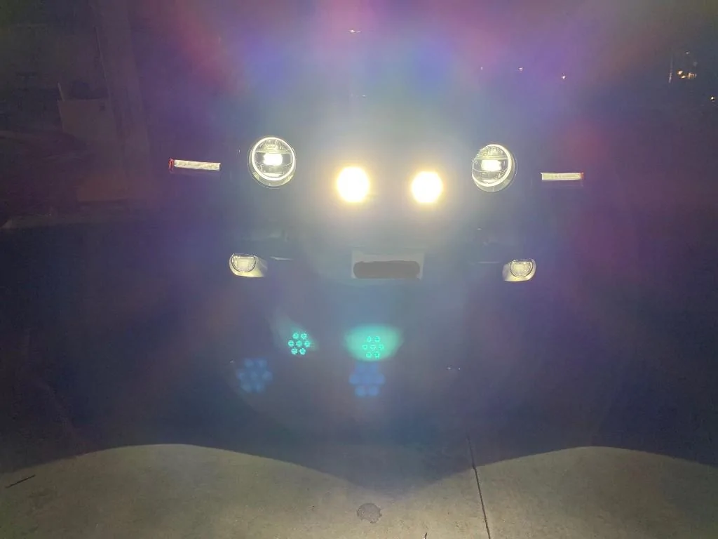

Those are bright
Color is also very nice -- maybe around 5000K... It Matches the color of the headlights perfectly, maybe just a tad warmer color on the off-road lights. I really like the fact that the headlights and off-road lights are around the same 5000k to 5500K in the light spectrum. The colors on the trees show very well.

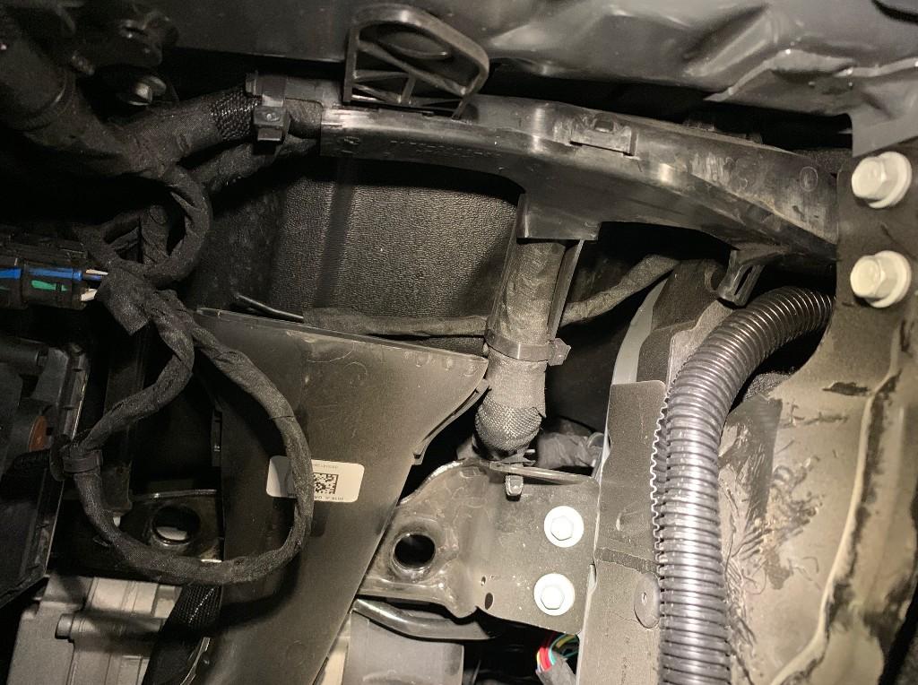

Dang , Jeep made you work for those aux switch wires!

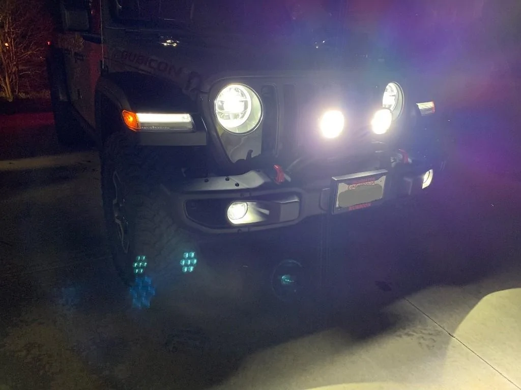

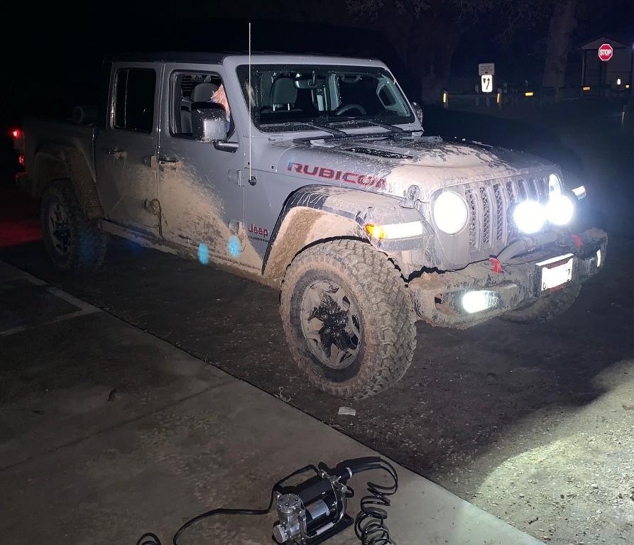

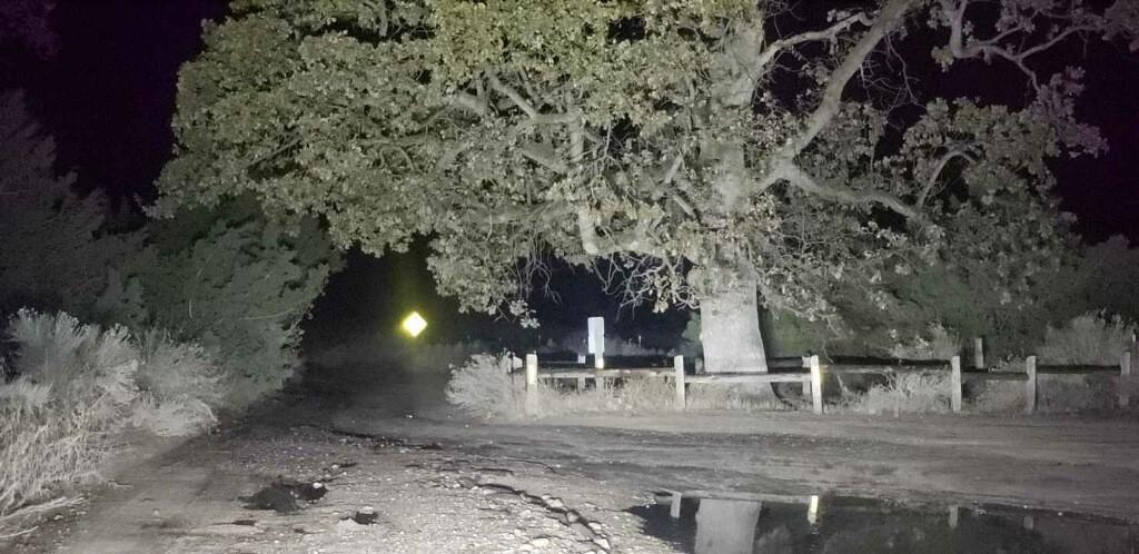

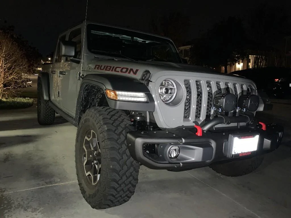

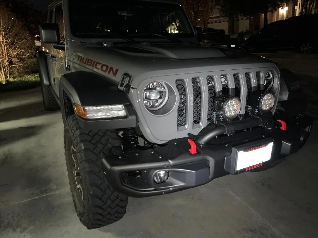

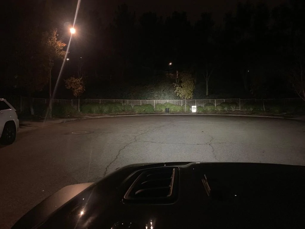

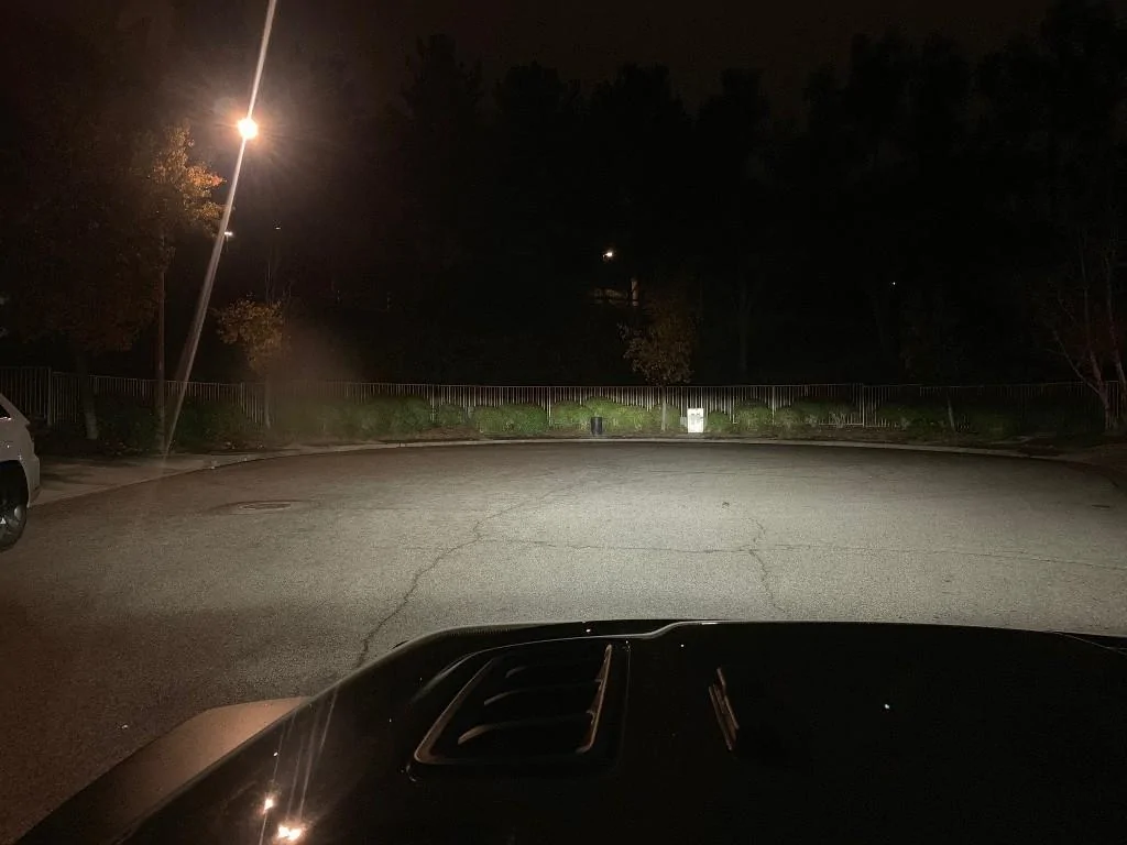

Here are some pics from Night time Mud wheeling at Hungry Valley SVRA
Jeep Gladiator Help, cannot find aux switch wiring under hood xsdPuT
LED High Beams on, off road lights off
Jeep Gladiator Help, cannot find aux switch wiring under hood fPfASo
LED High Beams on, and off-road lights on
Jeep Gladiator Help, cannot find aux switch wiring under hood RTzojn

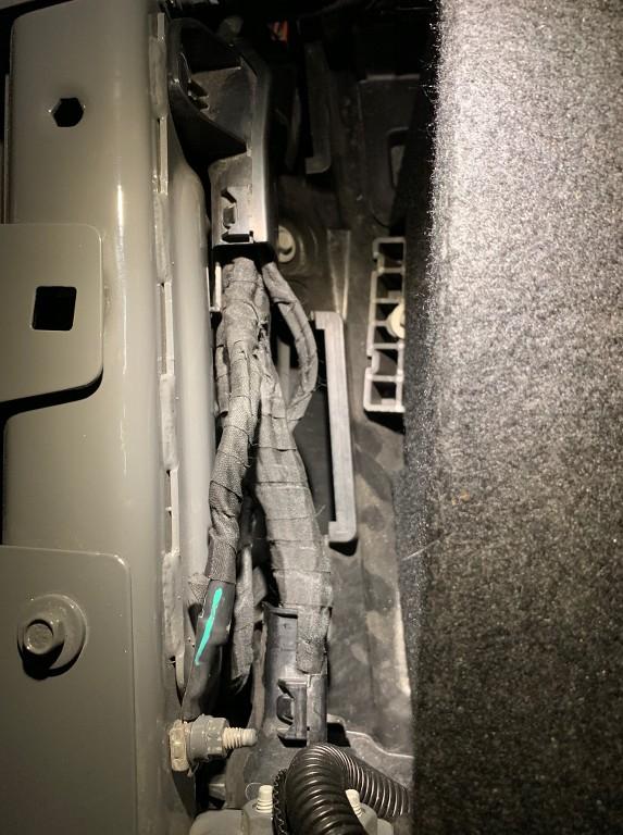

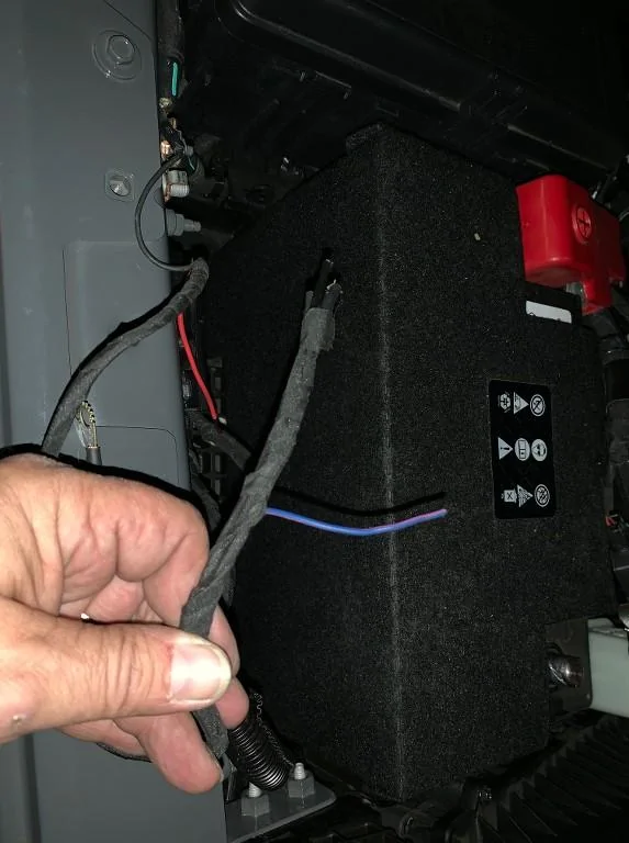

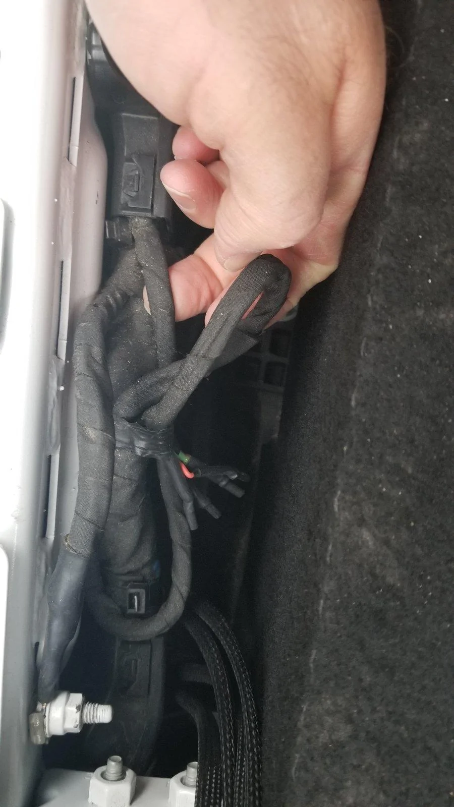

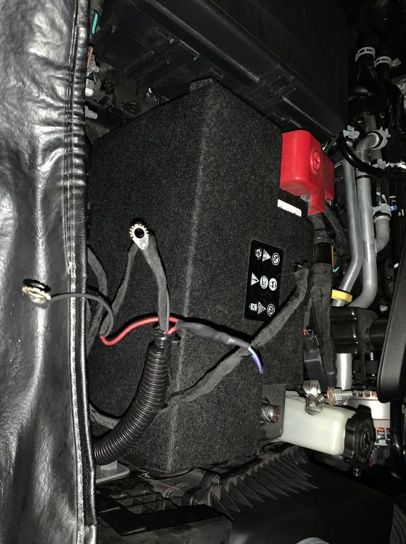

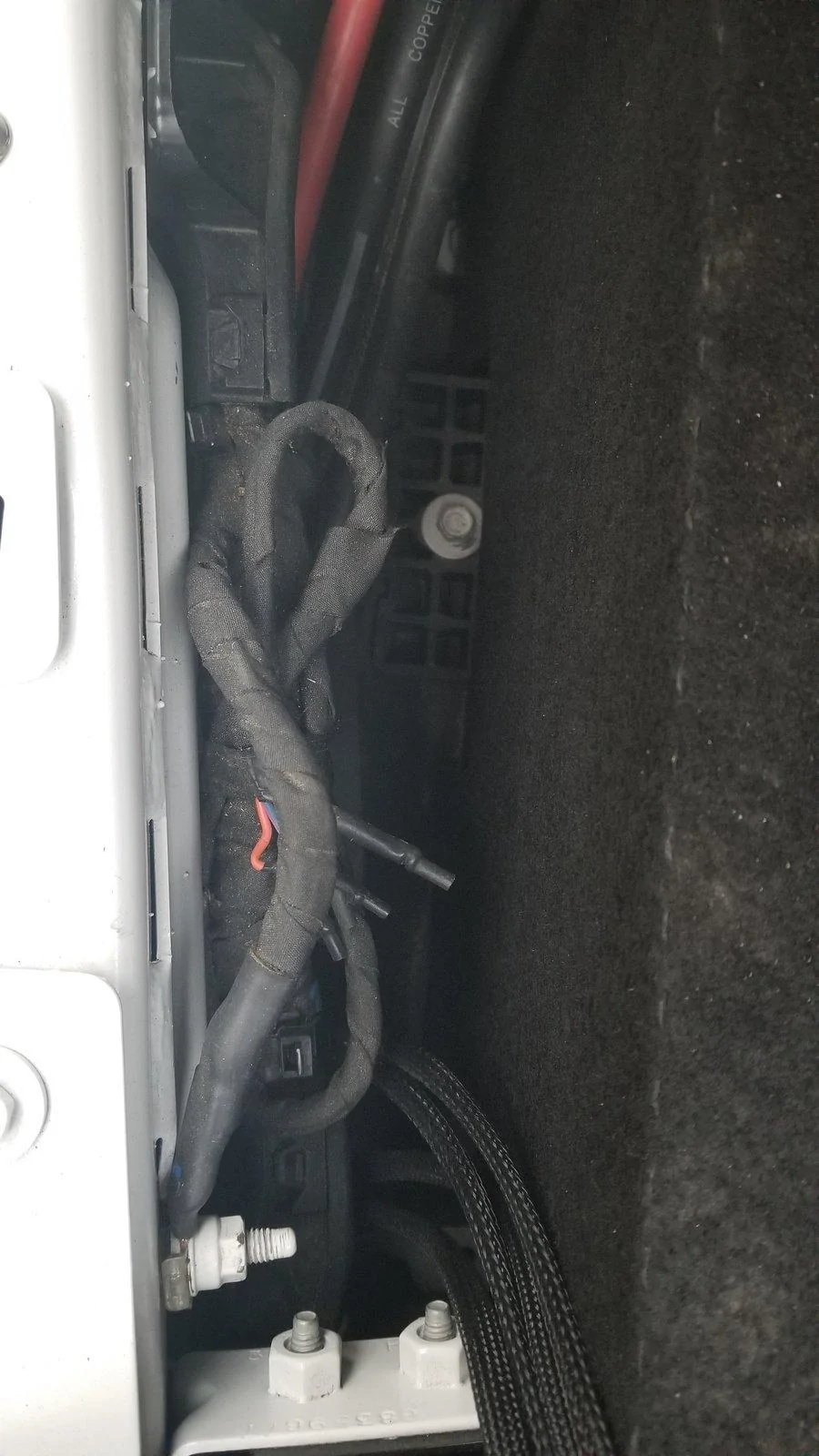

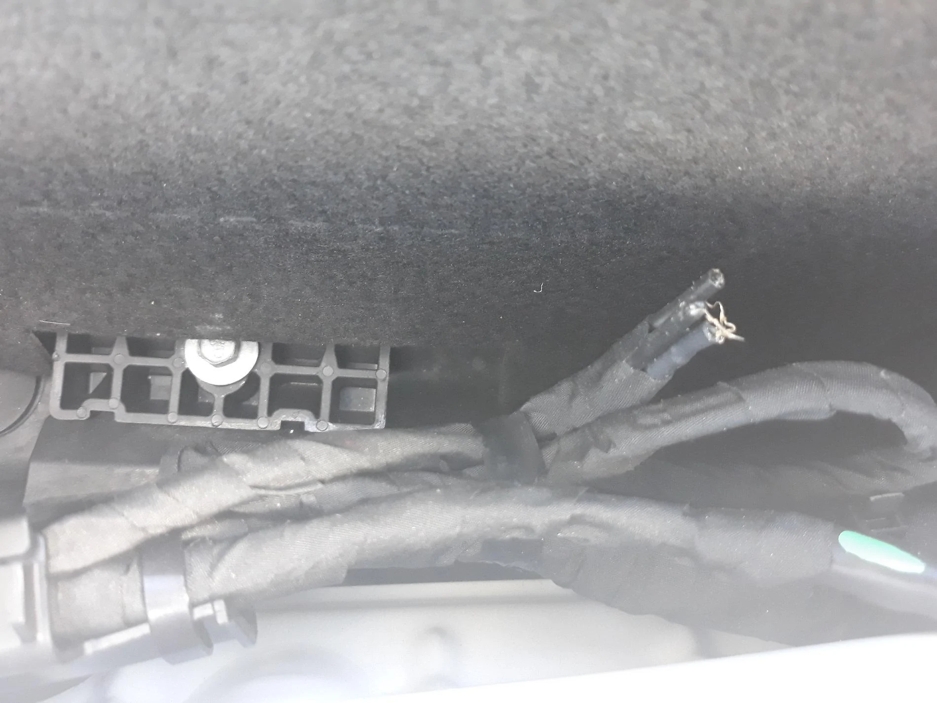

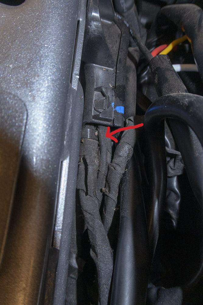

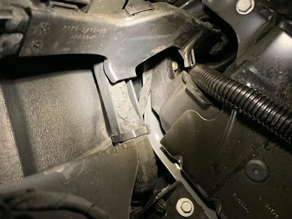

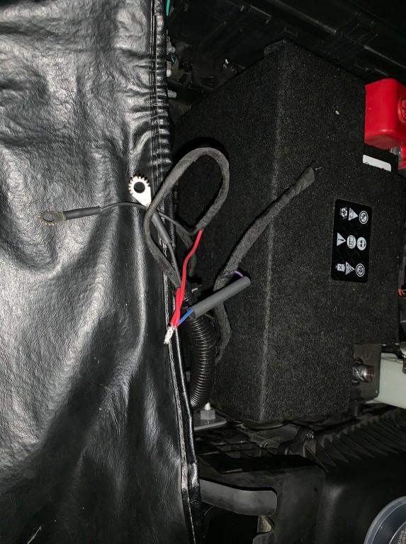

I am having the same trouble location my wires. Glad I came across your post, Having studied your pictures I know where to look now. Thanks for posting the follow-up pics showing what you had to do. Guess someone at the factory could give a hoot about those aux wires.
hjdca
hjdca
Oct 27, 2019
1,733
2,495
Southern California Mountains

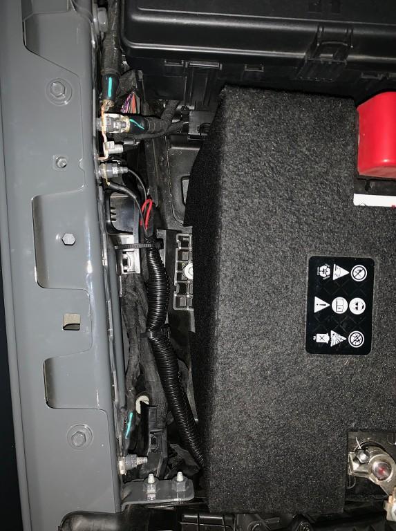

lol, glad it helped. If you take off your airbox, you will probably see the wires under the air box supports. Hopefully, yours will not be jammed up by the 10 mm battery tray bolt like mine was.

Bumping this because I just had the exact same issue of the Aux wires being trapped underneath the battery tray, in my case. Had to remove the airbox/battery and loosen up the entire battery box to get the wires out.

Well, now I know where mine are hiding.
