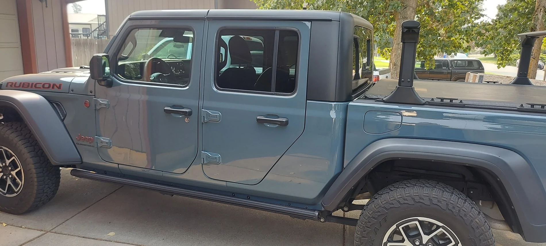

Can the aux switches be used to switch pwr as well as ground. But also circuit interrupt so when in the woods and I open the door electric steps don't deploy
