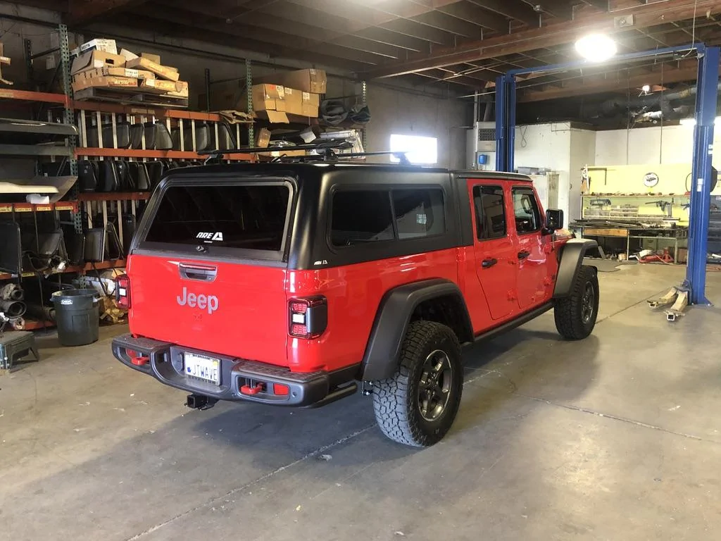

I have a ruby 2020 manual transmission Gladiator with ARE cap. Love it... but I need to sell it for an automatic (long story, won't bore you).
I have aux switches on my MT Glad - never used them. What are they used for (newbie here)?
I don't plan to off road, have lights, a winch, etc... I do plan to pull a vintage trailer.
Thanks!
