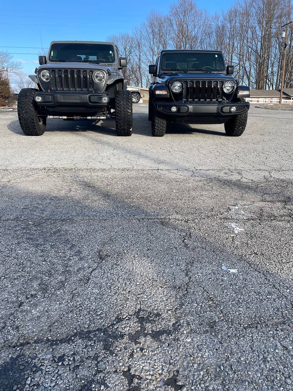

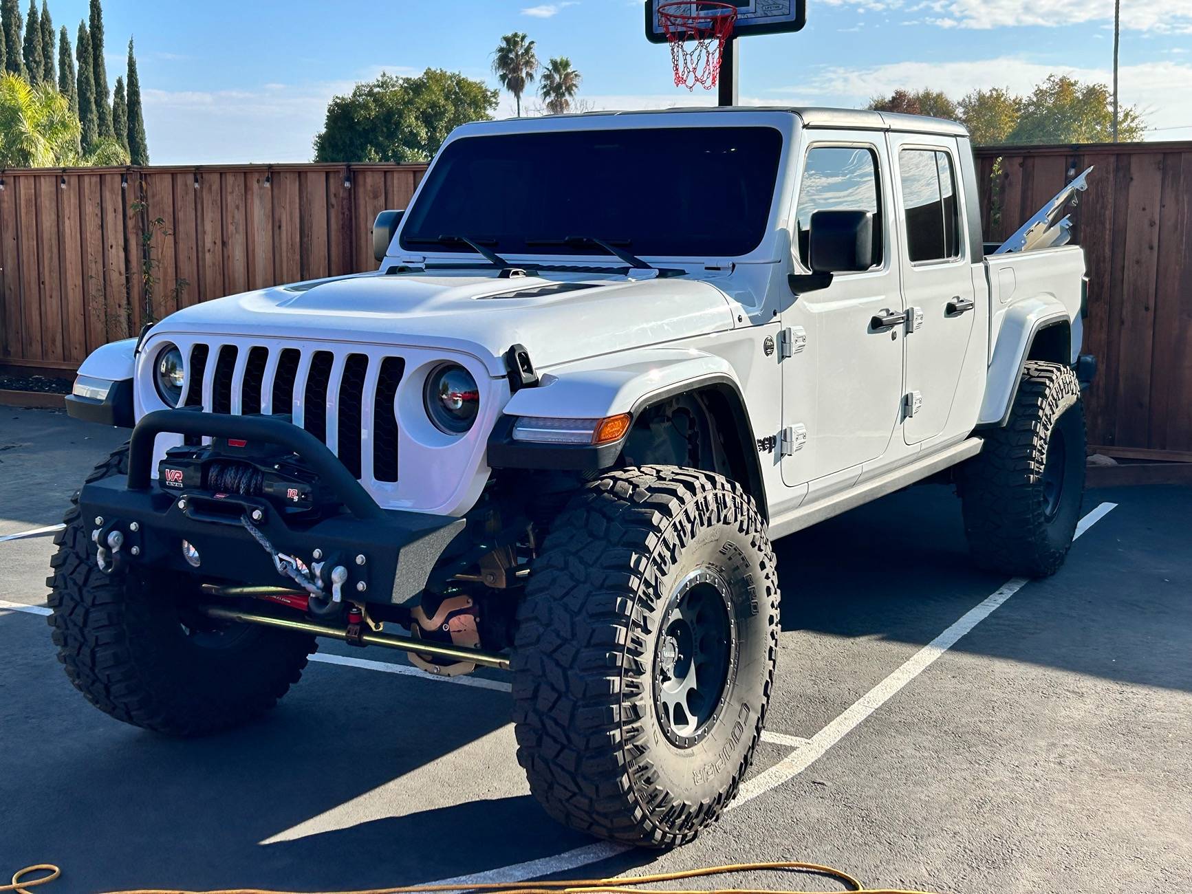

What's with the double stabilizer setup on that front axle OP? If you're wheeling it to need 40's you might want to consider dumping that setup for a relocated single pass through stabilizer. Or just get 42's!
Not really sure. Brian Motorsports built it that way and we bought it right after the build.
It's currently on 37s
