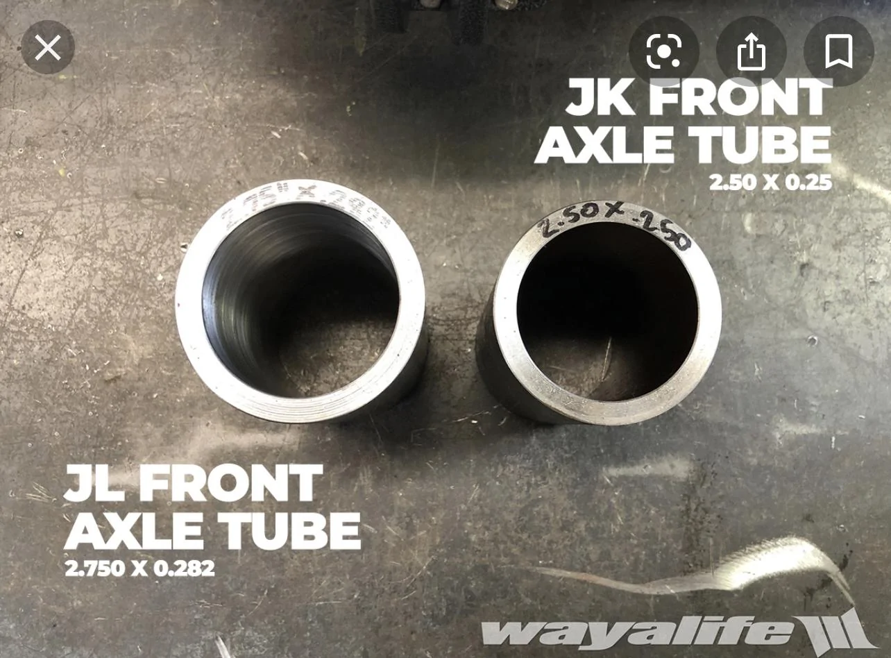

I’m guessing
JL Sport/Sahara = 2.75” wide & .213 Thick walls
JL Rubicon = 2.75” wide, .282 thick
JT Sport, Overland = 2.75” wide & .282 thick
JT Max Tow, Mojave, Rubi = 2.75” Wide & .394 thick
Dynatrac Pro Rock 44 = 3.125 wide & .500 thick
Jeep Gladiator Mojave axle vs Rubicon axle 1D9543BD-0A35-4634-A6B6-41D405EE7894
Jeep Gladiator Mojave axle vs Rubicon axle 6AF0FA5C-7CC9-40A4-8A60-C37BA5E9FF0C

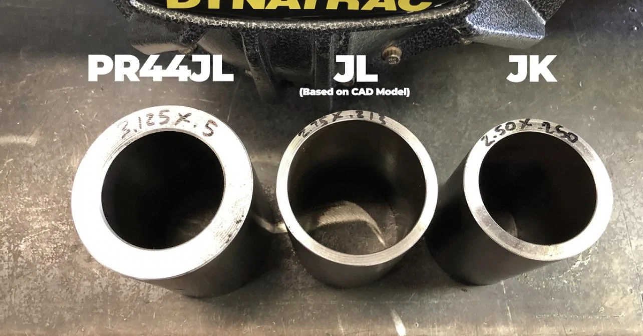

ProperMotionPowderCoat
Uriel
Feb 23, 2020
29
67
Anaheim
Gladiator Max Tow
I’m guessing
Hmmm
Jeep Gladiator Mojave axle vs Rubicon axle 1F3347BF-4C7A-406A-B3D6-92FBD26EE2DE
Jeep Gladiator Mojave axle vs Rubicon axle BC07F44B-C04F-4EE1-B425-3F252EF8DE4C

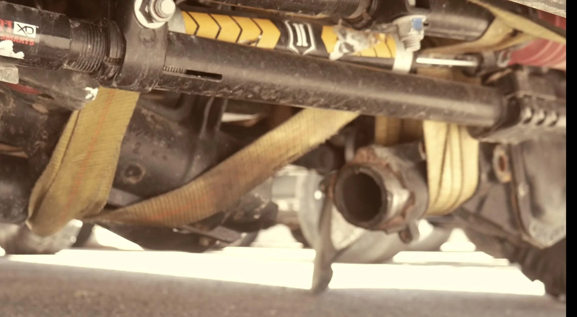

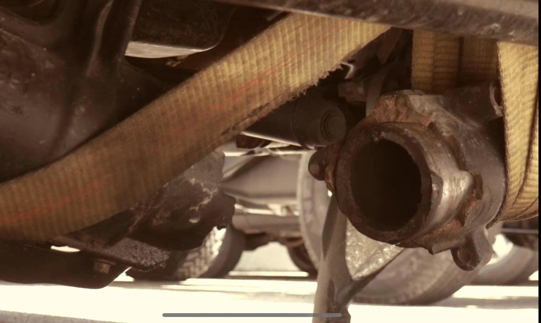

00Mutt
Jul 3, 2024
81
134
De Pere
2021 Jeep Gladiator Rubicon
Mechanical Designer
I'm no mechanic, but I think your tow straps were not tight enough. From my experience, using duct tape and bailing wire prevents things... I might be wrong though.
