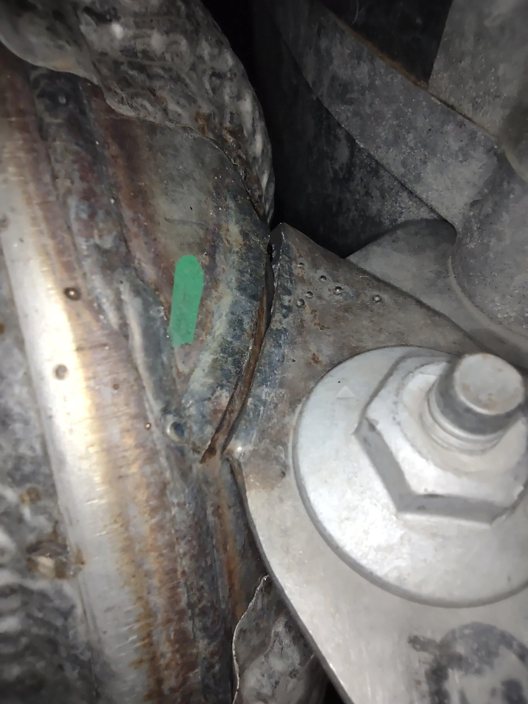

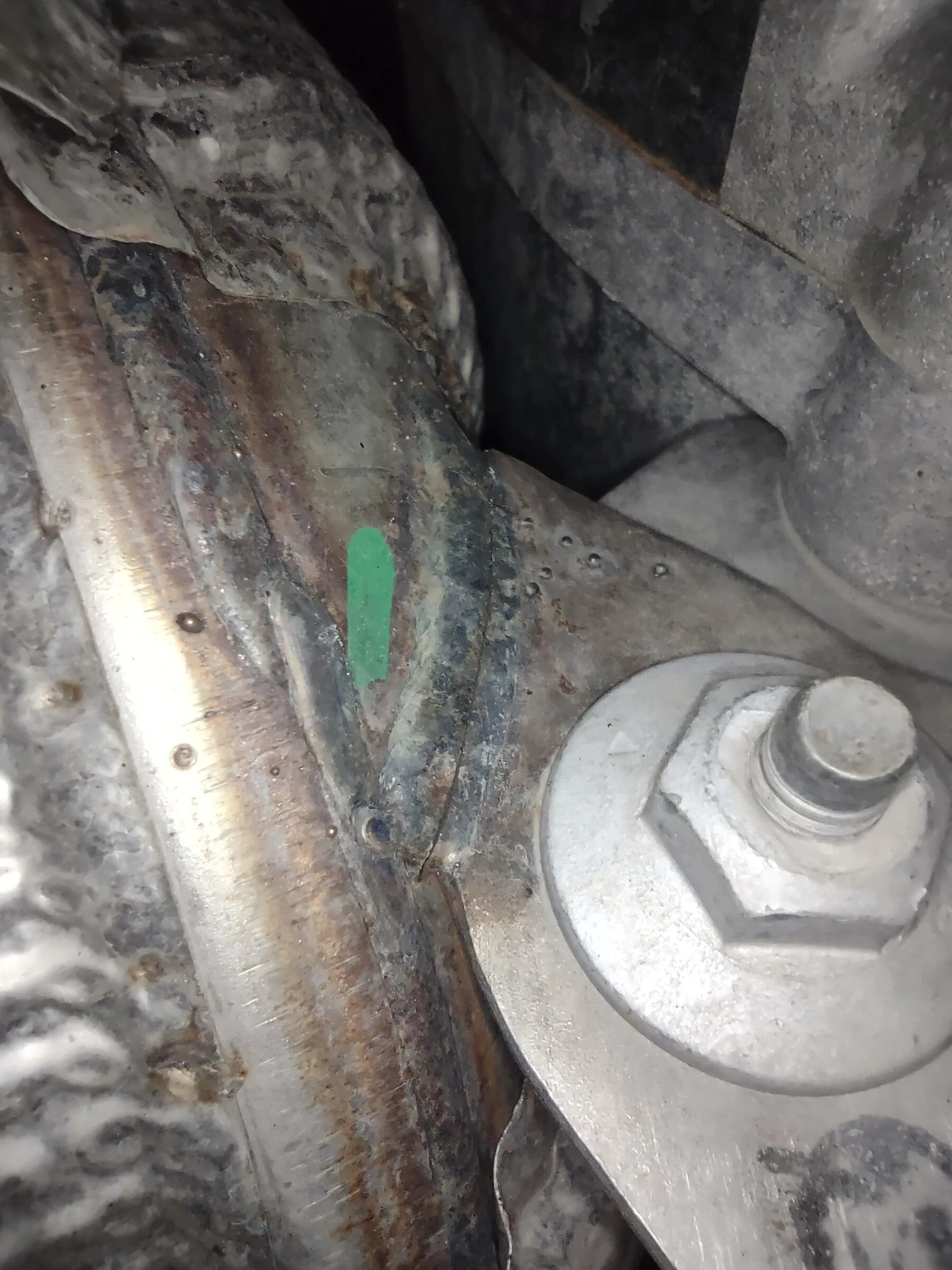

Man, I really like this little truck, but I'm getting damn tired of these trips. The start/stop that most could live without has stopped working again, it's a new truck, so it needs to function.
Now I'm hearing a rattle from engine area that turns out to be a snapped weld on the catalytic converter bracket. I could tig weld or two bolts and the remainder of the bracket is off, seems to have plenty of support anyway.
The rap sheet is going to be so long, even the Jeep dealership will not want to trade.
Jeep Gladiator Back to the shop I go IMG_20220502_175540276
Jeep Gladiator Back to the shop I go IMG_20220502_175546067

Yeah, looking at the weld and the way it separated, I call dissimilar metals, wrong filler rod and not enough heat.
With the angle of the picture, it appears there is no penetration on the tab side whatsoever. The crack in the weld follows the edge of the tab perfectly. Any welder worth his salt would put a bevel on the end of the tab before welding. Of course they probably don't use weld symbols or a welding engineer.....
