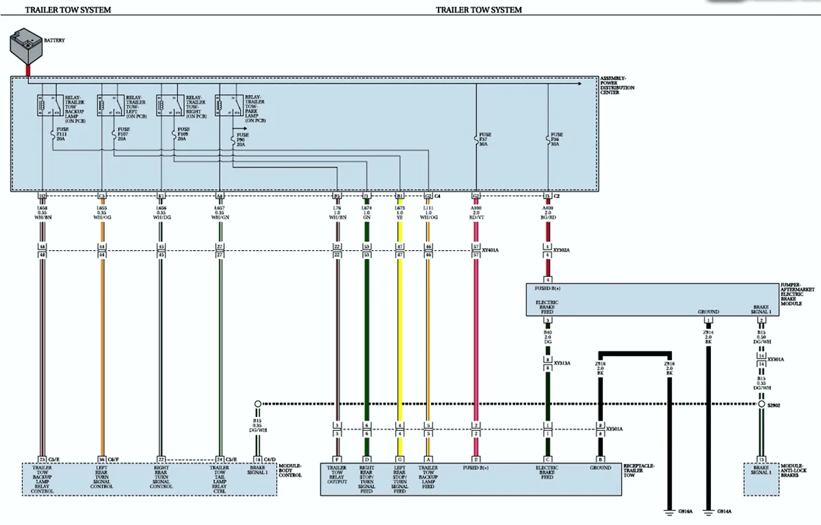

I have a Battery and a trailer tow receptor question.
The fuse #37- 30a circuit connects directly to pin E+ on the Trailer Tow Receptacle. I have been using this pin and Pin B-Ground to power my Lady-Wifes Scooter lift, which seems to work satisfactorily.
Since Pin E+ along Pin B-Ground is connected directly to the battery without a brake, may I use it to charge the batteries with a battery maintainer?
I ask this because when my 2022 Gladiator with less than 10,000 miles on it sits for more than 6-7 days, it will not start, and I have to use a Jump-pack. I keep a jump-pack in all of my vehicles for emergencies.
Yes.

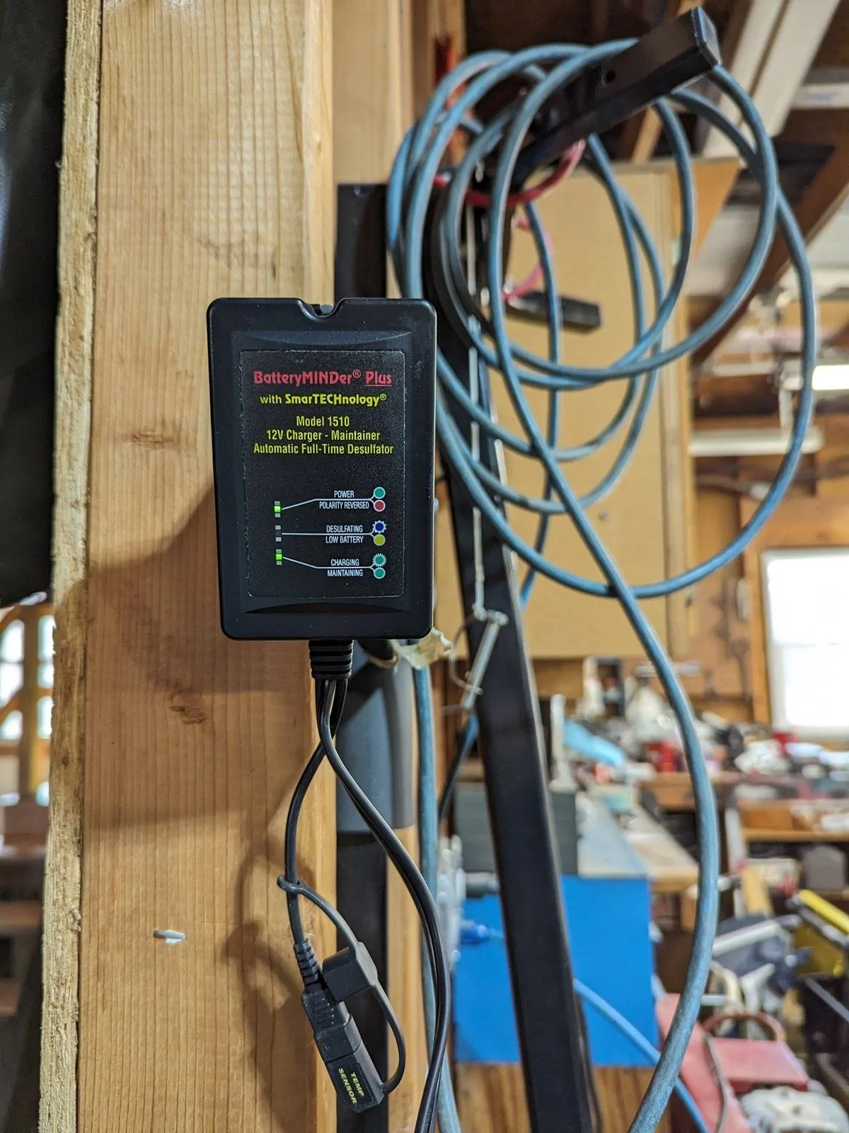

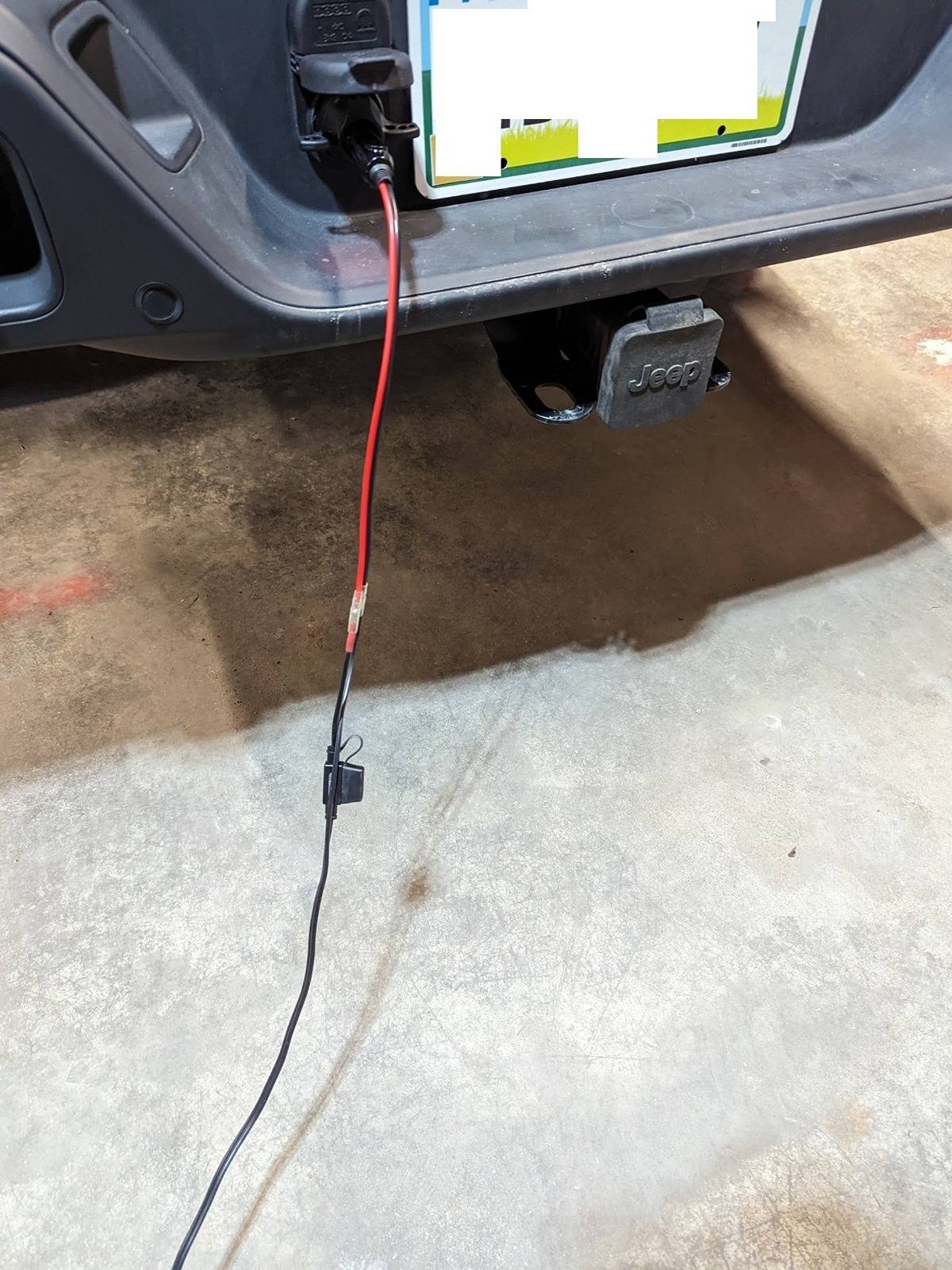

I do.
I used a trailer connector to 12 volt outlet converter, then plug a 12v plug into that so if I forget and drive away, the plug will pull out of the 12v outlet converter plugged into the trailer connector.
but you don't have to do it that way.
Jeep Gladiator Battery and a trailer tow receptor question. PXL_20240301_205908666
Jeep Gladiator Battery and a trailer tow receptor question. PXL_20240301_205913426

Thanks, Bill; this looks good and works well.....Mac
