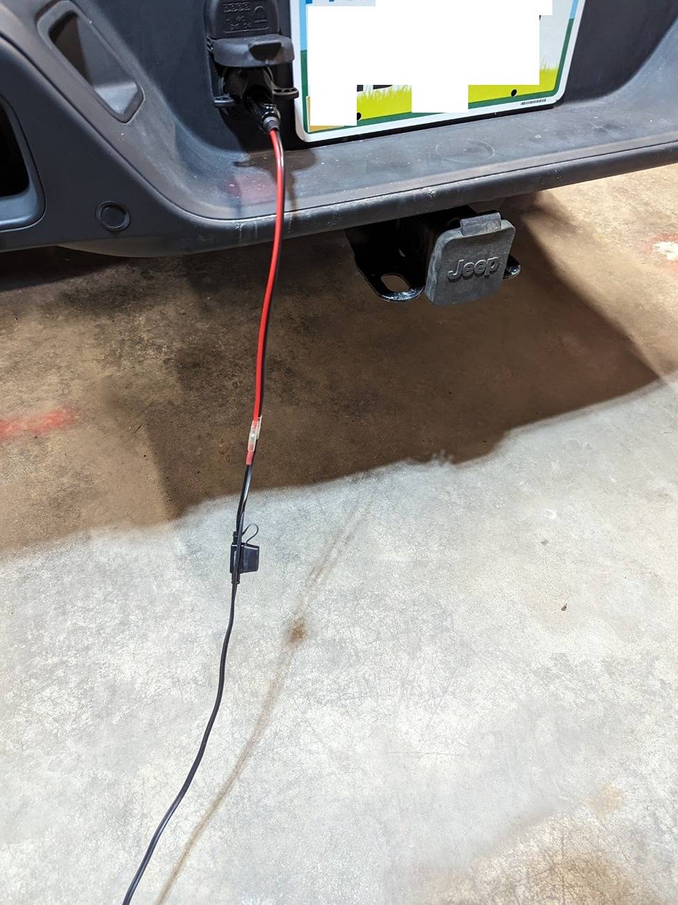

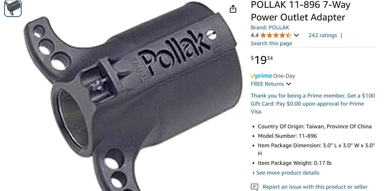

did a decent amount of research and shopping around, can anyone offer an opinion on my plans for battery maintainer/charger setup i'm considering. my thinking is to get these 3 items, and hookup the noco charger via the 7pin trailer plug. before i burn my garage down, is this going to work? goal is basically to top-up/maintain/desulfate etc the factory batteries, as it seems just daily driving approx 14mi to work, and 14mi back, isn't enough as they charge slow and have high parasitic draw:

I think your charging idea is fine. But also think 25 miles a day driving (which you seem to do) should be enough to keep your batt charged.

Yea makes sense. I'm only doing 14mi every 12 hours really.
Really odd though, the issue i had and what got me to the path of getting a charger, is ess failing to start the engine at a stoplight near the tail end of a road trip, followed by "service ess system" warning. It was at least 150 miles of continuous driving at that point.
I'll get this setup and see where it gets me thanks for the input
