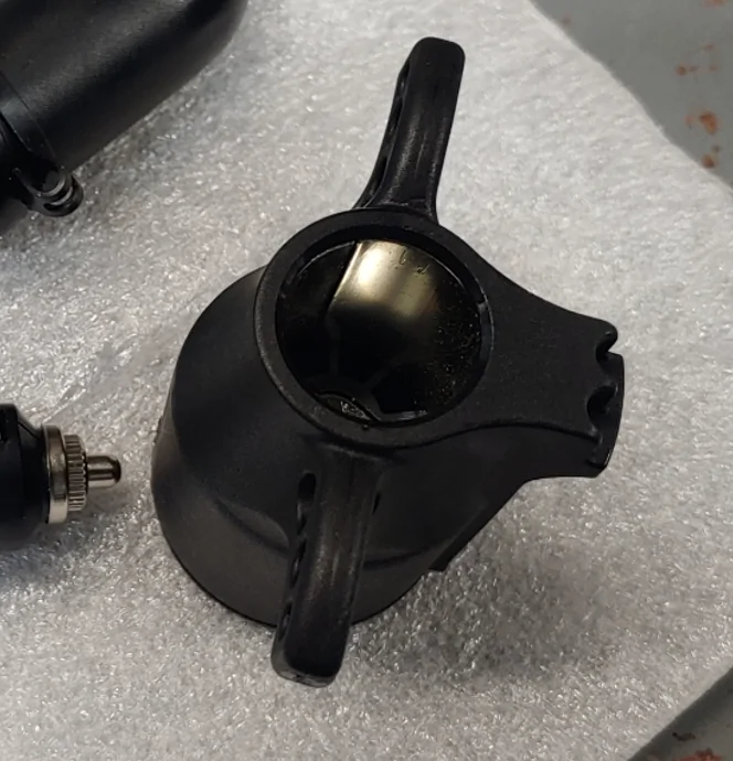

Reviving this thread: @ShadowsPapa can you please share a link for the 7-pin connector/pigtail that you have connected to your battery minder?
I used this -
Jeep Gladiator Battery charger, maintainer and propper use 1759276116464-zh
Jeep Gladiator Battery charger, maintainer and propper use 1759276245494-p9
And a lighter adapter.
That way if I forget, the lighter plug should just pull out of the part above, while that adapter above stays in the trailer connector.
