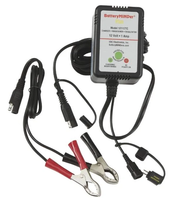

👉 Second on ShadowsPapa recommendation for the USA based BatteryMinder charger maintainer (5 year mgf/defect warranty) for lead acid batteries.
ALL [as in every-single-vehicle] including '17 JKUR Recon, '24 JTRX, and '73 CJ-5 (and Diesel RVs/ tractors/ gas & diesel vehicles/ boat/ motorcycles/ ATVs/ gas golf cart/ etc.) in our garage or enclosed shop are ALL connected to Battery Minder Plus trickle charger/maintainers (via quick connect/release two prong SAE connecters) 24/7/365 when not operating.
We have used the Battery Minder Plus 1A Model# 12117TC for several decades, and it is reliable our preferred product. The only one that "failed," was one that was we accidentally ran over - not a product fault...
👉 Our experience is our lead acid batteries last at least 2x 3x longer than folks that park their vehicles/ equipment out in the heat and cold, w/o maintainer/desulfators. Heat and cold, along with deep discharges and sulfation, reduces starting battery life).
If you're in a drive-in, back out, parking configuration, should you accidently forget to disconnect the 12v DC charger/maintainer --- an in grill/hood edge exposed SAE connector will self-disconnect when tensioned (when you back out).
👉 The unique feature of the Battery Minder Plus is it uses a high frequency desulfation pulse technology derived from WWII aircraft battery chargers, that extended the life of those batteries through both charge maintenance and desulfation functions. So recommend looking for this high frequency pulse desulfation feature/technology in whatever brand charger/maintainer you chose to purchase and use.
Tip: the reduced price Battery Minder Plus Model# 12117TC is specifically is sold only through NorthernTool.com, storefront or online. Other newer/fancier Battery Minder models are widely available at both Northern Tool and other vendors. The Model# 12117TC is regularly priced at $49.99, but is often on sale for $29.99 (so WAIT for the sales). [Note: other than being customer/users, we have no affiliation with, and receive no compensation from Battery Minder/VDC Electronics, Huntington NY]

Lost1Wing: The Battery Minder Plus Model# 12117TC does have a port for a temp compensation sensor, however we've never used/needed that function as our temps are moderate all year...
Manual says "Temperature Compensation Range 14°F - 122°F (-10°C - 50°C)
In float and maintenance stages the minimum voltage will be 13.0V ±0.15
Link to manual https://www.batteryminders.com/content/manuals/2024/702-000510-01-R VDC 12117TC-MANUAL-20190228.pdf
