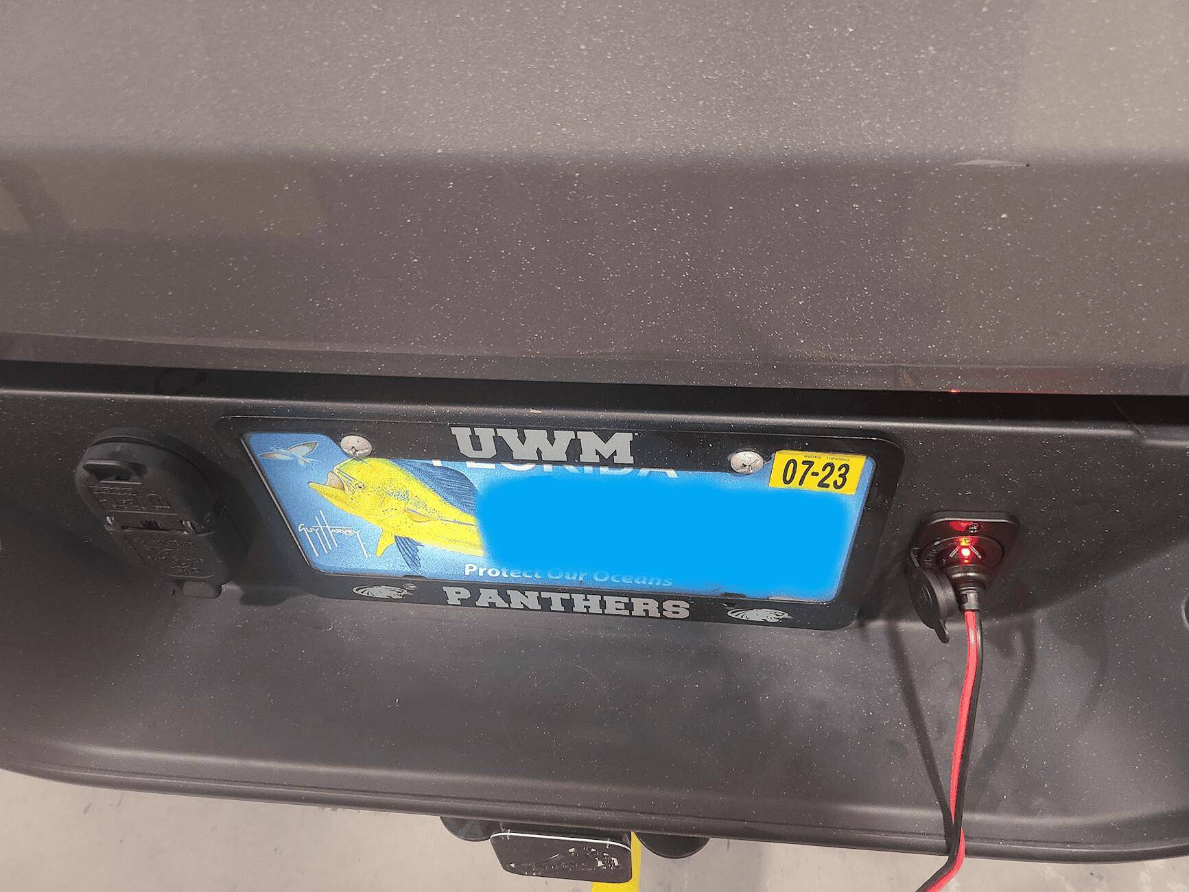

I bought the adapters on Amazon. One converts the 7 pin to a 12v outlet like a cigarette lighter outlet, the other plugs into that and has two wires which I connected to the charger via bullet type terminals.
The only thing I worry about is forgetting it's plugged in back there! So I stick a piece of curled cardboard in the door handle as a reminder to walk back there and disconnect.
I did forget the first time - but nothing bad happened as the lighter plug came out of the socket adapter! It simply leaves the power adapter (bottom pic) in the truck, no biggy.
I use the adapter for other stuff anyway, and I needed the male plug for another project so for me it wasn't an expensive setup.
I sometimes go on longer drives or more frequent drives, but still do plug things in fairly frequently. It might be one reason I've had decent luck with batteries over-all.
So the circuit remains 'live' from the trailer plugs when the vehicle is off?
Yes, on Gladiator. It's live 24/7.
Doesn't seem to be live on a JLU 4xe, however. I'm unsure as to why, but tried it with my wife's 4xe and got nothing. But it was really cold out and I didn't really check - maybe I didn't get a good connection so will check again.
